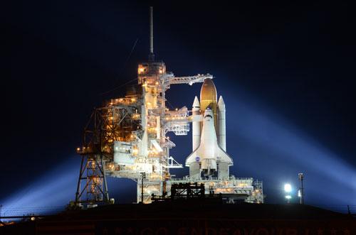

Midnight reveal for Endeavourposted April 29, 2011 5:27 a.m. CDT
Space shuttle Endeavour was revealed on its launch pad early on Friday morning after a five hour delay as NASA waited for severe thunderstorms to move off-shore.
Lightning in the vicinity of Kennedy Space Center's Launch Pad 39A left Endeavour unscathed but prevented technicians from retracting the pad's rotating service structure at 7:00 p.m. EDT Thursday as planned. NASA safety rules required that its workers wait for the storms to pass, pushing the start of the retraction to just before midnight Friday.
Teams began moving the structure away from Endeavour at 11:58 p.m. It was fully retracted at at 12:32 a.m.
The rotating service structure enveloped the shuttle as it was readied for launch, protecting the orbiter and providing access to its payload bay.
The retraction was required before Endeavour's external tank could begin being fueled for flight, scheduled to begin at 6:22 a.m.
Space shuttle Endeavour is bathed in Xenon light on Launch Pad 39A. Credit: collectSPACE

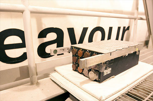

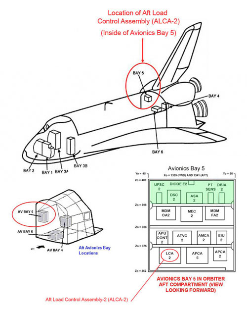

Endeavour launch delayed until at least May 8posted May 1, 2011 2:53 p.m. CDT
Shuttle techs will spend the next several days removing and replacing a faulty fuse box in Endeavour's aft section and then will perform a lengthy retest of its replacement in their effort to bring back online the failed fuel line heaters that scrubbed Friday's launch attempt.
"The bottom line is the failure we have appears to be a power problem, which is in the LCA, the load control assembly, box which is basically a box of switches we use to control power feeds. That basically means the power isn't getting out to the heaters that weren't working on launch day," said mission management team chair Mike Moses on Sunday. "We need to go in and change out that box."
Credit: NASA/Kim Shiflett
Above: A technician crouches in Endeavour's aft section, where teams are preparing to remove and replace the aft load control assembly-2.
The LCA (or specifically, Aft Load Control Assembly-2, ALCA-2) controls more than just the heaters for Endeavour's auxiliary power units but also a long list of other orbiter systems, including the shuttle's main engines, its orbital maneuvering system and life support system. As a result, once replaced, the box and all its connections needs to be retested, a process that will tentatively take an additional two full days.
"Any time you break a connection to a box like this, you essentially invalidate all the testing we've done up to that point," explained shuttle launch director Mike Leinbach. "You could take the tact that saying 'Well, all you are doing is replacing the box, everything downstream of that box should be fine.' Well that's true, but our requirements and the way we do business is that whenever we break a connection, we go back and retest it. That's just the prudent thing to do."
Additionally, they won't know what exactly was wrong with the faulty box until it is removed and inspected, adding to the present uncertainty when Endeavour can launch.

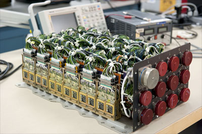

Forensic testing continues on faulty power boxposted May 5, 2011 4:53 p.m. CDT
Technicians at the NASA Shuttle Logistic Depot in Cape Canaveral, Fla., continued testing Thursday a faulty power distribution box, called an Aft Load Control Assembly 2 (ALCA-2). It was removed on Tuesday morning from the aft compartment of space shuttle Endeavour on Pad 39A.
The tests are to try to determine what caused the power box to fail. Initial testing from Wednesday shows a driver (circuit) inside the ALCA shorted out. The ALCA-2 feeds power to heaters on the fuel line for Endeavour's Auxiliary Power Unit, No. 1 (APU-1). Initially, when the shorted out driver was replaced, the ALCA-2 appeared to work as designed.
The faulty Aft Load Control Assembly-2, uncovered for testing. Credit: NASA
Technicians are performing additional failure analysis on the driver in an attempt to confirm whether the short experienced by the system came from inside or outside the ALCA-2. Depending on the results, additional testing of the box may be required.
On Pad 39A, a new power box was installed into Endeavour Wednesday morning, and re-testing of the system is proceeding before Endeavour's next launch attempt is scheduled. Currently, the "no earlier than" launch date remains May 10.
The APU-1 fuel line heaters did not work April 29, prompting the scrub of Endeavour's first launch attempt for the STS-134 mission.
The faulty Aft Load Control Assembly-2, after being removed from Endeavour. Credit: NASA

Shuttle engineers have been unable as of yet to identify the root cause of the issue that scrubbed Endeavour's first launch attempt on April 29, but are confident that the workarounds they have put in place since then will correct for the problem.
"The failure on launch day was a failure of having power supplied to the heaters. The cause of that failure to supply power we're still not exactly sure of, and so we went through what we call our 'unexplained anomaly troubleshooting,' which basically [asks] when you do not have an exact root cause, what are you going to do next?" explained Moses.
A short in a heater circuit associated with Endeavour's hydraulic system resulted in the launch being postponed. Technicians determined the most likely failure was inside a switchbox in the shuttle's aft compartment and associated electrical wiring connecting the switchbox to the heaters. The heater circuits prevent freezing of the fuel lines providing hydraulic power to steer the vehicle during ascent and entry.
The faulty switchbox was replaced on May 4. Since Friday, technicians have installed and tested new wiring bypassing suspect electrical wiring and have confirmed that the heater system is working properly.
"We did various checks along the point but it culminated last night in our full up retest of this [hydraulic] system, where we basically operated the heaters on both an external power supply and then the new LCA-2 power supply, and we saw full functionality out of these five heaters as they were supposed to work. So we kind of end-to-end checked and wrung out the whole system," said Moses.
"Of all the components — the box, the power supply, the wiring to get you out to the heater, and then the heater itself — we have replaced everything except the heaters and we've wrung those out with at least five separate checks and full function afterward and now have extremely high confidence that the problem is no longer on the ship or in any of the electronics."
"We don't still exactly have root cause but we basically have really good comprehensive proof to show that we've managed to remove that failure," said Moses.

"We took our time to walk through the issue that caused the launch scrub last time, the APU-1 heater problem, to make sure we truly understood our resolution and our fix," said Moses.
Technicians determined the most likely failure was inside a switchbox in the shuttle's aft compartment and associated electrical wiring connecting the switchbox to the heaters. The heater circuits prevent freezing of the fuel lines providing hydraulic power to steer the shuttle during ascent and entry.
The faulty box was replaced and new wiring was installed bypassing the suspect electrical wiring. Testing confirmed that the heater system was working properly.
By testing the faulty box, engineers were able to locate the failure.
"The cause of that short actually occurred back in June, when we were in the orbiter processing facility doing some testing on the circuit. We either had come in contact with a connector on the thermostat that already had bare metal on it or the testing itself caused that inadvertent contact and created the bare metal short," explained Moses.
