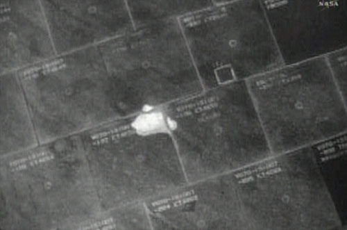

Crew takes focused look at damaged tileposted May 21, 2011 3:55 a.m. CDT
Endeavour's crew performed some early morning robotic calisthenics on Saturday, stretching both the International Space Station's and orbiter's arms to inspect a small gouge found on the space shuttle's heat shield tile-covered underbelly.
The "focused inspection" was expected to give mission managers on the ground the additional data needed to clear the damaged "area of interest" as safe for Endeavour to return through Earth's atmosphere at the end of its on-going 16-day, STS-134 final mission.
"There is nothing alarming here and we're really not concerned," NASA's chair of the shuttle mission management team LeRoy Cain said Friday. "This is one that we feel pretty confident we're going to be able to clear once we get some higher fidelity data."

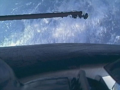

To perform the inspection and clear the surrounding station complex, the astronauts needed to first use both the station's and shuttle's Canadian built robot arms to hand-off a 50-foot extension boom tipped with sensors and cameras flown on the shuttle for just such damage surveys.
Once grasped by the shuttle's own Canadarm, the boom was extended underneath Endeavour and positioned about seven feet from the 3.22 by 2.49 inch divot, which straddles two heat shield tiles located between the orbiter's right main landing gear door and an external tank feed line port.
The couple of hours required for the inspection was mostly consumed by the time needed to position the arms and boom; the actual scans of the damaged area, which began at 2:25 a.m. CDT and included five different angled-views, took about just a minute to perform each.
STS-134 pilot Greg H. Johnson oversaw the computer-controlled boom movements and data collection. Assisting him positioning the arms were mission specialists Mike Fincke, Andrew Feustel, and European Space Agency astronaut Roberto Vittori.
The images collected by the inspection were downlinked in real time to Mission Control in Houston, Texas, where imagery experts will analyze the data for how deep the gouge is and what effects it might have to the integrity of the orbiter's thermal protection when heated during reentry.
The small gouge was one of seven debris-damaged areas first revealed earlier in the week through photographs taken as Endeavour approached the space station to dock. Four of the dings were considered very minor and were quickly cleared as safe by engineers. Of the remaining three, two were able to be analyzed using the available imagery. The third was "kind of fuzzy" in the available photos, leading managers to order today's focused inspection.

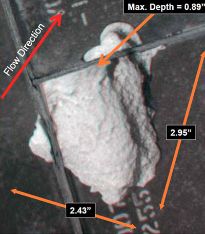

Shuttle Endeavour's heat shield has been deemed safe for the ship's last landing thanks to images taken by its astronauts and sent down for study on Saturday.
"We are essentially clearing the vehicle for reentry at this point," NASA's shuttle mission management team chair LeRoy Cain said.
Earlier this week, engineers and mission managers were able to clear six of the seven areas of minor debris damage they had found dotting the right-side of Endeavour's tile-covered underbelly.
"Fuzzy" photographs of the seventh gouge, which straddled two thermal protection system (TPS) tiles, couldn't be analyzed to the same degree so the shuttle's astronauts were tasked with using cameras and sensors mounted at the end of a robotic arm inspection boom to get a close-up look at the site early on Saturday morning.
By Saturday afternoon, engineers at the NASA Johnson Space Center in Houston, Texas had processed the newly-downlinked data, even creating a physical 3D model of the divot.
Focused inspection view of the heat shield tile damage cleared on Saturday.
"The analyses team went back and essentially what they did was verify how much of the tile was still in the cavity, because of course, it is more important what remains than it is what is gone," said Cain. "What we are interested in is protecting the structure underneath the tile."
The team found the damage was well within the margins of safety and so recommended that the shutlte was cleared to return to Earth. Endeavour, flying its 25th and final spaceflight, is scheduled to make its last landing from space on June 1, weather permitting.
"With that we've cleared the TPS," said Cain. "The vehicle is otherwise in great shape as well. It continues to perform outstanding."
