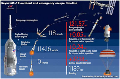

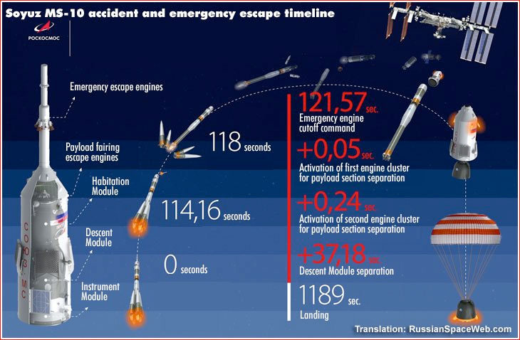

The Soyuz MS-10 launch failure occurred as a result of a stage separation sensor that was deformed during the rocket's assembly at the Baikonur Cosmodrome, the head of the emergency commission, Deputy Director of the Central Research Institute of Machine-Building (TsNIImash) Oleg Skorobogatov, said on Thursday (Nov. 1).
"The nozzle lid of the oxidizer tank in the block D did not open as a sensor of the stages' separation was deformed (a 6-degree bend) during the assembly of the 'package' at the Baikonur Cosmodrome, which was the cause of the off-nominal separation," Skorobogatov said.
According to the commission head, "this has been proven and confirmed documentarily that this occurred due to the faulty sensor and this could occur only during the assembly of the 'package' at the Baikonur Cosmodrome.'"
With the cause identified, the Soyuz MS-11 launch with Oleg Kononenko, Anne McClain and David Saint-Jacques has been targeted for approximately 6:31 a.m. EST (5:31 p.m. local time in Kazakhstan) on Dec. 3.
The space agency also released an infographic detailing the timeline of the launch, which Anatoly Zak of RussianSpaceWeb.com has translated:

From what I read on the final report as well as Spaceflight Now, why was this problem not detected during the final assembly of the rocket?
Also, there was a video being posted of the launch and I was wondering if it's the actual event; lastly, did the investigation also announced no fowl play (i.e. any kind of sabotage) was involved?
Posts: 42988
posted 11-01-2018 12:40 PM     Click Here to See the Profile for Robert Pearlman   Click Here to Email Robert Pearlman     Edit/Delete Message   Reply w/Quote
Specifics were not given during the press conference as to how the sensor was "deformed" or why it escaped detection.
The video is indeed of the Soyuz MS-10 launch through its failure.
