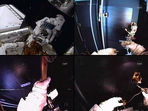

Flying off the handle
Mike "Mass" Massimino, assisted by Mike "Bueno" Good, set out to perform surgery in space, repairing Hubble's Space Telescope Imaging Spectrograph (STIS), which hasn't worked since 2004 due to power failures.
The repair calls for replacing an electronics card, a task complicated by the fact that it was never designed to be accessed in orbit.
To get to the card, a cover plate had to be removed, however there were several obstacles in its way. First, Massimino needed to remove a clamp and a handrail that were attached to the cover plate. Both of these required the use of special tools to catch the fasteners that held the pieces in place.
The clamp removal tool fit over its fasteners and caught them as they were released; the handrail tool was designed to do the same.
The clamp came off as expected. The handrail posed a problem: one of its four fasteners refused to come out.
"I don't know if we're going to be able to get it, it just looks really stripped," Massimino reported.
The more he tried to release the screw with his pistol grip power tool, the more Massimino eroded the specially designed bit. To try to get a better fit, flight controllers had him remove the capture tool and try the screw exposed.
"I don't know if we're going to be able to get in there again. It looks like its already galled up," Massimino described.
Mission Control then suggested he replace the bit on the power tool with a back-up.
"I'm not sure if the new bit... do we have a plan if the new bit doesn't work? Can we try it while keeping the handrail on or something?"
Massimino was right, the new bit had no effect, despite his pushing into the now stripped-screw as hard he could. With no way to fit the cover plate while the handrail was still in place, Massimino gathered some additional tools to try removing the brackets that held the rail.
Before attempting that, however the idea was suggested to remove all the handrail's fasteners (except for the stripped screw) and then have Massimino pull on the rail, essentially breaking off the bolt and rail out of the way.
"That sounds like a good idea. I'd be happy to try that," said Massimino.
NASA engineers at Goddard Space Flight Center, demonstrating the approach on a training model, found it would take 60 pounds of force to pull the handrail free.
"I think you've got that in you," said Drew Feustel from inside Atlantis.
"I can try," replied Massimino.
Removing the remaining good bolt and taping a capping plate and the stripped screw's opening so as to minimize debris, Massimino yanked hard on the rail.
"There we go, I got it," confirmed Massimino. "You can see the bolt is still in there."
With the rail clear, Massimino could move onto the next obstacle: the cover plate and its 111 screws.
Photo credit: NASA TV
