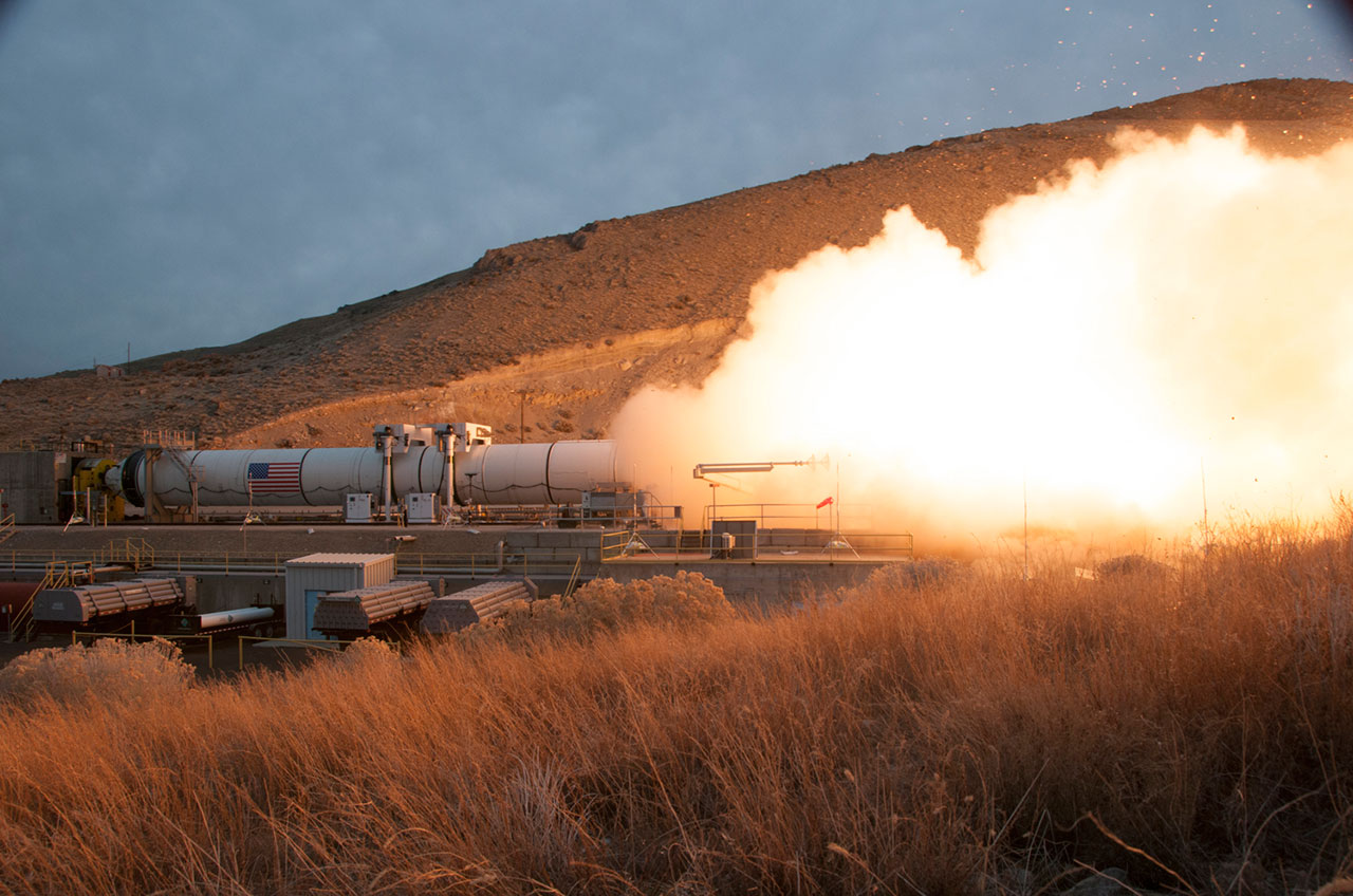

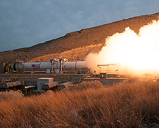

The world's largest solid rocket motor fires at Orbital ATK's Utah facility in a test for NASA's Space Launch System. (Orbital ATK)

— The world's largest solid rocket motor roared to life in Utah Wednesday (March 11), but instead of lifting off the ground, the massive booster, laying on its side, remained in place as data was collected to qualify its use on NASA's new heavy-lift launch vehicle.
Orbital ATK, Inc., the primary contractor building the twin side-mounted boosters for NASA's Space Launch System (SLS), conducted the test fire at its facility in Promontory, Utah. The motor ignited at 11:30 a.m. EST (1530 GMT) as scheduled and burned for the full two minutes.

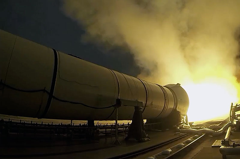

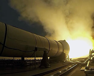

During the test fire, the motor burned 1,385,000 pounds (628,225 kilograms) of propellant, or about 5.5 tons per second. (NASA TV)
