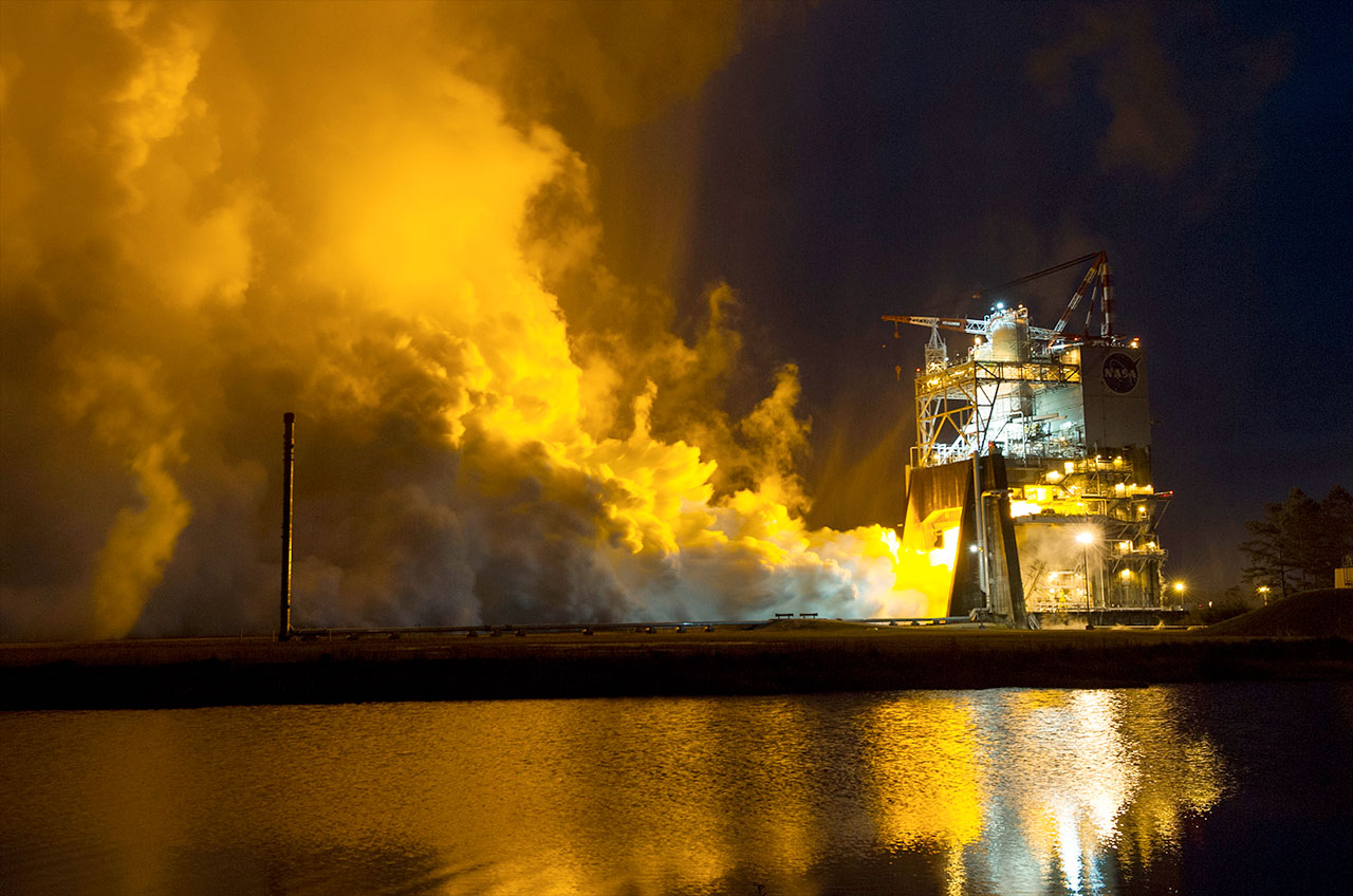

An RS-25 (formerly SSME) engine fires for a 500-second test Jan. 9, 2015 at NASA's Stennis Space Center in Mississippi. (NASA)

— For the first time in more than three-and-a-half years, a space shuttle main engine roared to life on Friday (Jan. 9) in support of NASA's new heavy-lift rocket.
The space shuttle main engine (SSME), now renamed the RS-25D, fired for 500 seconds atop the A-1 test stand at NASA's Stennis Space Center in Mississippi. The first fire of a former-SSME since the final shuttle launch in 2011, Friday's test was the first RS-25D hot fire since the end of shuttle engine testing in 2009.

Friday's test fire collected data on the engine's controller unit and inlet pressure conditions.
