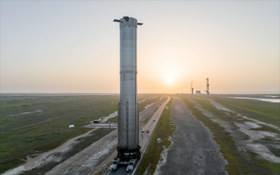

From SpaceX (via Twitter):
Starship Super Heavy Booster 9 transported to the orbital launch pad at Starbase for testing ahead of flight.

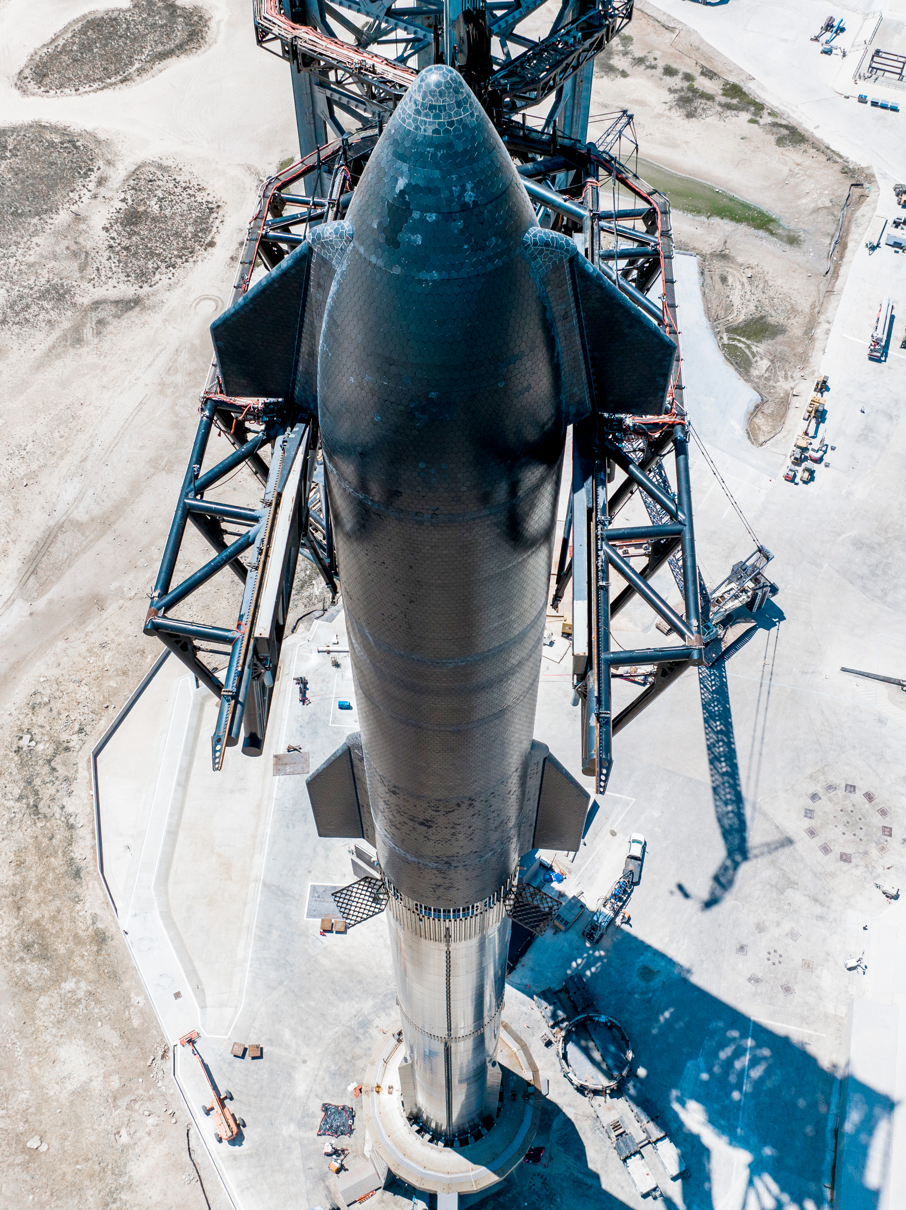

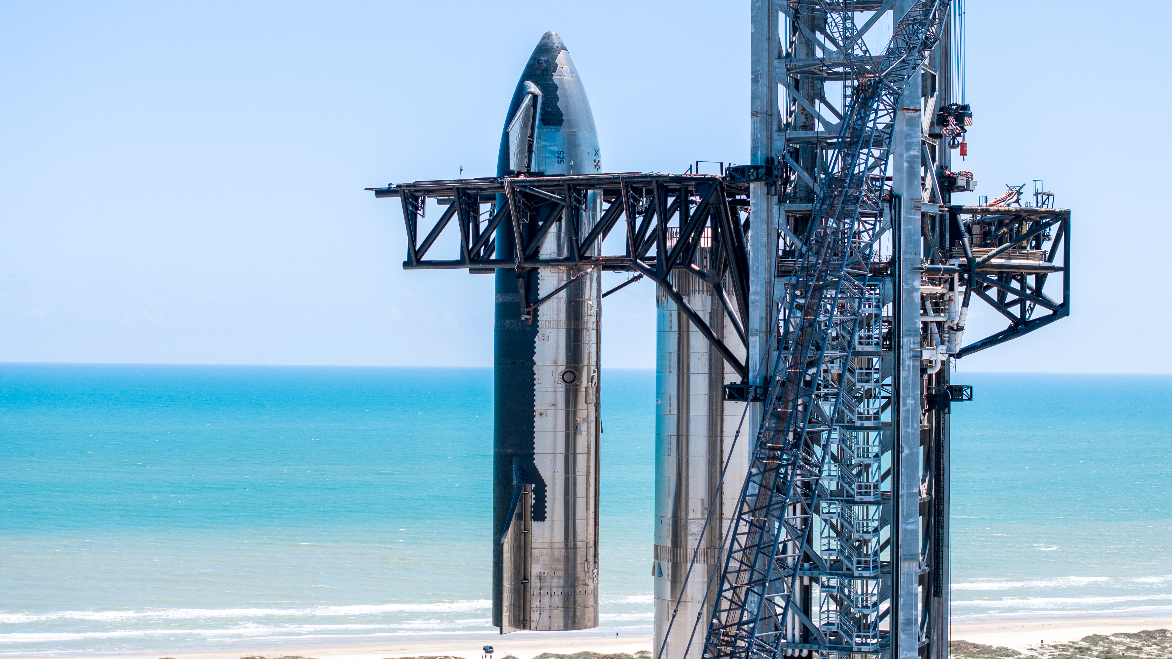

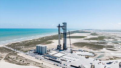

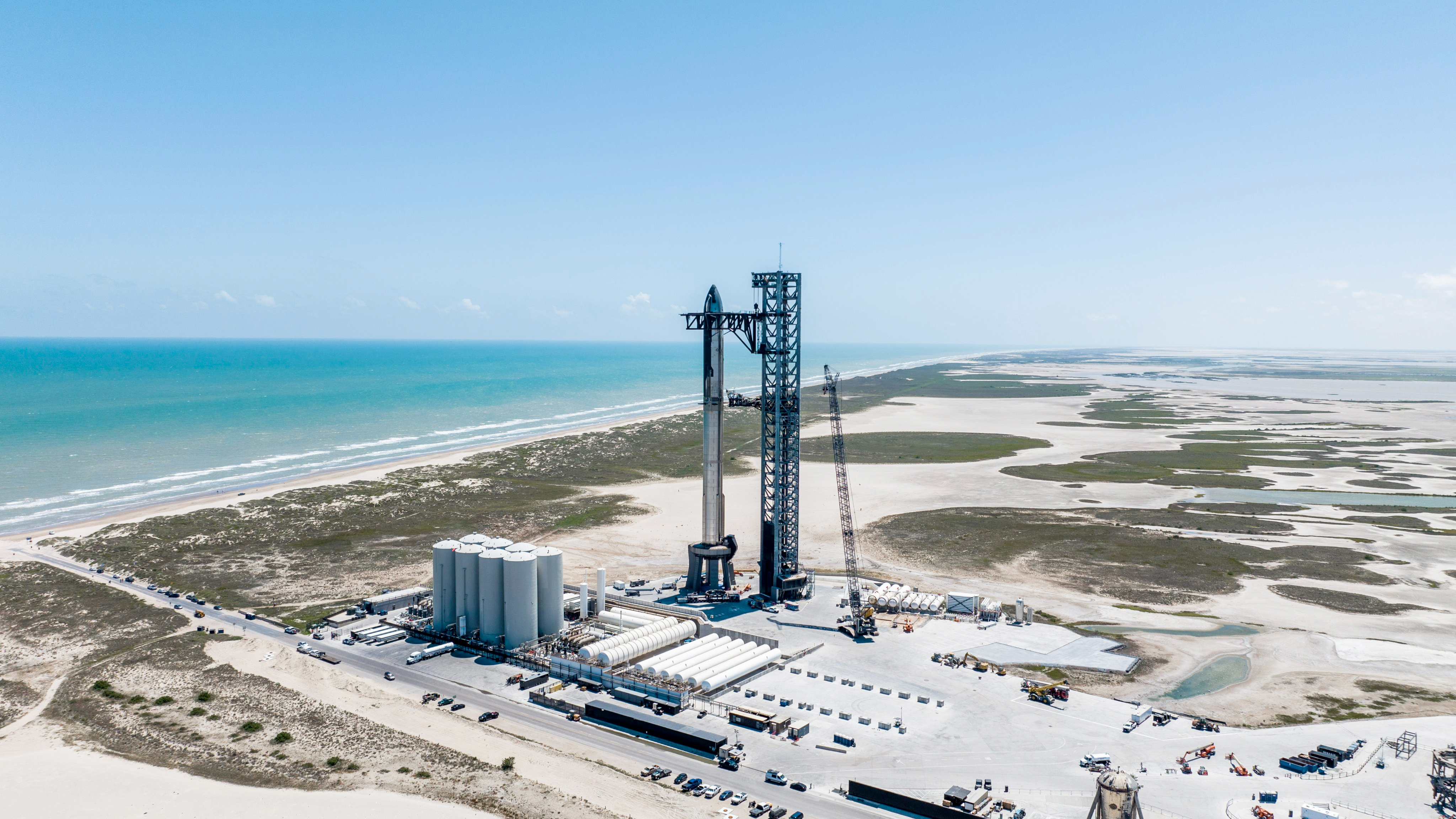

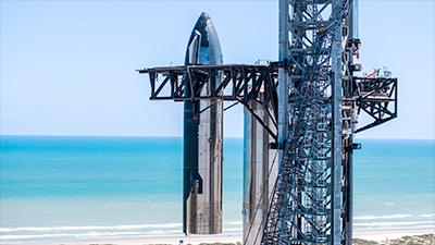

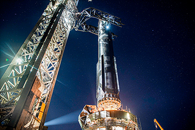

From SpaceX (via X):
Fully stacked Starship on the launch pad at Starbase.
