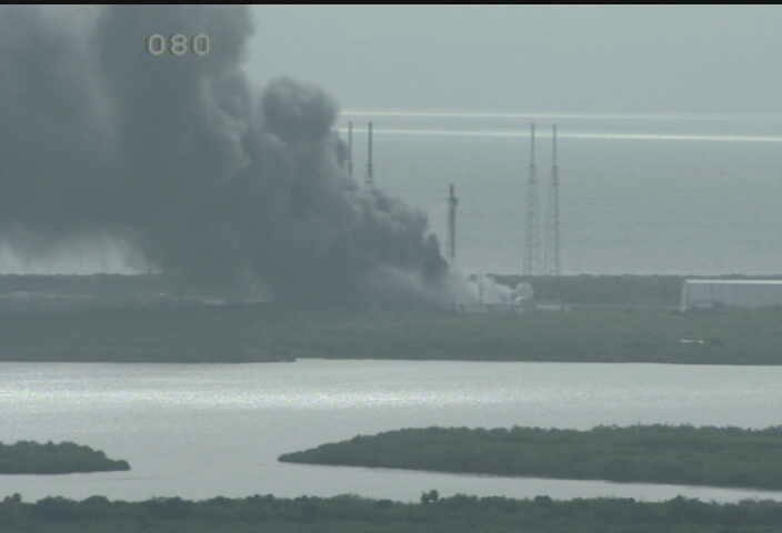

Numerous reports on social media this morning (Sept. 1) of a large explosion at SpaceX's Launch Complex 40 at the Cape Canaveral Air Force Station. Photos taken from a distance show a black plume rising from the site.
From Jonathan McDowell on Twitter:
Very bad news - looks like the SpaceX Falcon 9 due for launch on Saturday may have exploded on the pad at Cape Canaveral a few minutes ago.
From Bill Harwood (CBS) on Twitter:
Falcon 9 set for launch Saturday with AMOS-6 comsat; booster hot fire was believed to be on tap; no word from SpaceX.
From a NASA webcam pointed at LC-40:

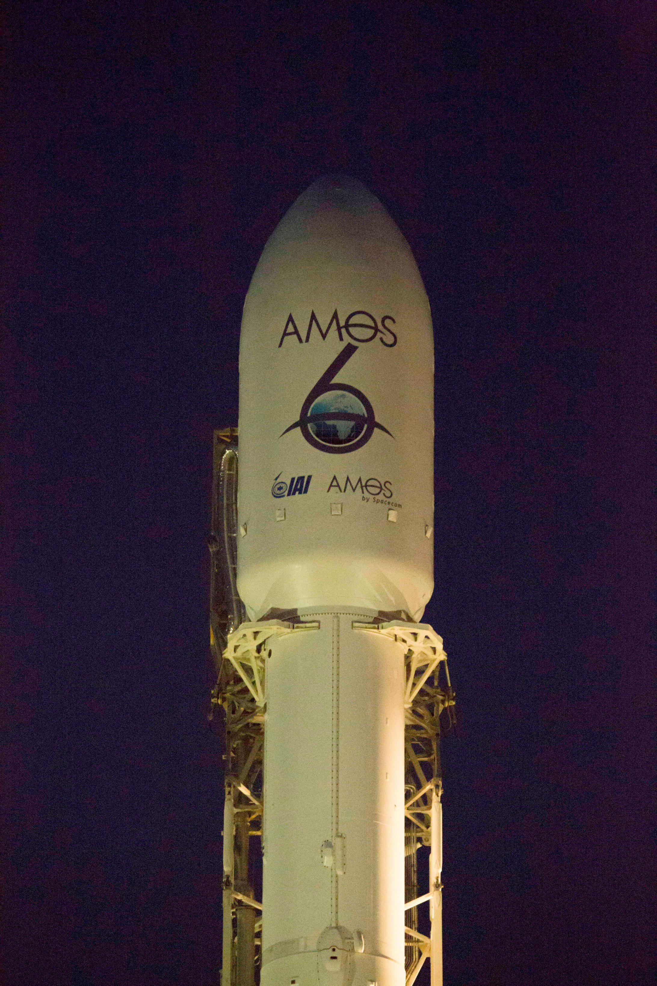

From Peter B. de Selding with SpaceNews on Twitter:
Here's [a pre-explosion] picture of Falcon 9 with Spacecom's Amos-6 telecommunications satellite on Cape Canaveral Air Force Station.

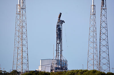

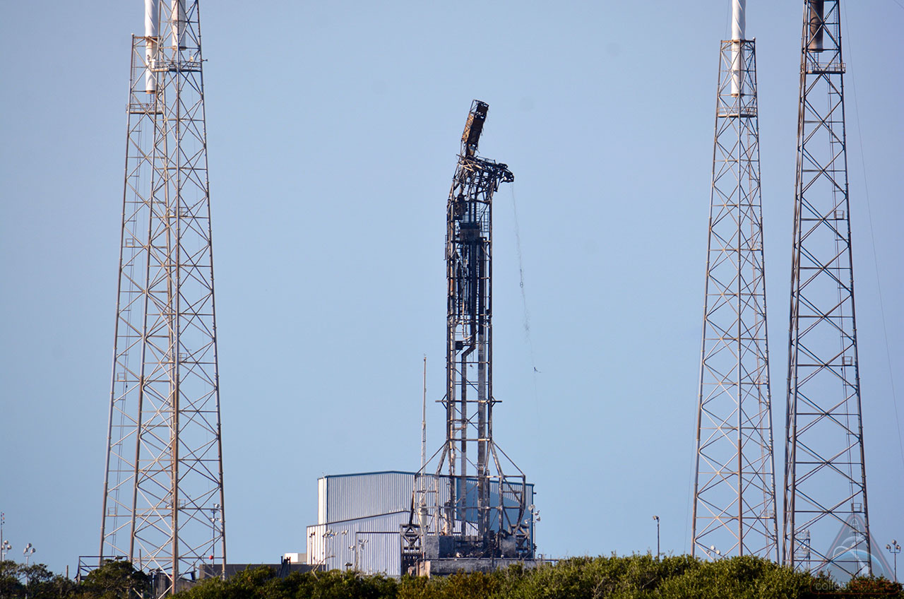

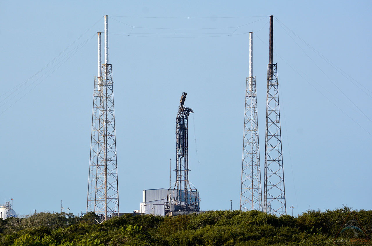

According to Aviation Week & Space Technology's website:
Even before the explosion, which fortunately occurred without any injuries at Space Launch Complex 40 (SLC-40) at Cape Canaveral, SpaceX was already facing a tight schedule to meet its planned target of 18 launches for the year. The vehicle, which was to launch the Amos-6 communications satellite on Sept. 3, was to have been the ninth mission of this year and the 29th Falcon 9 launch overall. SpaceX’s busy year is currently scheduled to culminate in the Falcon Heavy demonstration flight, itself already delayed from late 2015...
Regardless of whether investigations unearth issues with the pad and pre-test propellant and vehicle preparations, rather than more fundamental concerns with the Falcon 9 design itself, the Sept. 1 event will likely delay SpaceX's launch cadence by weeks, if not months. The most immediate impacts will result from the investigation and the time taken to repair the damaged SLC-40 complex.
Given initial evidence from video alone, it would appear highly unlikely the site could be ready in time to support the planned launch of the SES 10 satellite in October, the first intended to reuse a Falcon 9 first stage for a second mission. Other launches are also planned from this pad, including the 10th operational cargo delivery mission for NASA to the International Space Station — currently scheduled for Nov. 11.

Photos of LC-40 (as seen during this morning's Atlas V rollout of OSIRIS-REx):
