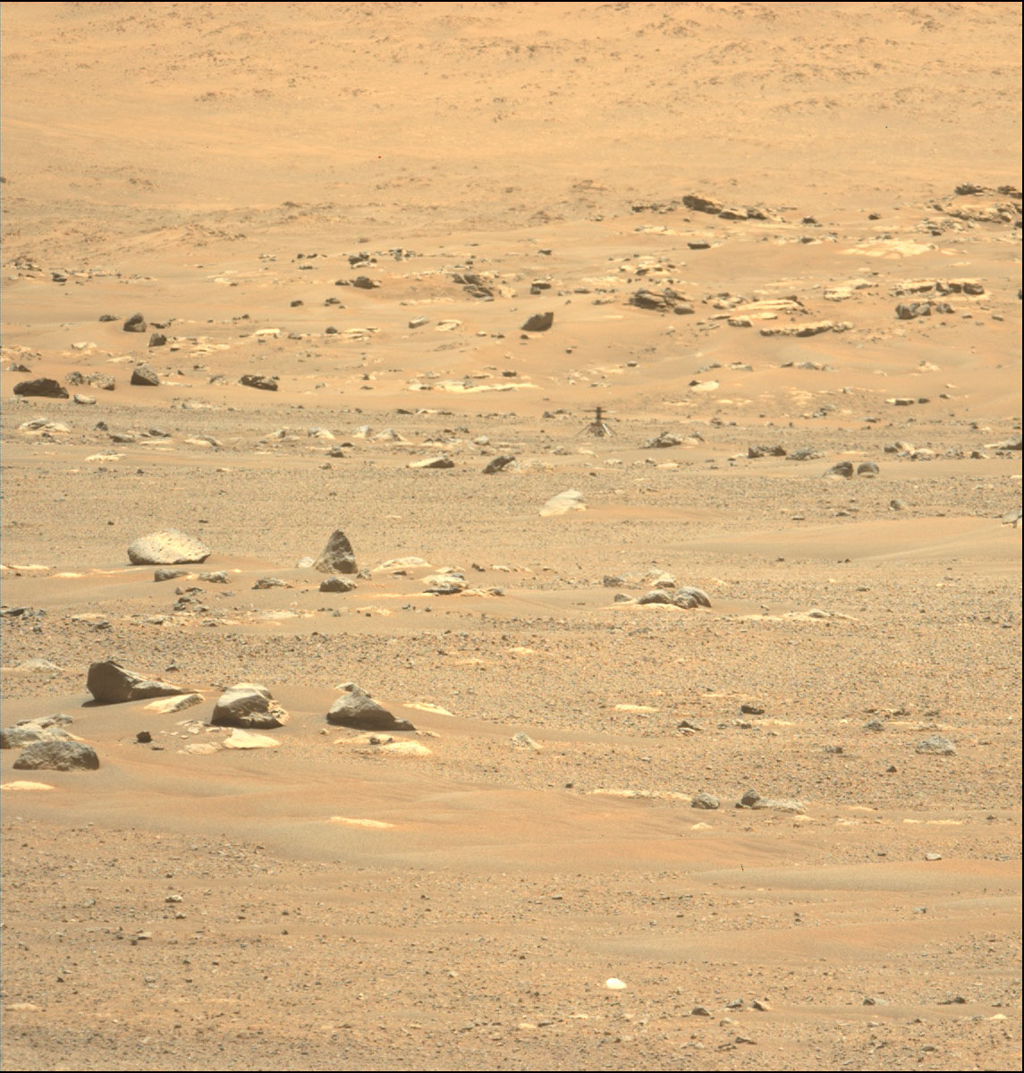

A small rotorcraft has made both aeronautic and astronautic history, becoming the first vehicle to achieve powered flight on a celestial body other than Earth.
Named "Ingenuity," NASA's first Mars helicopter lifted off from the surface of Jezero crater on the Red Planet at 3:34 a.m. EDT (0733 GMT or 12:33 p.m. Local Mean Solar Time on Mars) on Monday (April 19). Flying autonomously, the 1.6-foot-tall (0.49-meter) aircraft spun up its four carbon blades to climb to its planned altitude of 10 feet (3 meters) and maintained a stable hover for 30 seconds.
Ingenuity then descended and touched back down on its four legs after logging 39.1 seconds in flight.

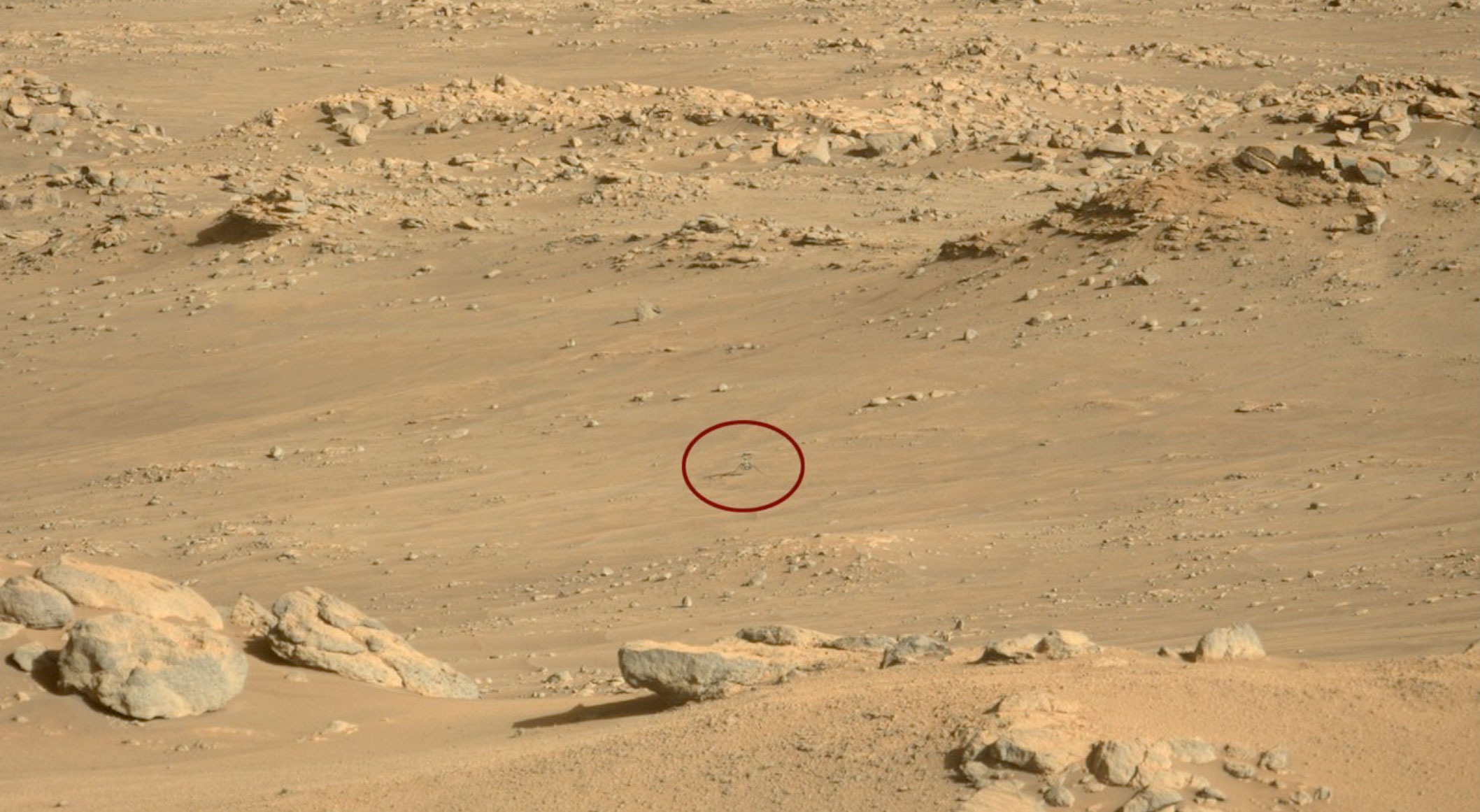

NASA's Ingenuity Mars Helicopter Logs Second Successful Flight
NASA's Ingenuity helicopter successfully completed its second Mars flight on April 22 – the 18th sol, or Martian day, of its experimental flight test window. Lasting 51.9 seconds, the flight added several new challenges to the first, which took place on April 19, including a higher maximum altitude, longer duration, and sideways movement.
Above: NASA's Mars Perseverance rover acquired this image using its left Mastcam-Z camera. Mastcam-Z is a pair of cameras located high on the rover's mast. This is one still frame from a sequence captured by the camera while taking video. This image was acquired on Apr. 22, 2021. (NASA/JPL-Caltech/ASU/MSSS)
"So far, the engineering telemetry we have received and analyzed tell us that the flight met expectations and our prior computer modeling has been accurate," said Bob Balaram, chief engineer for the Ingenuity Mars Helicopter at NASA's Jet Propulsion Laboratory in Southern California. "We have two flights of Mars under our belts, which means that there is still a lot to learn during this month of Ingenuity."
For this second flight test at "Wright Brothers Field," Ingenuity took off again at 5:33 a.m. EDT (2:33 a.m. PDT), or 12:33 p.m. local Mars time. But where Flight One topped out at 10 feet (3 meters) above the surface, Ingenuity climbed to 16 feet (5 meters) this time. After the helicopter hovered briefly, its flight control system performed a slight (5-degree) tilt, allowing some of the thrust from the counter-rotating rotors to accelerate the craft sideways for 7 feet (2 meters).
"The helicopter came to a stop, hovered in place, and made turns to point its camera in different directions," said Håvard Grip, Ingenuity's chief pilot at JPL. "Then it headed back to the center of the airfield to land. It sounds simple, but there are many unknowns regarding how to fly a helicopter on Mars. That's why we're here – to make these unknowns known."

Above: NASA's Ingenuity Mars Helicopter took this color image from an altitude of 33 feet (10 meters) during its fifth flight on May 7, 2021. (NASA/JPL-Caltech)
Ingenuity's flight plan begins with the helicopter ascending to 33 feet (10 meters), then heading southwest for about 492 feet (150 meters). When it achieves that distance, the rotorcraft will begin acquiring color imagery of an area of interest as it translates to the south about 50-66 feet (15-20 meters). Stereo imagery of the sand ripples and outcrops of bright rocks at the site will help demonstrate the value of an aerial perspective for future missions. After completing its image collection, Ingenuity will fly about 164 feet (50 meters) northeast where it will touch down at its new base of operations (known as "Field C").
Ingenuity is planning to continue to expand its performance envelope during Flight Six. The top groundspeed Ingenuity is expected to achieve on this flight is 9 mph (4 meters per second) and the time aloft will be around 140 seconds. It is also the first time the helicopter will land at an airfield which it did not survey from the air during a previous mission. Instead, the Ingenuity team is relying on imagery collected by the HiRISE camera aboard NASA's Mars Reconnaissance Orbiter that suggests this new base of operations is relatively flat and has few surface obstructions.

Mars Helicopter completed its 7th flight and second within its operations demo phase. It flew for 62.8 seconds and traveled about 106 meters south to a new landing spot. Ingenuity also took this black-and-white navigation photo during flight.

Another successful flight for Ingenuity! The Mars Helicopter completed its 8th flight on Monday [June 22]. It flew for 77.4 seconds and traveled 160 meters to a new landing spot about 133.5 meters from Perseverance, capturing its own shadow in this image.

Above: Ingenuity sits on a slightly inclined surface with about 6-degree tilt at the center of the frame, just north of the southern ridge of “Séíitah” geologic unit. The Perseverance rover’s Mastcam-Z instrument took this image on Dec. 1, 2021, when the rotorcraft was about 970 feet (295 meters) away. (NASA/JPL-Caltech/ASU/MSSS)
