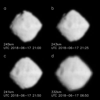

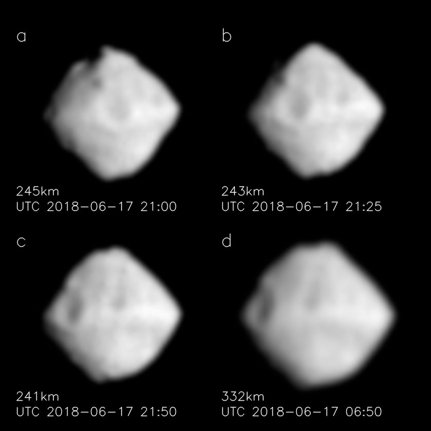

Ryugu seen from 330-240km
The ONC-T (Optical Navigation Camera - Telescopic) captured images of Ryugu on June 17, 2018 at around 15:00 JST and June 18 at around 06:00 JST. At 15:00 JST on June 17, the distance to Ryugu was approximately 330 km, which had decreased to 240 km by June 18 at 06:00 JST.
The following figures show the original images taken by the ONC-T, without any pixel smoothing. The order of the photographs is not chronological, but show the sequential rotation of the asteroid. The change in distance is compensated by keeping the size of the asteroid constant through the image set.
This next image set is the same as the previous photographs, but with the pixels smoothed and G image processing applied which emphasizes light and dark regions.
Comment by Project Scientist, Sei-ichiro Watanbe
The vertical direction in these images is tilted by 10 degrees counterclockwise compared to the vertical direction of the orbital plane of Ryugu. From looking between the multiple images in this set, you can see that the vertical direction is nearly perpendicular to the plane of revolution of the asteroid. We call this direction the asteroid's axis of rotation. The direction of the rotation is reversed compared to the Earth, with a rotation period of about 7.5 hours.
The diameter of Ryugu is about 900m, which is consistent with the prediction from ground observations. However, since the distance between the spacecraft and Ryugu is not precisely determined, there is still some uncertainty in the exact diameter at this time.
The shape of the asteroid looks like a spinning top (called a "Coma" in Japanese), with the equatorial part wider than the poles. This form is seen in many small asteroids that are rotating at high speed. Observed by radar from the ground, asteroid Bennu (the destination of the US mission, OSIRIS-REx), asteroid Didymous (the target of the US DART project), and asteroid 2008 EV5 that is approaching the Earth, all have a similar shape.
On the surface of asteroid Ryugu, you can see a number of crater-like round recessed landforms. In the first image, one large example can be seen with a diameter exceeding 200m. This moves to the left and darkens as the asteroid rotates and the lower part becomes cast in shadows.
The bulge at the equator forms a ridge around the asteroid like a mountain range. Outside this, the surface topology appears very ridge-shaped and rock-like bulges are also seen. These details should become clearer as the resolution increases in the future.
Comment by Mission Manager, Makoto Yoshikawa
When I saw these images, I was surprised that Ryugu is very similar in shape to both the destination of the US OSIRIS-REx mission, asteroid Bennu, and also the target of the previously proposed MarcoPolo-R mission by Europe, asteroid 2008 EV5. Bennu and 2008 EV5 are about half the diameter (and 1/8 the volume) of Ryugu, with rotation periods about half as long. In other words, these celestial bodies are small and rotating fast compared to Ryugu.
On the other hand, Bennu is a B-type asteroid, which is very similar to C-type asteroids such as 2009 EV5 and Ryugu. Therefore there should also be common properties due to the asteroid type. So we have both differences and similarities that have combined to produce very similar shapes... why is that? I think this is very interesting. So far, the asteroids we have explored have been different in shape, so Ryugu and Bennu could be the first time two similar-shaped asteroids have been examined. It will be interesting to clarify exactly what this similarity means scientifically.
If the axis of rotation for Ryugu is close to the vertical direction in this image, there is a big advantage as it will be possible to know almost the entire appearance of Ryugu at an early stage after arrival. This makes the project planning easier. However, it is also possible that potential landing sites may be limited to the equator of Ryugu. I hope we can find a suitable place to set down the lander and rovers.

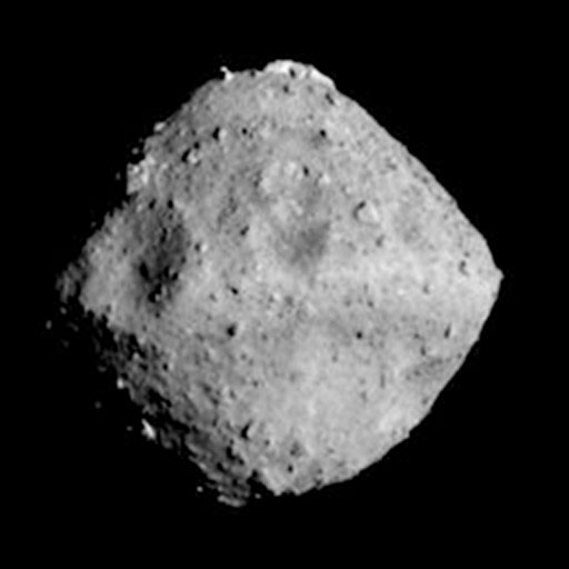

Asteroid Ryugu seen from a distance of around 40km
Hayabusa2 is close to arriving at asteroid Ryugu. After a journey of around 3.2 billion km since launch, our destination is finally near. Two small objects will soon meet in outer space 280 million km from the Earth.
Figure 1 shows Ryugu photographed by the ONC-W1 (Optical Navigation Camera - Wide angle) on June 24, at about 15:00 JST. We can see Ryugu floating in the jet black of space.
Figure 2 shows Ryugu photographed with the ONC-T (Optical Navigation Camera - Telescopic) on June 24, at around 00:01 JST. The appearance of the surface has now become much clearer. The distance between the spacecraft and the asteroid when this photo was taken was about 40 km.
Comment by Project Manager, Yuichi Tsuda
The shape of Ryugu is now revealed. From a distance, Ryugu initially appeared round, then gradually turned into a square before becoming a beautiful shape similar to fluorite [known as the 'firefly stone' in Japanese]. Now, craters are visible, rocks are visible and the geographical features are seen to vary from place to place. This form of Ryugu is scientifically surprising and also poses a few engineering challenges.
First of all, the rotation axis of the asteroid is perpendicular to the orbit. This fact increases the degrees of freedom for landing and the rover decent operations. On the other hand, there is a peak in the vicinity of the equator and a number of large craters, which makes the selection of the landing points both interesting and difficult. Globally, the asteroid also has a shape like fluorite (or maybe an abacus bead?). This means we expect the direction of the gravitational force on the wide areas of the asteroid surface to not point directly down. We therefore need a detailed investigation of these properties to formulate our future operation plans.
The Project Team is fascinated by the appearance of Ryugu and morale is rising at the prospect of this challenge. Together with all of you, we have become the first eyewitnesses to see asteroid Ryugu. I feel this amazing honor as we proceed with the mission operations.

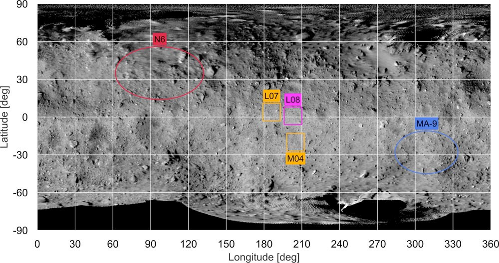

Determination of landing site candidates!
The Landing Site Selection (LSS) conference was held on August 17, 2018 and the candidate landing locations for touchdown, MASCOT and MINERVA-II-1 on the surface asteroid Ryugu were decided. In this article, we introduce the landing candidate spots and the planned dates for these surface operations, along with details of the selection.
Figure 1 is a map of asteroid Ryugu showing the landing candidate locations. Please note the direction of north and south on this map.
Note: On the map shown in Figure 1, the north pole of the asteroid is on the top of the map. Public images released so far show the asteroid orientated in the opposite direction, with the direction of the Solar System's north and for the Earth's North Pole) at the top. Geographical north and south of the asteroid is determined by rotation. As Ryugu rotates retrograde, in the opposite direction to the Earth and the Solar System, the asteroid's northern direction is reversed with respect to the Solar System. The situation is the same for Itokawa. An image with the asteroid's north at the top is therefore reversed compared to an image where the Solar System north points upwards.
The areas within the colored lines in Figure 1 are the candidate areas for the landing sites for the touchdown of the Hayabusa2 mothership (for sampling), MASCOT and MINERVA-II-1. These are labelled as:
  • Touchdown: L08 (backup sites: L07, M04)
  • MASCOT: MA-9
  • MINERVA-II-1: N6
L08 is the first choice (primary) candidate for the mothership's touchdown, with L07 and M04 as back-up options. The designation "L" and "M" refer to low latitude (L) and mid-latitude (M) positions. The "L" candidate positions were selected from among 13 preliminary candidate sites, while the "M" location was chosen from a set of four candidate sites. The size of the site selection rectangles are approximately 100m. MA-9 was selected as the candidate landing site for MASCOT from ten possibilities, while the N6 candidate for MIENRA-II-1 was chosen from seven surface locations.
In Figure 2, each candidate region is shown on the ONC-T image taken during the BOX-C observations at an altitude of 6km. Also in this image, the top of the asteroid is the north pole.

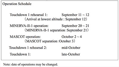

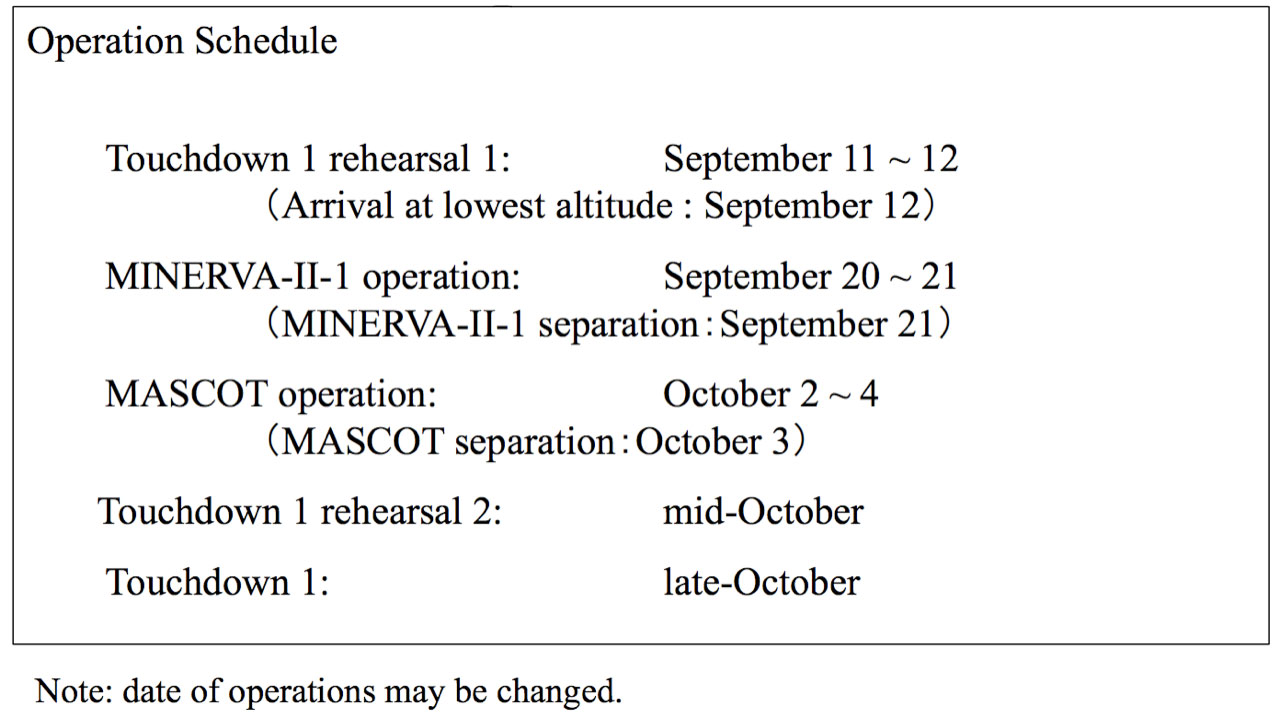

Following the determination of the landing site candidates, the operation schedule is as follows:

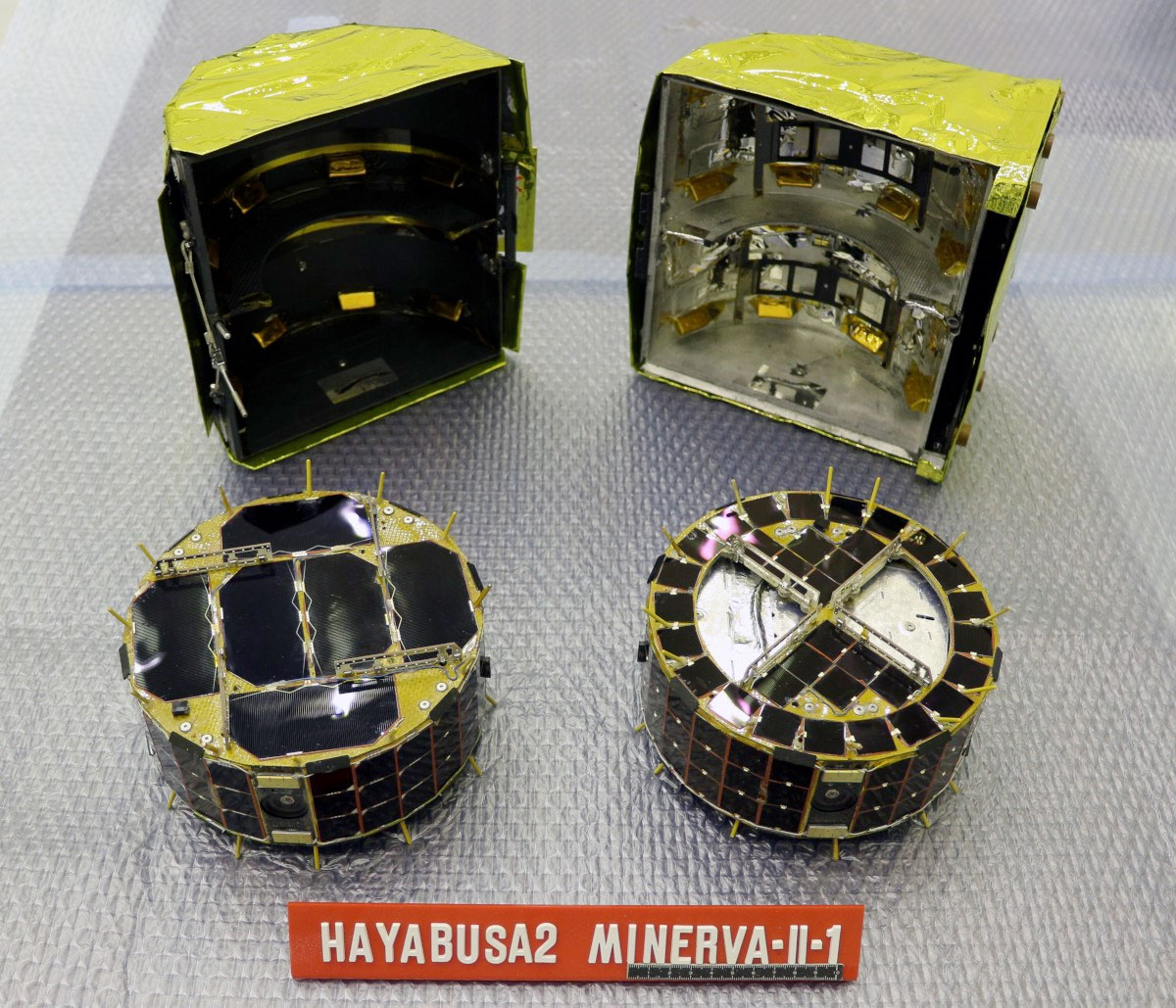

JAXA's Hayabusa2 probe deployed its first two landers, the MINERVA II 1 (MIcro Nano Experimental Robot Vehicle for Asteroid, the second generation) rovers 1A and 1B, at about 12:35 a.m. EDT on Friday (Sept. 21) after descending toward Ryugu and coming within 200 feet of the asteroid's surface.
From the mission's Twitter account:
Heeeeeeere weeeeee cooooome!!!!!!!!!
The two MINERVA-II 1 rovers are hexagonal in shape with a diameter of 7 inches (18 cm), height of 3 inches (7 cm) and weigh about 2.4 pounds (1.1 kg) each.
There are four cameras on Rover-1A and three cameras on Rover-1B that will be used to create a stereo image of the surface of Ryugu. The rovers are also equipped with sensors to measure the surface temperature of Ryugu.
The main feature of MINERVA-II 1 rovers is their ability to move. Within the rover is a motor that rotates and causes the rover to "hop" (jump up) during the rebound. This will allow the rovers to autonomously move across the asteroid surface and explore multiple areas.
Due to the low gravity on Ryagu, the rover is expected to remain aloft for up to 15 minutes after a single hop before landing, and to move up to 50 feet (15 m) horizontally.

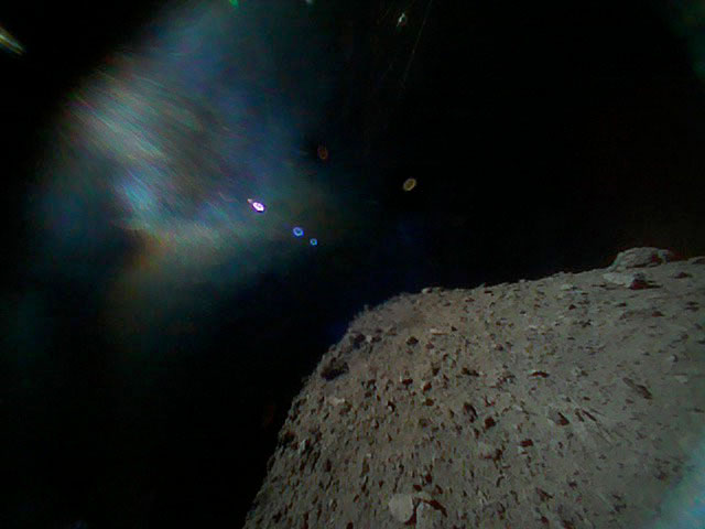

MINERVA-II1: Successful image capture, landing on Ryugu and hop!
On September 21, the small compact MINERVA-II1 rovers separated from the Hayabusa2 spacecraft (time of separation was 13:06 JST). The MINERVA-II1 consists of two rovers, Rover-1A and Rover-1B. We have confirmed both rovers landed on the surface of asteroid Ryugu. The two rovers are in good condition and are transmitting images and data. Analysis of this information confirmed that at least one of the rovers is moving on the asteroid surface.
MINERVA-II1 is the world's first rover (mobile exploration robot) to land on the surface of an asteroid. This is also the first time for autonomous movement and picture capture on an asteroid surface. MINERVA-II1 is therefore "the world's first man-made object to explore movement on an asteroid surface". We are also delighted that the two rovers both achieved this operation at the same time.
The following is a picture sent from MINERVA-II1.
Figure 1: Image captured by Rover-1A on September 21 at around 13:08 JST. This is a color image taken immediately after separation from the spacecraft. Hayabusa2 is at the top and the surface of Ryugu is bottom. The image is blurred because the shot was taken while the rover was rotating.
Figure 2: Image captured by Rover-1B on September 21 at around 13:07 JST. This color image was taken immediately after separation from the spacecraft. The surface of Ryugu is in the lower right. The coloured blur in the top left is due to the reflection of sunlight when the image was taken.
Figure 3: Image captured by Rover-1A on September 22 at around 11:44 JST. Color image captured while moving (during a hop) on the surface of Ryugu. The left-half of the image is the asteroid surface. The bright white region is due to sunlight.
The MINERVA-II1 cameras can shoot in color. In Figure 1, although the image is blurred due to the rover rotating, you can clearly see the body of Hayabusa2 and the paddle of the solar cells. The solar paddle appears blue. In Figure 3, the image was taken during a hop on the surface and you can feel this dynamic movement.
Operation of MINERVA-II1 will continue from now on. We are planning to acquire more data for analysis.

MINERVA-II1: Images from the surface of Ryugu
The MINERVA-II1 rovers were deployed on September 21 to explore the surface of asteroid Ryugu. Here is the second report on their activities, following our preliminary article at the start of this week. We end this report with a video taken by one of the rovers that shows the Sun moving across the sky as seen from the surface of Ryugu. Please take a moment to enjoy "standing" on this new world.

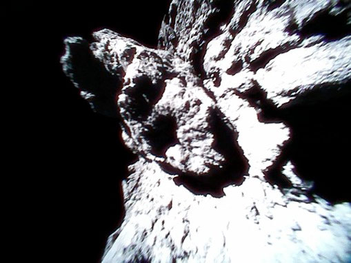

Rover-1B hop
Figure 1. Images taken by Rover-1B. September 23, 2018: confirmation of Rover-1B hop. Observation time (JST): (Left) 2018-09-23 09:50, (Right) 2018-09-23 09:55, (Below) 2018-09-23 10:00.
Image captured immediately before hop of Rover-1B
Figure 2. September 23, 2018: image captured immediately before hop of Rover-1B. 2018-9-23 09:46 (JST).
Surface image from Rover-1B after landing
Figure 3. September 23, 2018 at 10:10 JST: surface image from Rover-1B after landing.

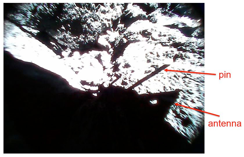

Surface image taken from Rover-1A
Figure 4. September 23, 2018 at 09:43 JST: surface image taken from Rover-1A.
Rover-1A captured the shadow of its own antenna and pin
Figure 5. September 23, 2018 at 09:48 JST: surface image taken from Rover-1A. MINERVA-II1 successfully captured the shadow of its own antenna and pin.
The pins on the MINERVA-II rovers have three roles:
  1. To increase friction when hopping
  2. Protect the solar cells during landing
  3. A few of the pins also have a temperature sensor, so surface temperature can be measured directly.

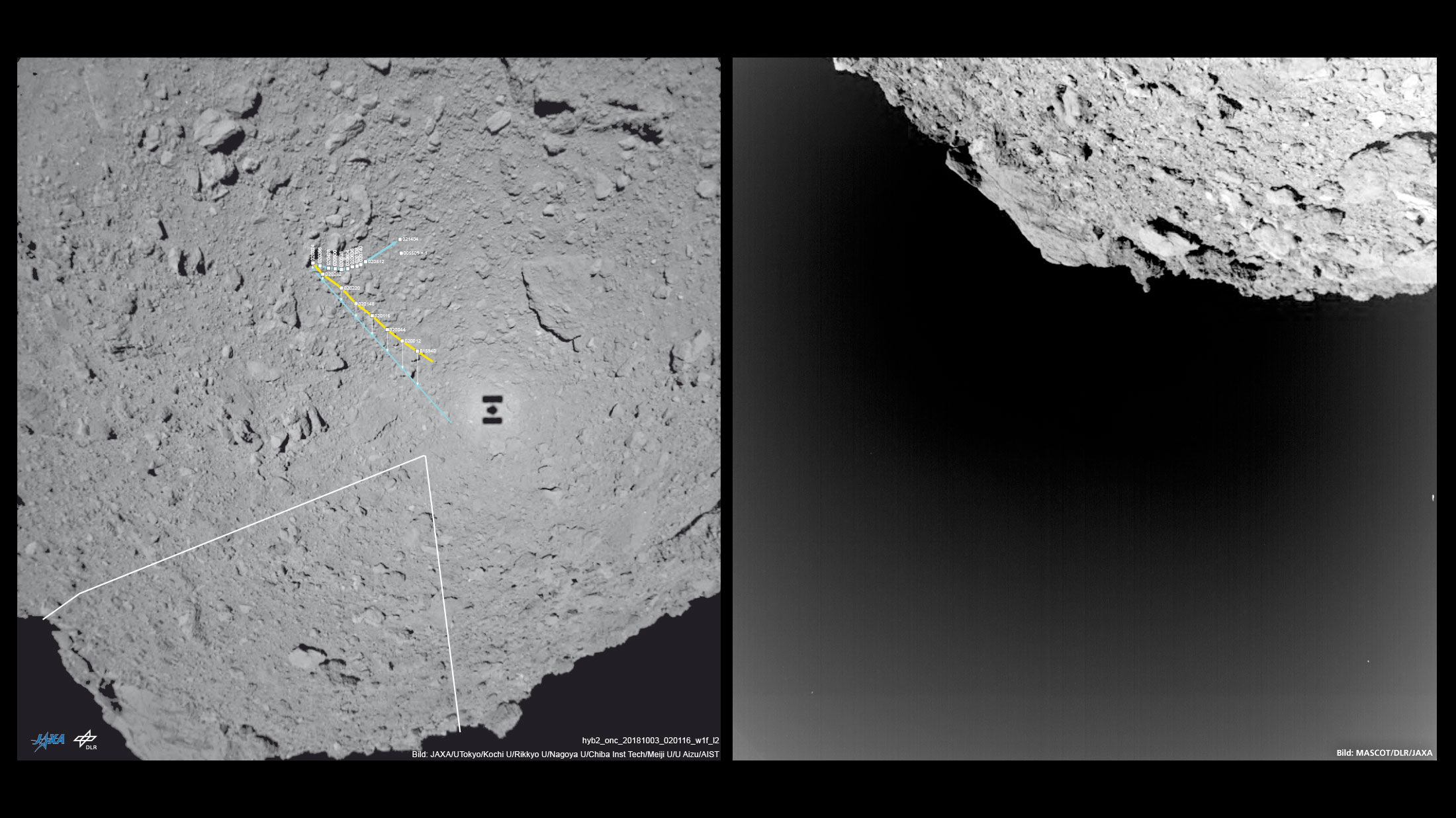

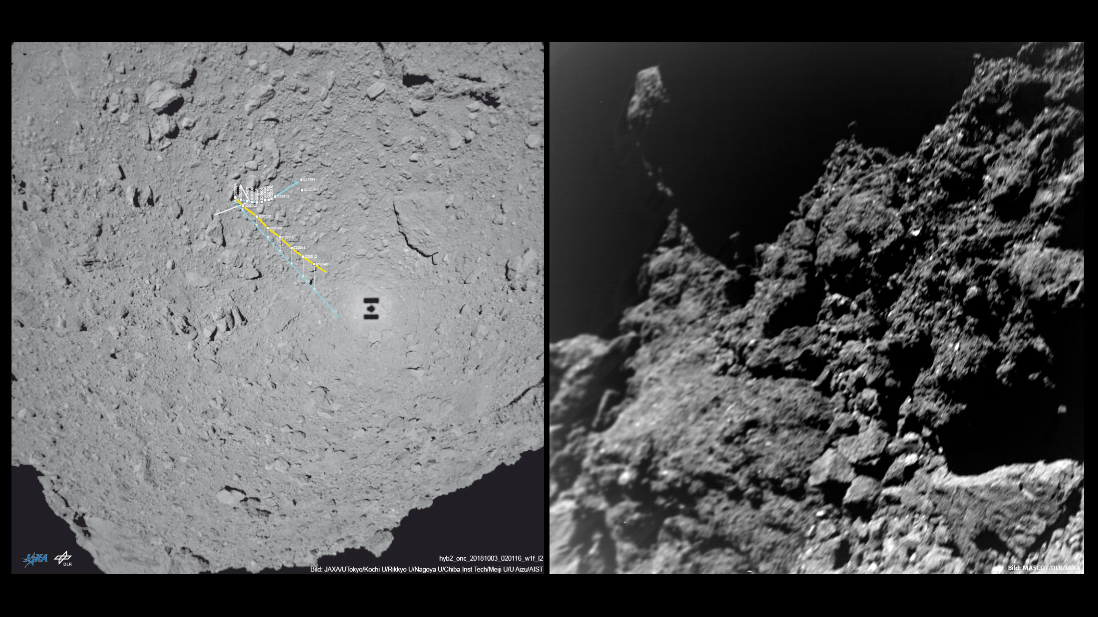

Posts: 48897
posted 10-03-2018 07:49 AM     Click Here to See the Profile for Robert Pearlman   Click Here to Email Robert Pearlman     Edit/Delete Message   Reply w/Quote
DLR release
MASCOT lands safely on asteroid Ryugu
The near-Earth asteroid Ryugu, located approximately 300 million kilometres from Earth, has a new inhabitant: On 3 October 2018, the Mobile Asteroid Surface Scout (MASCOT) landed on the asteroid and began to work.
The lander successfully separated from the Japanese Hayabusa2 space probe at 03:58 CEST. The 16 hours in which the lander will conduct measurements on the asteroid’s surface have begun for the international team of engineers and scientists.
The day before, the Japanese Space Agency's Hayabusa2 began its descent towards Ryugu. MASCOT was ejected at an altitude of 51 metres and descended in free fall – slower than an earthly pedestrian – to its destination, the asteroid. The relief about the successful separation and subsequent confirmation of the landing was clearly noticeable In the MASCOT Control Centre at the German Aerospace Center (Deutsches Zentrum für Luft- und Raumfahrt; DLR) as well as in the adjoining room: "It could not have gone better," explained MASCOT project manager Tra-Mi Ho from the DLR Institute of Space Systems. "From the lander's telemetry, we were able to see that it separated from the mothercraft, and made contact with the asteroid surface approximately 20 minutes later." The team is now in contact with the lander.
The moment of separation was one of the risks of the mission: If MASCOT had not successfully separated from Hayabusa2 as planned and often tested, the lander’s team would hardly have had the opportunity to solve this problem. But everything went smoothly: Already during the descent on the asteroid, the camera switched MASCAM on and took 20 pictures, which are now stored on board the Japanese space probe. "The camera worked perfectly," says Ralf Jaumann, DLR planetary scientist and scientific director of the camera instrument. "The team's first images of the camera are therefore safe."
The magnetometer team was also able to recognise in the data sent by MASCOT that the MASMAG instrument had switched on and performed measurements prior to the separation. "The measurements show the relatively weak field of the solar wind and the very strong magnetic disturbances caused by the spacecraft," explains Karl-Heinz Glaßmeier from the Technical University of Braunschweig. "At the moment of the separation, we expected a clear decrease of the interference field – and we were able to recognise this clearly."

Numerous boulders, many rocks, no dust: MASCOT's zigzag course across the asteroid Ryugu
Six minutes of free fall, a gentle impact on the asteroid and then 11 minutes of rebounding until coming to rest. That is how, in the early hours of 3 October 2018, the journey of the MASCOT asteroid lander began on Asteroid Ryugu – a land full of wonder, mystery and challenges. Some 17 hours of scientific exploration followed this first "stroll" on the almost 900-metre diameter asteroid.
The lander was commanded and controlled from the MASCOT Control Centre at the German Aerospace Center (Deutsches Zentrum für Luft- und Raumfahrt; DLR) site in Cologne in the presence of scientific teams from Germany, France and Japan. MASCOT surpassed all expectations and performed its four experiments at several locations on the asteroid. Never before in the history of spaceflight has a Solar System body been explored in this way. It has now been possible to precisely trace MASCOT's path on Ryugu's surface on the basis of image data from the Japanese Hayabusa2 space probe and the lander's images and data.
Above: MASCOT's approach to Ryugu and its path across the surface.
"This success was possible thanks to state-of-the-art robotic technology, long-term planning and intensive international cooperation between the scientists and engineers of the three space nations Japan, France and Germany," says Hansjörg Dittus, DLR Executive Board Member for Space Research and Technology about this milestone in Solar System exploration. "We are proud of how MASCOT was able to master its way across the asteroid Ryugu over boulders and rocks and send so much data about its composition back to Earth," says DLR Chair Pascale Ehrenfreund.
MASCOT had no propulsion system and landed in free fall. Six minutes after separating from Hayabusa2, and following the end of a ballistic trajectory, the landing module made its first contact with asteroid Ryugu. On the surface, MASCOT moved through the activation of a tungsten swing arm accelerated and decelerated by a motor. This made it possible for MASCOT to be repositioned to the 'correct' side or even perform hops across the asteroid's surface. The gravitational attraction on Ryugu is just one 66,500th of the Earth's, so the little momentum provided was enough: a technological innovation for an unusual form of mobility on an asteroid surface used for the first time in the history of space travel as part of the Hayabusa2 mission.
Above: MASCOT's image of Ryugu's south polar region shortly after separation.
Through a rock garden full of rough boulders and no flat surfaces
To reconstruct MASCOT's path across the surface of Ryugu, the cameras aboard the Hayabusa2 mother probe were aimed at the asteroid. The Optical Navigation Cameras (ONC) captured the lander's free fall in several images, detected its shadow on the ground during the flight phase, and finally identified MASCOT directly on the surface in several images. The pattern of the countless boulders distributed on the surface could also be seen in the direction of the respective horizon in oblique photographs of the lander's DLR MASCAM camera. The combination of this information unlocked the unique path traced by the lander.
Above: MASCOT image pointing east while descending on Ryugu.
After the first impact, MASCOT smoothly bounced off a large block, touched the ground about eight times, and then found itself in a resting position unfavorable for the measurements. After commanding and executing a specially prepared correction maneuver, MASCOT came to a second halt. The exact location of this second position is still being determined. There, the lander completed detailed measurements during one asteroid day and night. This was followed by a small 'mini-move' to provide the MicrOmega spectrometer with even better conditions for measuring the composition of the asteroid material.
Finally, MASCOT was set in motion one last time for a bigger jump. At the last location it carried out some more measurements before the third night on the asteroid began, and contact with Hayabusa2 was lost as the spaceship had moved out of line of sight. The last signal from MASCOT reached the mother probe at 21:04 CEST. The mission was over. "We were expecting less than 16 hours of battery life because of the cold night, says MASCOT project manager Tra-Mi Ho from the DLR Institute of Space Systems. "After all, we were able to operate MASCOT for more than one extra hour, even until the radio shadow began, which was a great success." During the mission, the team named MASCOT's landing site (MA-9) "Alice's Wonderland," after the eponymous book by Lewis Carroll (1832-1898).
Above: MASCOT's fourth image during the descent to Ryugu.

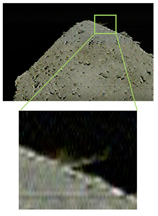

Japan Aerospace Exploration Agency (JAXA) separated the SCI (Small Carry-on Impactor), which had been onboard the asteroid explorer Hayabusa2, on April 5, 2019, for deployment to Ryugu, and then put the SCI into operation.
As a result of checking the images captured by the Optical Navigation Camera - Telescopic (ONC-T) onboard the asteroid explorer Hayabusa2, we have concluded that a crater was created by the SCI.
Hayabusa2 is operating normally.
Above: Left image: Taken on March 22, 2019. Right image: Taken on April 25, 2019. These images were captured by the Optical Navigation Camera - Telescopic onboard Hayabusa2. By comparing the two images, we have confirmed that an artificial crater was created in the area surrounded by dotted lines. The size and depth of the crater are now under analysis.

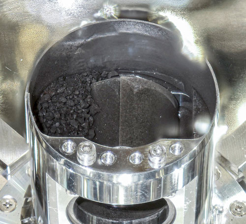

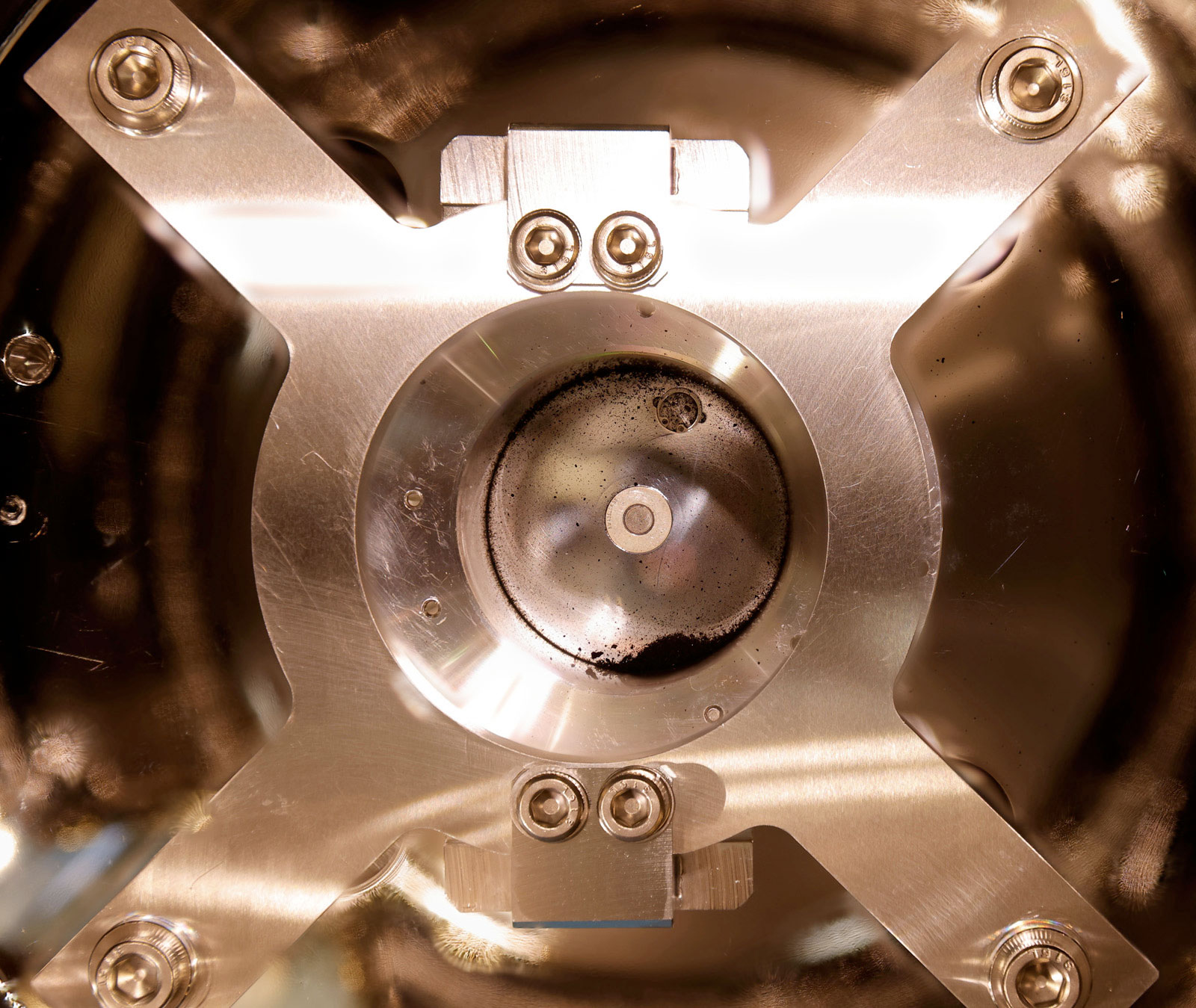

Images of the samples from Ryugu
Images taken after opening the sample container and sample catcher.

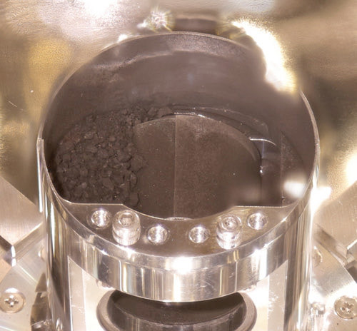

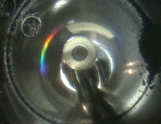

Opening the sample container: Observing the bottom of the sample container from above. Black-colored grains from Ryugu can be seen at the bottom of the sample container, which is outside the chambers in the sample catcher.
Inside the sample container captured by a scope camera.

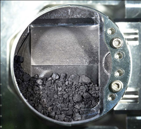

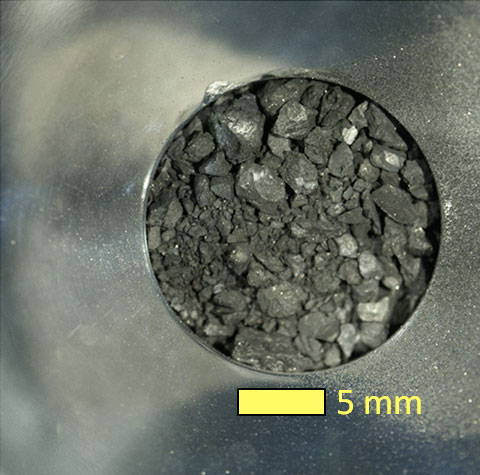

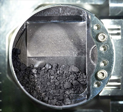

Samples confirmed in sample catcher chamber A: Close-up of the samples in chamber A, color-corrected to allow for the orange ambient light in the curation facility.
The opened sample catcher chamber A.
Sample catcher chamber A, captured by an optical microscope.

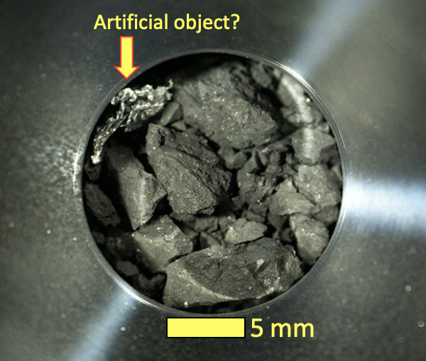

Many particles larger than 1mm were found in both chambers A and C. It appears that the particles in chamber C are typically bigger than those in chamber A. Chamber C material was gathered during the second touchdown, which is expected to contain subsurface material ejected from the creation of the artificial crater.
Sample catcher chamber C, captured by an optical microscope.
Artificial material seems to be present in chamber C. The origin is under investigation, but a probable source is aluminium scraped off the spacecraft sampler horn as the projectile was fired to stir up material during touchdown.
