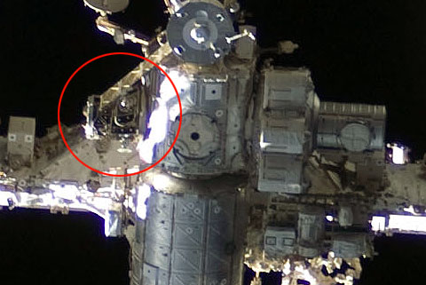

During STS-128's second spacewalk, Danny Olivas found that heater cables on the outside of Pressurized Mating Adapter 3 were in an unexpected configuration.
According to a NASA report, the berthing port may have been "clocked" incorrectly when it was moved on August 7 from Unity's nadir to its port side.
From the September 5, 2009 ISS On-Orbit Status:
After the EVA-2 crew discovered that the PMA-3 (Pressurized Mating Adapter 3) is rotated ("clocked") 90 degrees off ("tail nadir") from the expected orientation ("tail aft")...
It was also confirmed that the actual PMA-3 orientation is the same as in 2007 (Expedition 15) before it was relocated to Node 1 nadir, and that this is the correct orientation expected for HTV rendezvous/ berthing.
There are currently no plans to rectify the situation which requires that entrances to PMA-3 need to be restricted to certain (solar-heated) Beta angle periods to prevent condensation within the module.
The root cause for this discrepancy is under investigation.
PMA-3, as seen during STS-128, as Discovery approached the station. Credit: NASA
