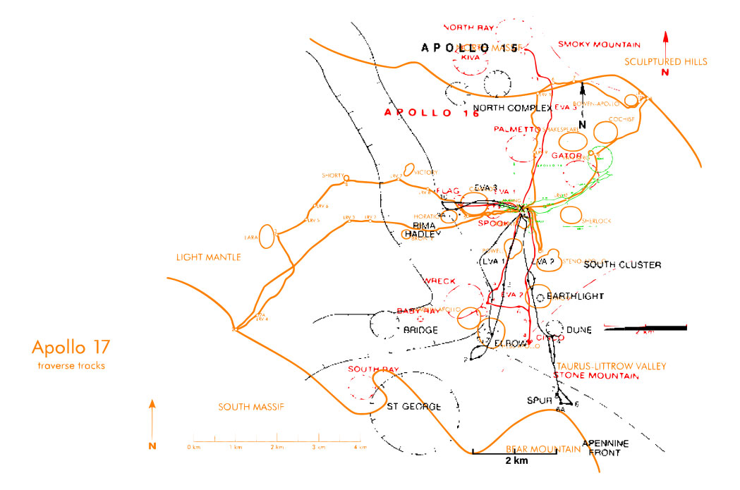

I have overlaid each lunar surface EVA traverse map to compare the distances traveled by each mission, aligned by landing site. The Apollo 11 map is included, but fits within the landing site marker of other missions. Apollo 14 is green.Theoretically, if the Apollo 14 mission had a lunar rover vehicle, it could easily traverse the distance that the Apollo 14 crew walked. The rovers demonstrated their ability to climb hills, and the allocated EVA mission time would allow for the rover to zig-zag the climb up Cone Crater.  |

quote: Originally posted by Paul78zephyr: If Apollo 14 had an lunar roving vehicle, could Alan Shepard and Edgar Mitchell have driven to the top of Cone Crater?
With consummate ease. Maybe 1.3 or 1.4 km max from Antares. |

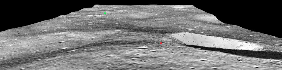

I did some 3D modelling of the area and came up with this: The red dot is my estimate of where they got to, the green dot the LM. You can see that as cone crater was angled away from them they just wouldn't have seen it. |

As one of the NASA geologists said to Shepard after the mission: "You weren't lost, but you didn't know it." |

quote: Originally posted by One Big Monkey: I did some 3D modelling of the area and came up with this...
That is an excellent representation of the issue Shepard and Mitchell faced in not being able to find the rim. It probably never occurred to them that they were on higher ground than the crater and were looking directly over it. |
