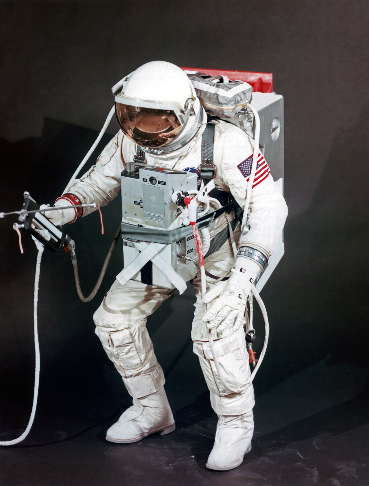

posted 07-20-2013 01:40 PM     Click Here to See the Profile for LM-12     Edit/Delete Message   Reply w/Quote
This photo of the EVA equipment for Gemini 8 shows the chest-mounted ELSS and the ESP back pack. He is holding the HHMU in his right hand. The ESP was similar in shape to the AMU on Gemini 9A.
Originally posted by garymilgrom:
Very surprised they would have someone outside during an undocking.
That was the plan for Gemini 9A also. Tom Stafford was to undock the Gemini 9A spacecraft from the ATDA while Gene Cernan was in the adapter section strapped to the AMU.
