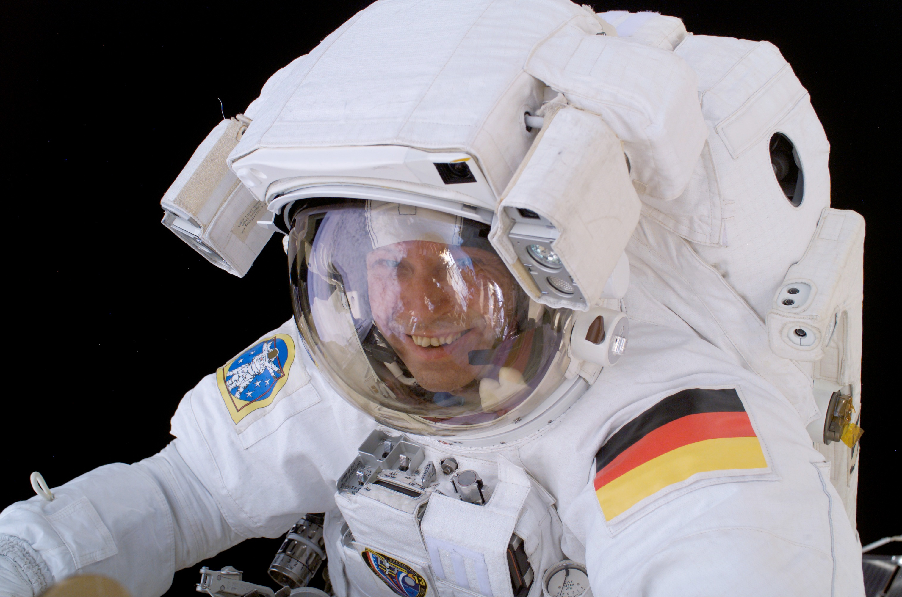

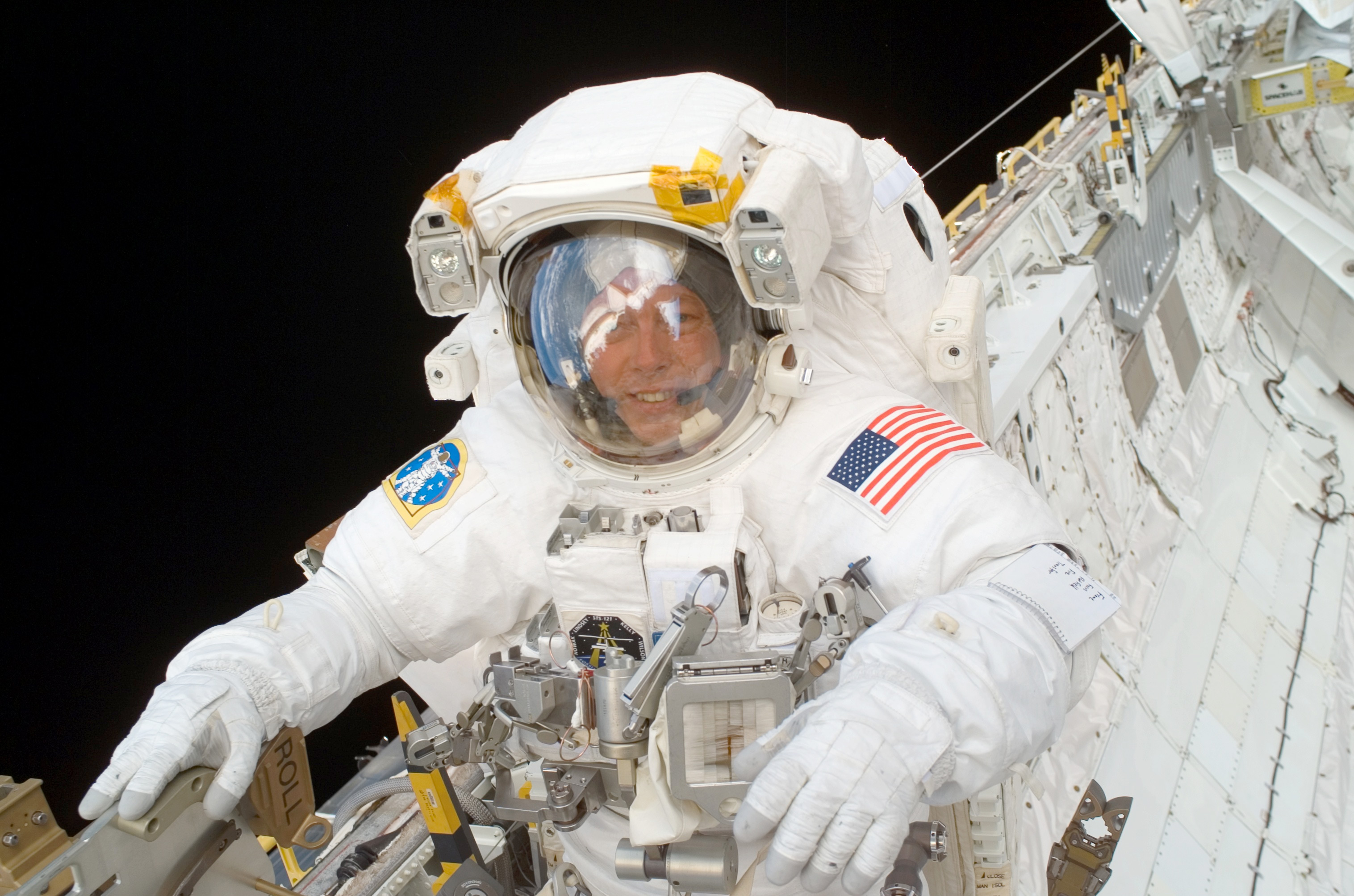

thisismills Member Posts: 263 From: Michigan Registered: Mar 2012
posted 07-08-2019 06:19 PM
Welcome to cS from one Michigan resident to another. Thanks for sharing those images, here are a few photos showing similar patches in use during EVAs and their locations on the EMU. Examples from STS-121 and Expedition 13 below.
Left Shoulder: Flag patch, nationality of astronaut. Right Shoulder: EVA patch, 'Vitruvian Spaceman'. Chest: Crew patch, Space Shuttle Mission or ISS Expedition. |
