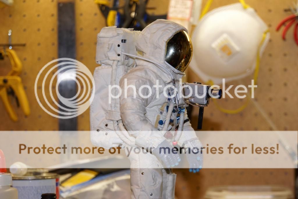

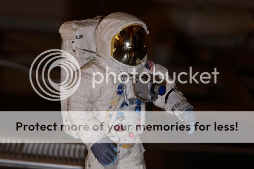

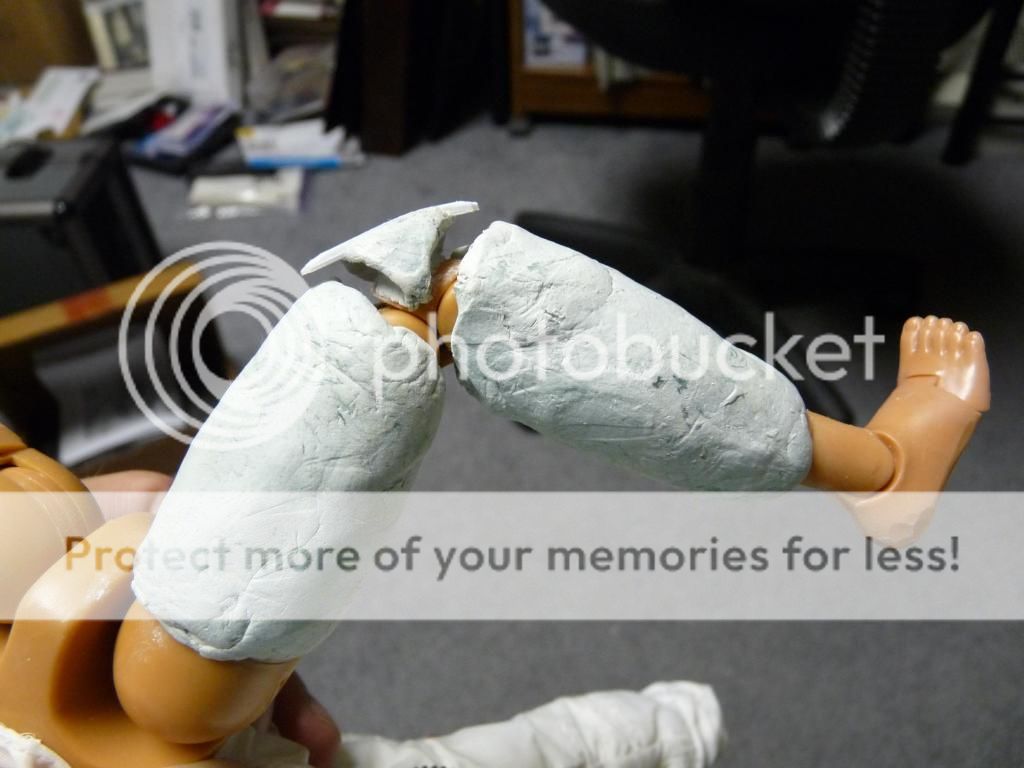

As most of you know, the 1/6 scale Dragon Apollo Astronaut is the most realistic posable astronaut figure out there. Having said that, it has many, many shortcomings. I started a project, several years ago, to make our astronaut somewhat more accurate. It's now complete. There are very few, if any, parts, pieces, or dimensions that are unchanged from their original configuration. An example of one leg is shown below. This figure can never be perfect, but I think it turned out pretty well. A before/after comparison is included. As an added benefit, his feet now include fairly strong rare earth magnets so he can be posed and won't tip over — the first two pictures were taken with him hanging from a furnace duct, and then inverted for your viewing pleasure.

Sorry for the delay in responding. I had a bit of a mishap that has made it difficult to type, but I now have 9 of 10 fingers working, so I'm pretty much back in business.Anyway, the overarching key here is to keep in mind that the real suit is not a baggy, puffy snow suit. This is probably the biggest error that I see, in both scale and full size replicas. In reality, when inflated, it is hard, rigid like a basketball, then covered with several thin layers that insulate and protect the "guts" of the suit. Think of it as a fabric covered basketball, rather than a big, saggy marshmallow. It would be difficult to describe all of the mods that were made to the Dragon astronaut and suit. But here's a list of highlights: - Shorten the thighs of the legs by 3/8", then build up the thighs and calves using epoxy putty. Doing this, and then removing some of the fabric in the suit legs makes the legs look more rigid.
- PLSS and OPS. Require considerable sewing. Both should show the shape of the hard surface underneath the fabric. On the OPS model, that large tubular device that is wrapped around the top needs to go, and then all of the snaps and flaps need to be re-sized and sewed to look more accurate. You'll also need to cut in the holes on the front corners and add the pins that were used to hold it in place in the LM. The PLSS also has a fair amount of extra fabric that needs to be cut away and then the fabric re-sewed to fit.
Also, the PLSS/OPS do not "flop" around when the suit is inflated. They and the suit essentially become a solid unit. So, the PLSS (and also the RCU) need to be firmly affixed to the suit. I used male & female anchors that allow them to be snapped in place. - Helmet. Same general principals as above. Remove the fabric, reduce the size of the LEVA underneath, and also remove the plastic "chin" (the gold visor needs to pivot much lower than the un-modified model allows). Then re-attach the fabric, which must be re-sized and sewed to fit and look correct. When it's all done, you'll need to correct the Velcro closure on the front, and then use a few strategically placed stitches to hold it down and in place.
- Hoses. Too thin, too long, and too flexible. Basically, the hoses need to be rebuilt and replaced in their entirety. Diameters, length, and placement can be best determined by looking at EVA photos. These hoses, when pressurized, are quite stiff. To make mine, I used thick copper wire, surrounded by the outer sheath of a round shoe string, and then covered with the suit fabric, correctly sized to fit. The hose fittings will also need to re-done - mis-shapen and too big.
- Gloves. Fingers too long. Shortened with exacto & dremel, then repainted using leather/vinyl paint. Gauntlets were also about 1/4" too long, shortened by sewing. The EVA checklist on the model above was built from scratch: plastic, elastic, and several layers of paper with the top layer an actual photocopy of Apollo 12 pages; and finally, extremely thin copper wire, wound in a tight spiral, for the binding.
- EVA boots. Wrong shape, toe, and sole pattern. Correcting required making new soles and toes (both left and right), reshaping and also heating the boots to make them "sag", and making new upper snaps (originals too small). You will not need the IVA boots - tucking in the extra length of the suit legs, brought about by shortening the thighs, will take up the extra space.
- Hasselblad. Magazine too long, and lens has a very odd shape. Shortened the magazine and made a new lens.
- Although you may consider this a bit creepy, before you even get started, you'll want to remove your astronaut's head. It gets in the way and serves no purpose after the LEVA is sewed in place.
As I mentioned earlier, there is no way to make this astronaut figure perfect. However, with the modifications highlighted above, as well as a plethora of revisions and tweaks, he becomes more and more realistic in appearance. If you allow it to happen, you can probably tweak on this forever; since my original post, I have become aware of several other details that will need to be fixed: shoulder pockets, left side of OPS, mechanics of OPS activation handle...Correcting this 1/6 scale Dragon astronaut has been a multi-year project, all of it trial and error. So if you're planning to correct your own Dragon figure, or even if you're embarking on another A7L suit project, I hope these pictures and descriptions will be of use. If you have any questions, or need any specifics, please do not hesitate to reply or send me an email. |
