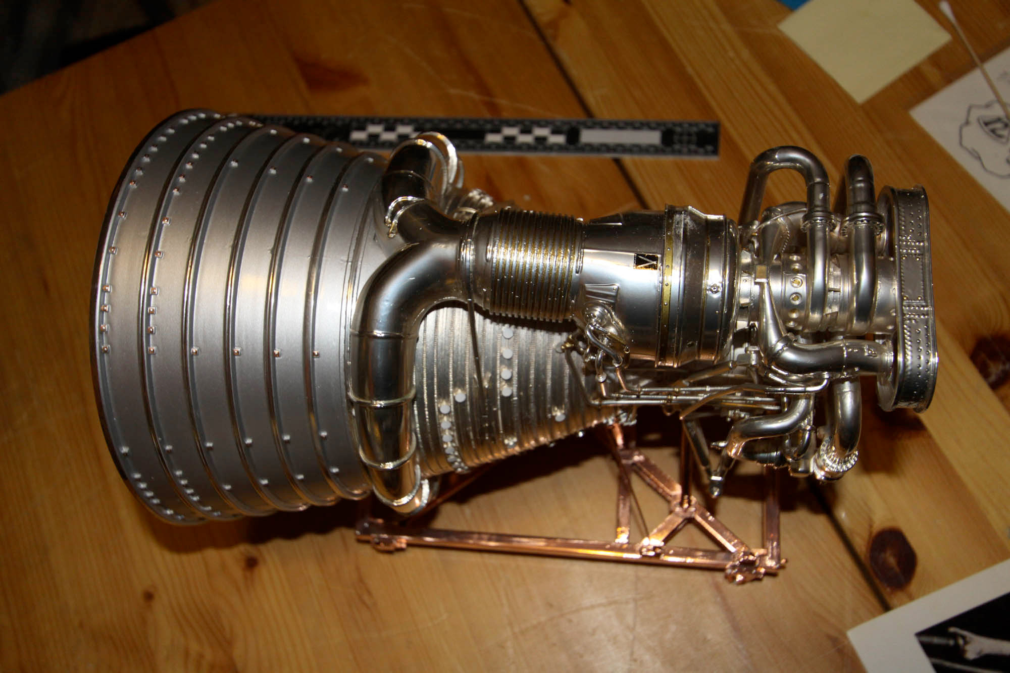

A few years ago I did a first plating silver F-1. I have done total 10 plating versions, six silver, three bronze and my last, a 24 karat gold version.

Silver and gold edition united. Models or fine art? Pascal certainly stepped it up a notch with his latest iteration.

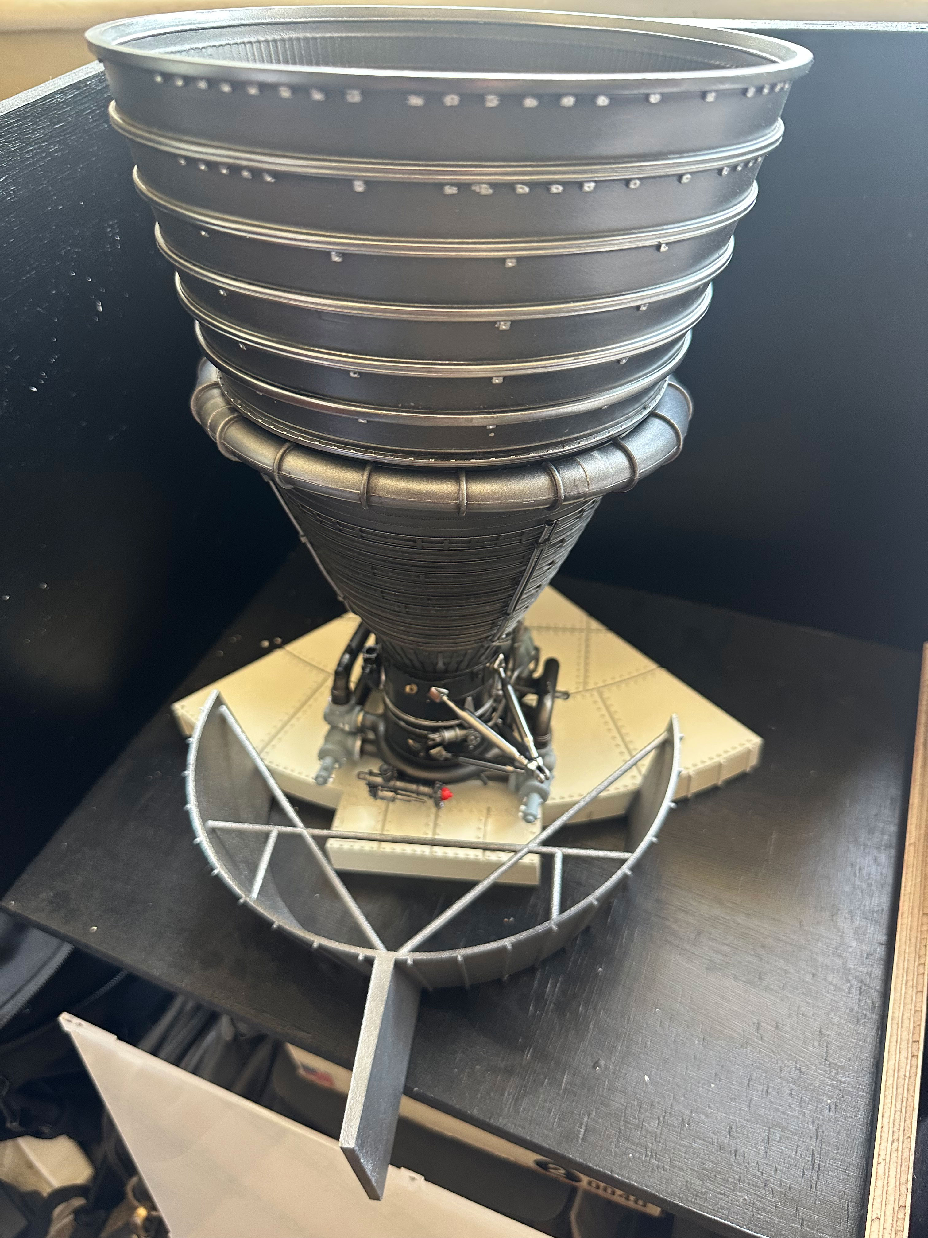

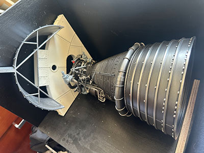

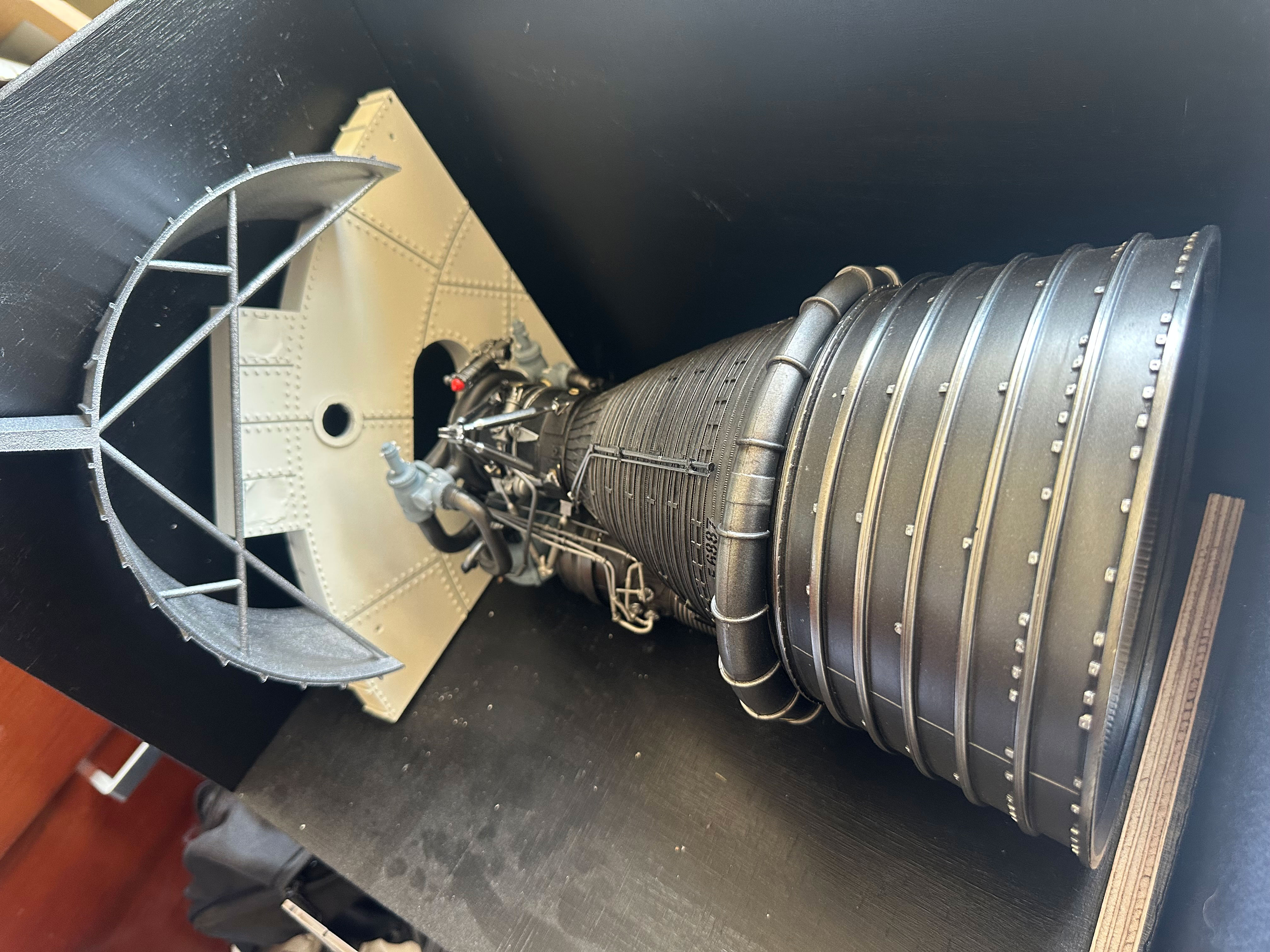

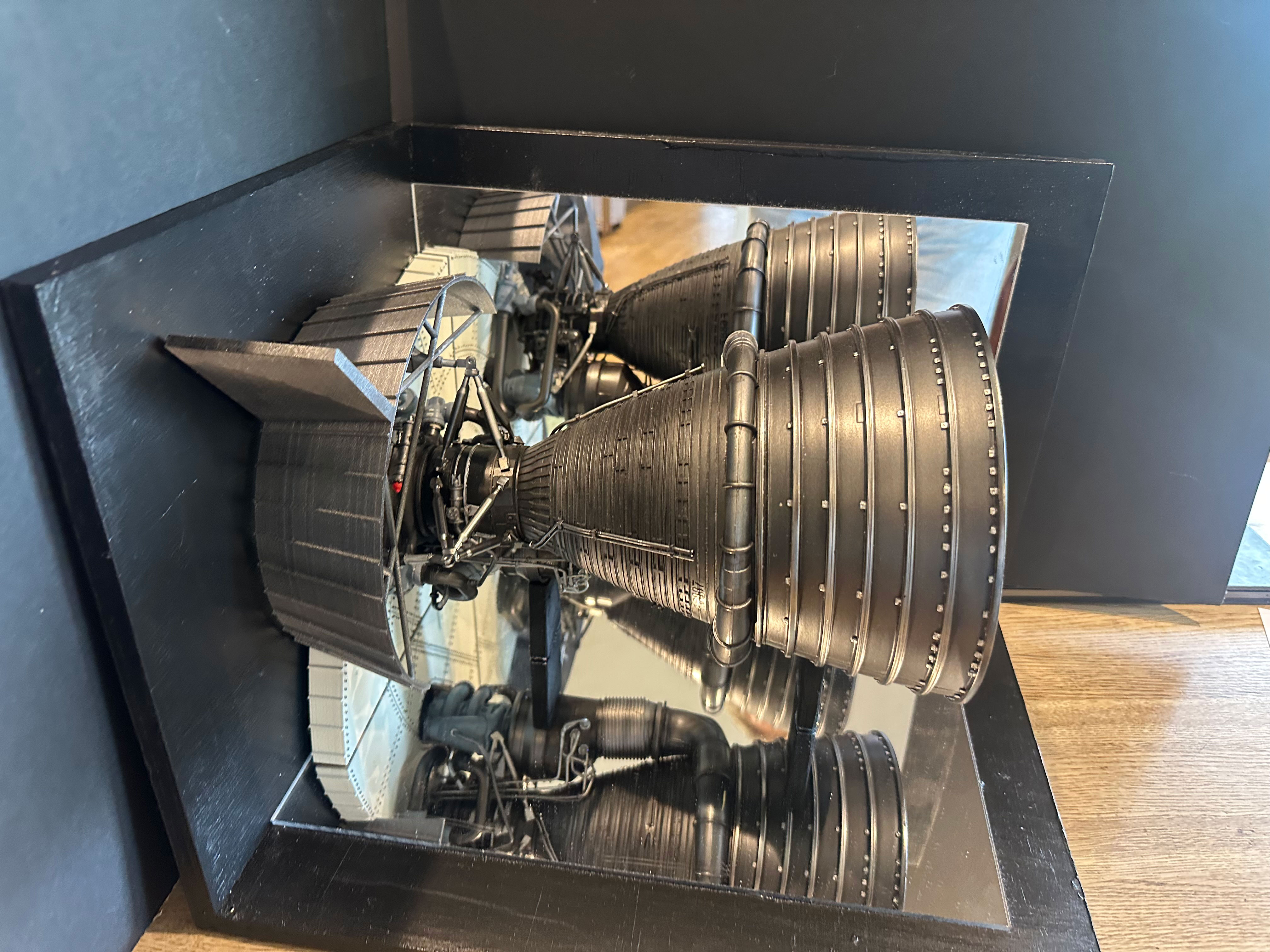

At last... I have finished the build of my Accurate Models' 1/20 scale F-1 rocket engine. One of my most complex and demanding builds.
I purchased a Saturn V base plate — it is made of PLA — to mount the engine against. It was bought from Shapeways some time ago. My intention is to mount the engine horizontally integrated into the base of the Saturn V first stage. There will be two mirrors placed behind and below my model to give an impression of being one of the five F-1 engines (inspiration came from the National Air and Space Museum).
One of the photos is shown with the engine vertical to show how it will fit together.
Having now painted the PLA Saturn V base, I am not happy with the alclad paint job and wonder if a similar base made out of a different 3D printed material might be a solution. The PLA is rather rough and alclad is not forgiving of rough surfaces.
I can't find an alternative version of the F-1 base plate on the internet so wondering if any cS members have some ideas or suggestions?

You need to sand 3D printed surfaces very, very well. So sand, fill, sand, fill. Then a few primer coats with sanding in between.
The first sanding of primer coat will show stripes, that are areas that are higher or lower (depend how you define it), keep on priming until everything is even when you hit it with a high number sanding board. Than you can start you alclad.

Use a resin printer and the will be no lines visible.

Yes, I was thinking about a resin print — the challenge is that I bought this PLSA print via Shapeways in 2020.
Unfortunately since Shapeways went bust they no longer hold the stl files and I do not know who the designer was or how I might contact them now. Anyone have any ideas on who the designed was or means of contacting them? Thanks!

If you get the files, try ABS and the Acetone vapor treatment. I did some models for a military contractor and they came out great with minimal effort. Just Google it.

This engine model is amazing. I do think mounting it the way you are describing it, is a great idea.
However, that PLA print, well, would need a lot of tweaking. Not just surface-wise, but it does not look very accurate at all. I am not a Saturn V expert, I just searched for some pics online.
Maybe you could hire somebody to model that section for you. Or talk to Accurate Models. Maybe they could release that section as a kit. Maybe even with a quarter section of the center engine to fill your mirrored display. (maybe tricky though since not all four 90 degrees section are the same).
They did an awesome job modeling the full engine. Modeling that section would be easy.
Alternatively, look for some full Saturn V model STL files out there. The PLA model you have does not seem that detailed and may actually be a section of a full rocket model.
I would just display the engine by itself. A chain is only as strong as its weakest link.

Thank you for all your ideas and recommendations. I am going to ditch the PLA and try and get a resin printed version of the Saturn V base plate.
I understand that the company that made the F-1 rocket engine has gone bust? If you know differently or have contact details then do please let me know! Thank you.

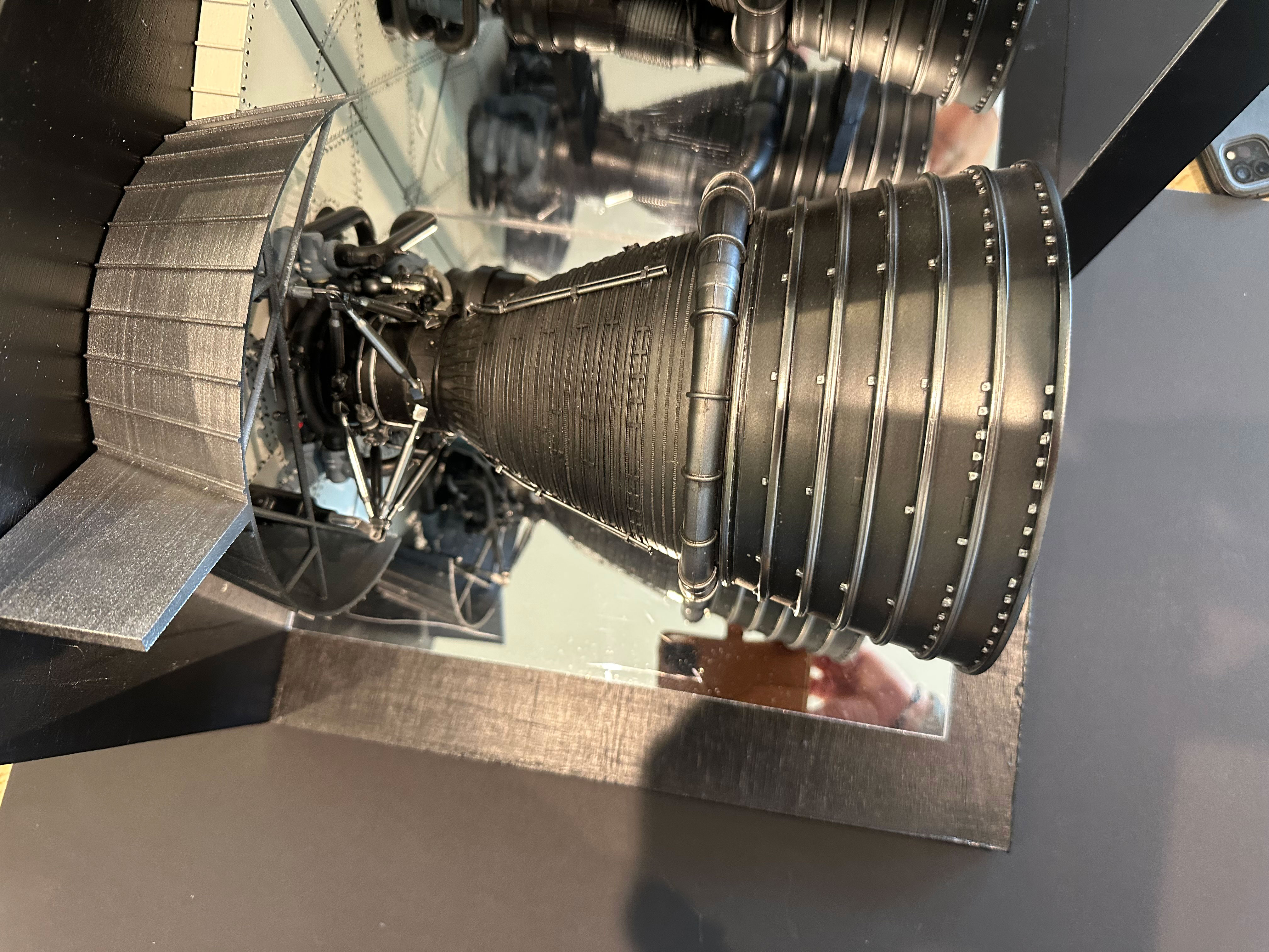

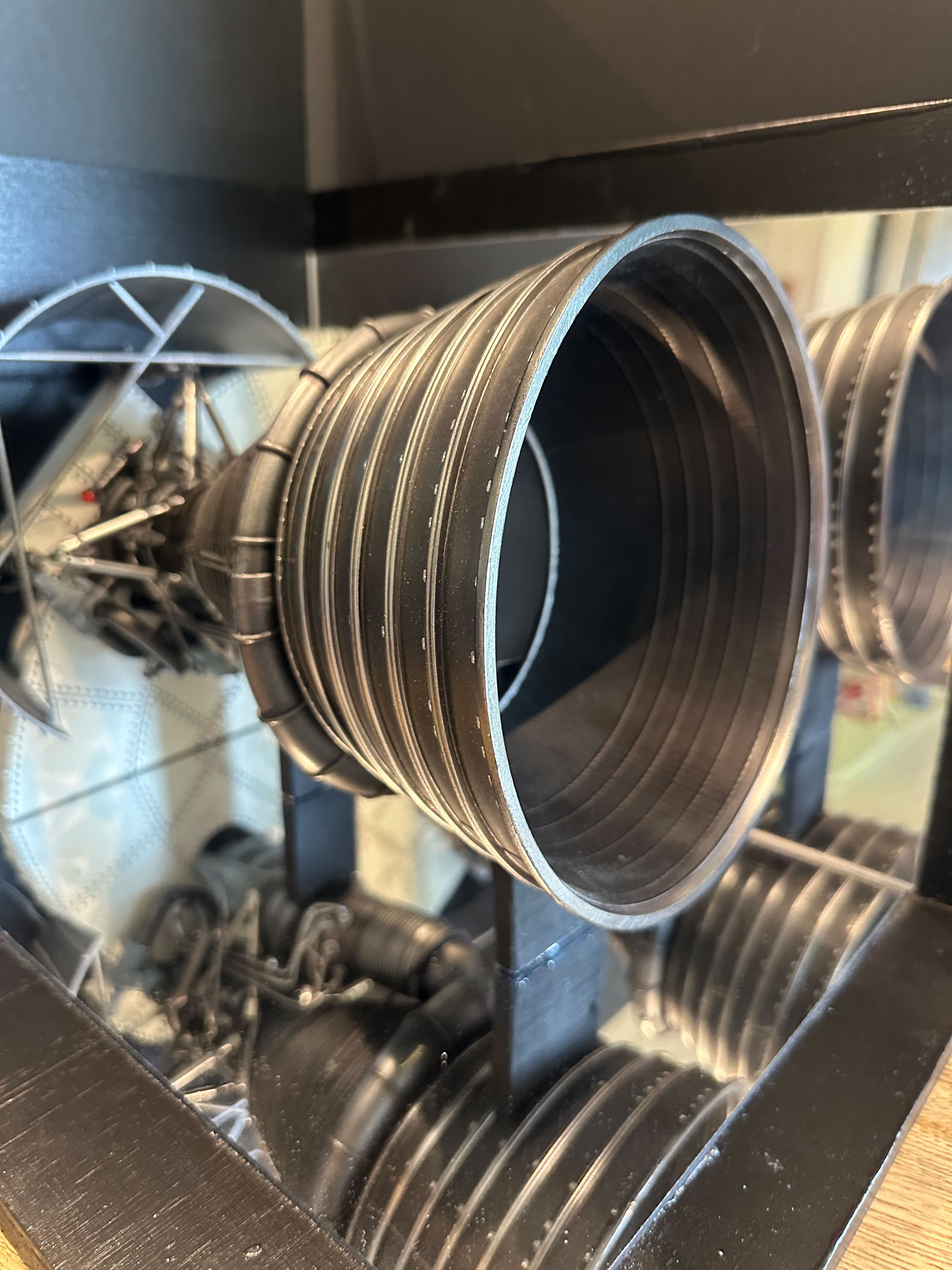

Just a quick update on the F-1 rocket engine model display. I decided to create an interim display - I was keen to see what it looked like and to give me an incentive to think about the next stage of the build.
Now I am busy looking at improving the 3D printed base of the Saturn V and finding a quarter conical section of an F-1 engine (when placed in the corner where the two mirrors meet it will complete the optical illusion of five F-1 engines).
I may try and scratch build a new base of the Saturn v but will need some detailed engineering drawings to ensure I get all the details and dimensions correct. Most likely I will start with a balsa and card prototype.
At the moment I have mounted the model horizontally and placed a mirror behind and below the engine, so it appears (when viewed at a certain angle) that the Saturn V base is complete but only has four engines. I have also scratchbuilt two actuators from a couple of highlighter pens.
Hope you like this interim display - once autumn is here I will be back modelling again!
