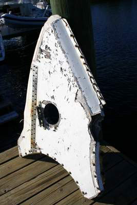

Greetings, I have found debris while beach combing in the Bahamas. It possibly appears to be from STS-74; the ODS or part of the DM. Perhaps they jettisoned the ODS/DM after undocking? The numbers are as follows:
27 77008-47 AH
MFR 32946 8/24/95
GA (or CA)
27 78321-24
CTL ??731
16/July/95
67211-27-78320
MFR 50213
67211 ASSY
27-78320-108
FL/OC4/EP/138723
What do you think? It has about a 5" porthole with spring activator. I have tracked the MFR to refer to metallurgical reports, but can't confirm mission number.

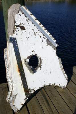

Photos of found NASA debris:

I thought is might be part of a launch vehicle fairing. What is the color of the back side?
If not a fairing, I would say that is from an aircraft.
Perhaps, but the materials are a very very high caliber and the honeycomb is also very high end. Some of the metal is mollybendullum (sp?).
Also, one set of characters, OC4, references a mission specialist (whom I've misplaced at the moment) and a mission from that era.
The other side is a mocha-brown color of a porous layer about 1/8" thick. Appears to be a thermal protection layer?
Also, the honeycombed strength section is at least 1.5" thick with 5 or 6 layers of very fine fiberglass-looking weave epoxied atop it.
After, on the outboard side, is a metallic paint (has turned greenish on the inside). The inboard side meets the brownish thermal layer.
On edit: Of course, I could be mistaken on which is the inboard/outboard orientation.

It is this color?
Matt Mason
Posts: 10
From: Nassau, The Bahamas
Registered: Mar 2013
posted 03-28-2013 12:11 PM     Click Here to See the Profile for Matt Mason     Edit/Delete Message   Reply w/Quote
Pretty close, yes. Of course it's been "weathered" pretty good.

I believe 32946 and 50213 are CAGE codes. If you dig into that you may find who made those parts.
