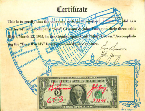

I was lucky enough to buy a GT 3 flown dollar bill and certificate recently.
The currency has come loose from the certificate.
Any suggestions as to how this should be reattached? Any general hints on conservation or preservation would also be greatly appreciated.

There are archival semi-rigid clear sleeves that hold dollar bills. Currency collectors use them. You could maybe place the dollar in one of those and then mount it on the certificate, maybe using photo corners??

If you don't like the plastic sleeve look, here is what I'd sugest as an alternative to keep the original look of the certificate. (I have a similar certificate and opted not to use a sleeve.)
The adhesive on the certificate is probably not archival. You should purchase 100% archival buffer paper (thin like bond paper) and cover just the glue area. This will create a barrier between the glue and the bill since the glue cannot be removed. You can then purchase an archival adhesive and put a small amount in each corner to adhere bill. The adhesive comes in a small container and you simple roll on a small amount. The adhesive is sticky like rubber cement but is not a liquid and can be rubbed off with a finger. The link below is where I purchase all the many archival products I use.
http://www.lightimpressionsdirect.com/servlet/OnlineShopping?Dsp=2
Remember, use a metal frame, not wood, use OP3 museum acrylic, not glass, and 100% rag mat matt board if you mat it. You will then have a museum grade piece.
