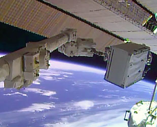

Mike Hopkins, riding the space station's Canadarm2 robotic arm, carries a spare pump module for its installation. (NASA TV)
The Christmas Eve EVA – extravehicular activity, NASA's term for a spacewalk – had the two astronauts retrieve a spare of the refrigerator-size cooling system device and install it on the station's starboard, or right, side backbone truss. The 780-pound (355 kg) pump module replaced a malfunctioning unit Mastracchio and Hopkins successfully and speedily removed three days ago.

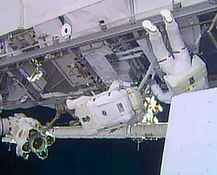

Mike Hopkins, hidden behind the refrigerator-size pump module, rides on the end of the space station's robotic arm. (NASA TV)
Trading spaces since their Saturday spacewalk, Hopkins, riding the end of the robotic arm, and Mastracchio working alongside him, retrieved the spare pump module from the space station's External Stowage Platform 3 (ESP-3) and installed it in the slot on the truss they earlier emptied of the faulty unit.
"Mike, I think you're in charge now of the pump module," Japanese astronaut Koichi Wakata radioed Hopkins as he controlled the arm to pull Hopkins and the pump module away from ESP-3. "It looks good, you're doing a great job, it looks beautiful."
The pump module was bolted into place at 9:08 a.m. CST (1508 GMT), three hours and 15 minutes into the EVA.

The astronauts then worked on connecting five electrical and four fluid lines linking the new module to the station's systems. In the process, the pair had difficulty freeing one of the quick disconnect lines from a temporary jumper box that the two had installed during Saturday's spacewalk.
"One thing we never expected," Mastracchio observed.
"Getting it off the jumper box?" Hopkins replied.
"Yeah," Mastracchio said.
The spacewalkers eventually freed the stubborn line using some additional tools. In the process, they released some frozen ammonia flakes, or "snow."
"About one little snowflake a second," Mastracchio stated to Mission Control, adding that the flakes were contacting both his and Hopkins' suits, a concern for contamination
"Big chunks, big chunks," Mastracchio noted as Mission Control sent a command to vent the fluid line. "Some little ones, some big ones."
As the line was vented, the spacewalkers confirmed it had "stopped snowing" and they proceeded with connecting it and the remaining lines to the new pump module. All nine lines were connected at 11:45 a.m. CST (1645 GMT), five hours and 52 minutes into the spacewalk.
