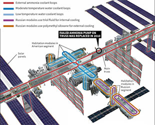

On Wednesday, one of the two pumps used to circulate ammonia coolant on the outside of the space station shut down after lower than normal temperatures were detected. The shutdown cut off half of the space complex's ability to regulate the temperatures for both its internal and external systems. [SPACE.com: How the Space Station's Cooling System Works (Infographic)]

"The ETCS [External Thermal Control System] Loop A is still running but the flow control valve doesn't appear to be positioning properly, so the Loop A is very cold," radioed McCullough around noon EST on Wednesday. "We are not expecting [the loop] to get warm enough for us to be able to reintegrate [Loop A] for heat rejection."
Infographic illustrating how the International Space Station (ISS) cooling (thermal control) system works. (SPACE.com/Karl Tate)

Meanwhile, the space station's more critical systems are being cooled by Loop B, which is still functioning normally.
"All the thermal loops have been shifted to Loop B, which is struggling to keep up, so we are going to be looking at some additional power downs in other modules to make sure that the highest priority loads get adequate cooling," McCullough told the crew.
Ground controllers are continuing to troubleshoot the issue overnight, according to a statement on NASA's website. If the valve issue turns out to be a hardware problem, it may require astronauts go outside the station at some point to replace the pump module with a spare unit.
The affected 780-pound (355 kilogram) pump module was last replaced by station astronauts in August 2010 during three contingency spacewalks, the result of a similar Loop A coolant system shutdown. In that situation however, the pump module itself had failed rather than the control of a valve, as currently suspected.
