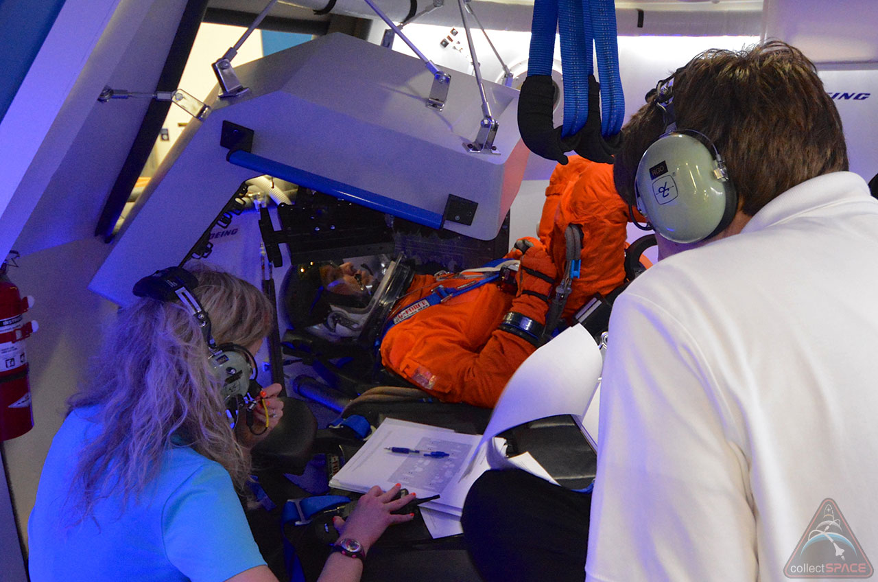

"It's an upgrade," says Serena Aunon, taking the capsule for a test fit. "It is an American vehicle, of course it is an upgrade."

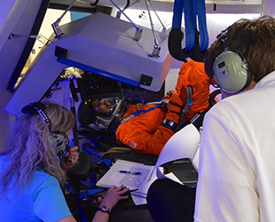

NASA astronaut Randy Bresnik, wearing a shuttle-era Advanced Crew Escape Suit (ACES) pressure suit, takes part in a fit check inside Boeing's CST-100 space capsule mockup. (collectSPACE)

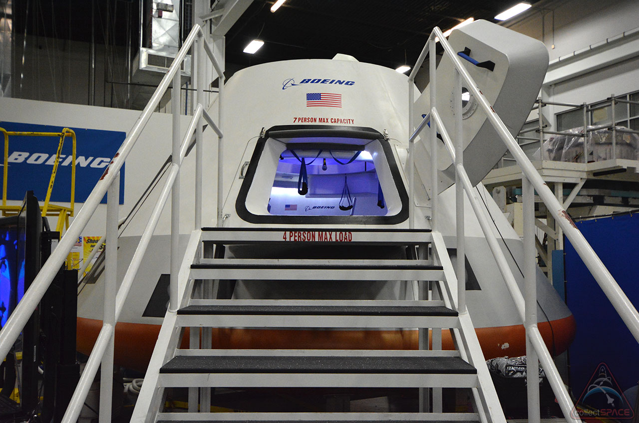

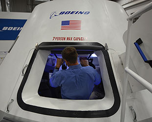

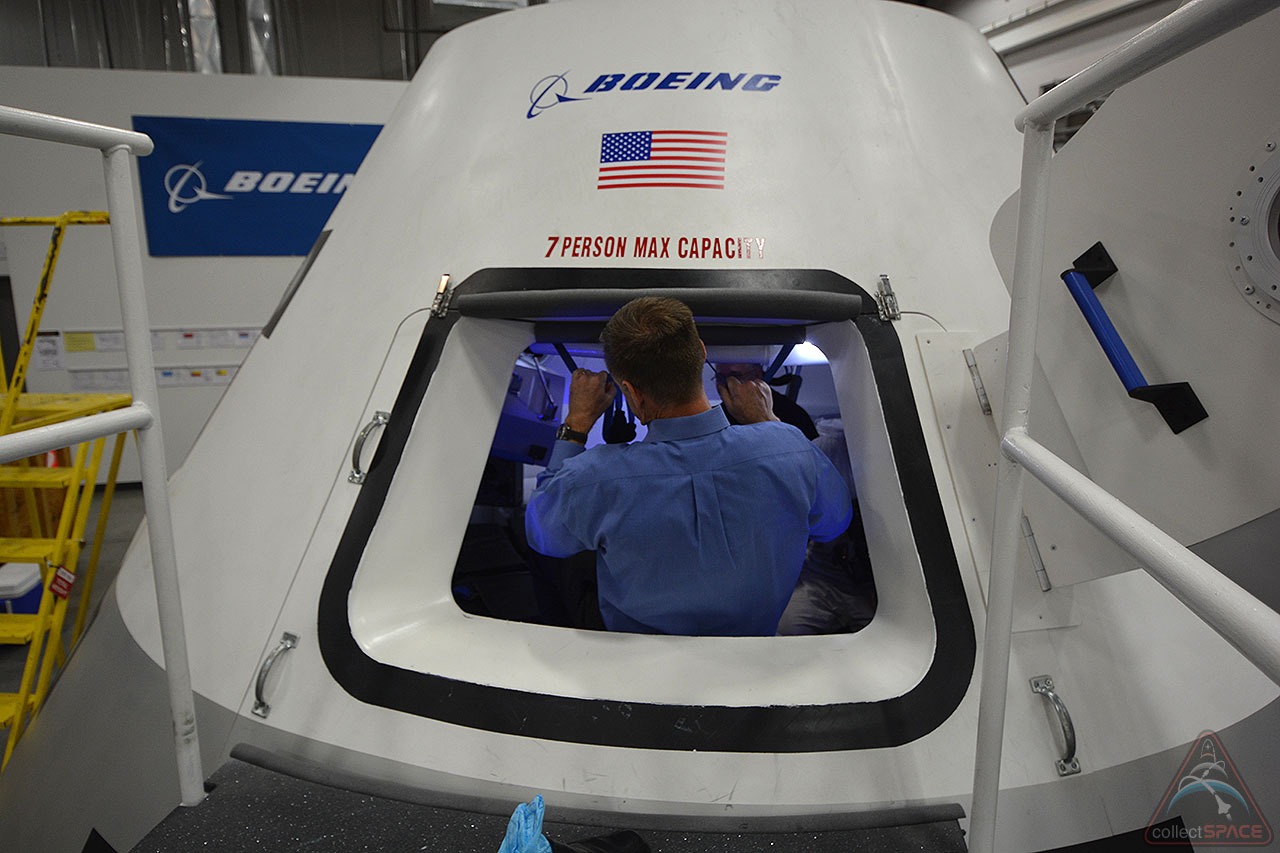

Boeing's CST-100 mockup, which the company revealed on July 22, 2013, seats up to seven crew members. (collectSPACE)
I know it has been three years, but what you do not see behind this [model capsule's] façade, are the hundreds of engineers who are working to put code behind the displays and who are working on the flight controls who are going to have a vehicle we're going to be able to fly in simulation mode here in four-to-six months.
What is amazing me more than anything about being part of the Boeing team is the depth going into every decision — and I am still amazed on how much left we have to do. We are by no means there, but it's like playing 'whack-a-mole' — when the next problem comes up, we put a team on it, make a decision and move forward. It is just great to work like this.

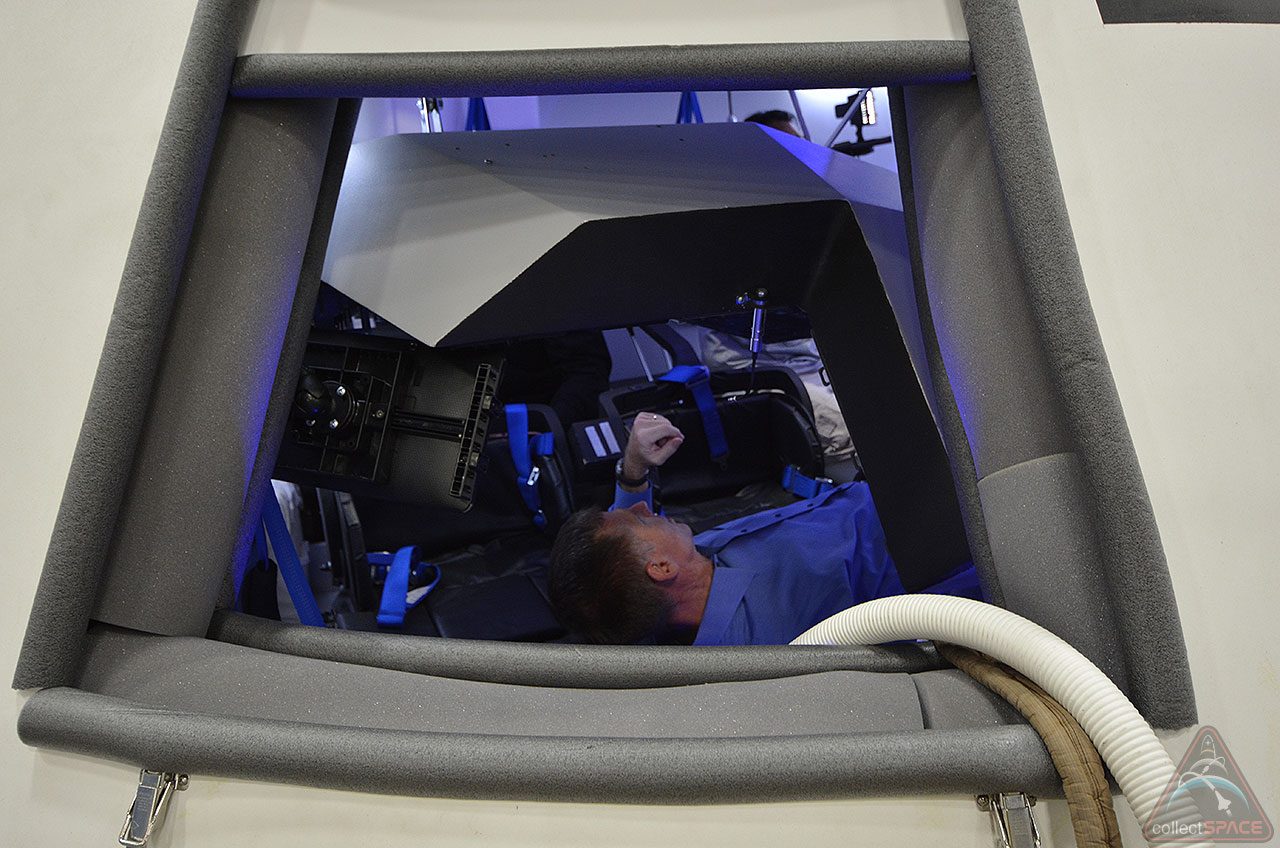

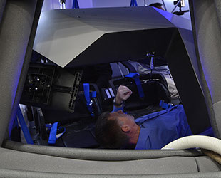

Former shuttle commander and Boeing commercial crew director Chris Ferguson climbs into the CST-100 capsule. (collectSPACE)
Here, we are going to dock [at the space station] within 24 hours. We're going to dock within 24 hours on a normal mission and six hours after undock, we are going to be on the ground. So it's almost a paradigm shift for those who were brought up on the shuttle mantra of 'Hey, I have to provide for meal time, I have to provide a restroom facility' — which we're going to provide, because you just have to do, but do you have to do it like we did aboard the shuttle? Probably not.
If everything goes well, you're not going to be a passenger in this vehicle in flight for more than 18 hours. We want to dock on flight day one, we have to dock within 24 hours. So this is a lot more Soyuz-like and if you had to compare the internal volume of the Soyuz in cubic feet per person, I think we've got them beat pretty well.
