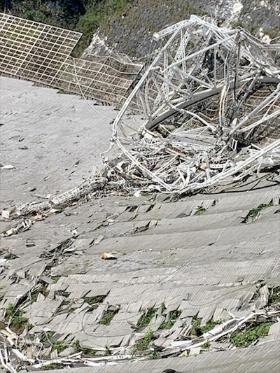

Photo of the aftermath from NotiCel:

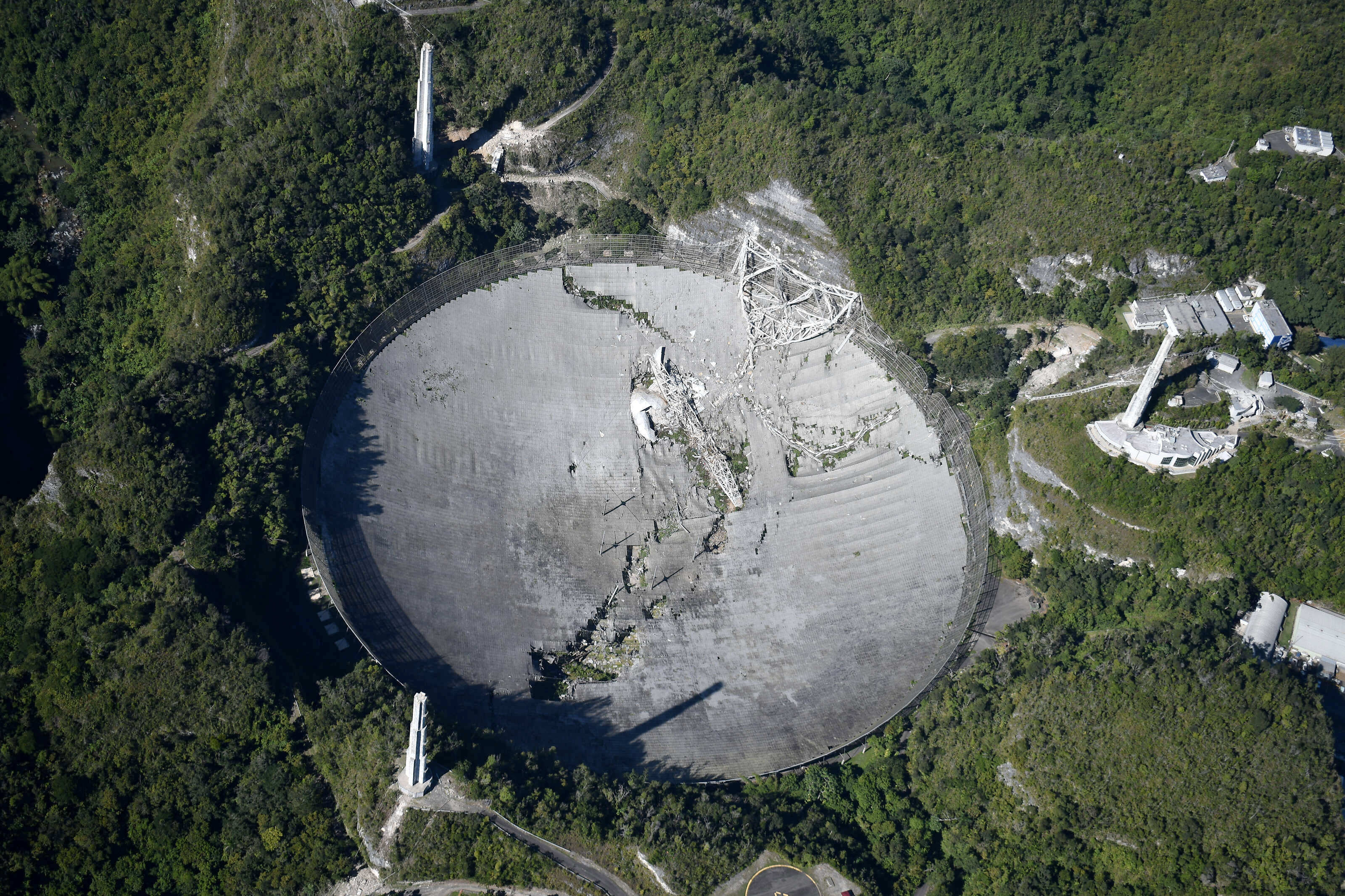

Arecibo Observatory's 305-meter telescope suffers collapse
The instrument platform of the 305-meter telescope at Arecibo Observatory in Puerto Rico fell at approximately 7:55 a.m. Atlantic Standard Time Dec. 1, resulting in damage to the dish and surrounding facilities.
No injuries were reported as a result of the collapse. The U.S. National Science Foundation ordered the area around the telescope to be cleared of unauthorized personnel since the failure of a cable Nov. 6. Local authorities will keep the area cordoned off as engineers work to assess the stability of the observatory's other structures.
Top priorities are maintaining safety at the site, conducting a complete damage assessment as quickly as possible, and taking action to contain and mitigate any environmental damage caused by the structure or its materials. While the telescope was a key part of the facility, the observatory has other scientific and educational infrastructure that NSF will work with stakeholders to bring back online.
"We are saddened by this situation but thankful that no one was hurt," said NSF Director Sethuraman Panchanathan. "When engineers advised NSF that the structure was unstable and presented a danger to work teams and Arecibo staff, we took their warnings seriously and continued to emphasize the importance of safety for everyone involved. Our focus is now on assessing the damage, finding ways to restore operations at other parts of the observatory, and working to continue supporting the scientific community, and the people of Puerto Rico."
The investigation into the platform's fall is ongoing. Initial findings indicate that the top section of all three of the 305-meter telescope's support towers broke off. As the 900-ton instrument platform fell, the telescope's support cables also dropped.
Preliminary assessments indicate the observatory's learning center sustained significant damage from falling cables.

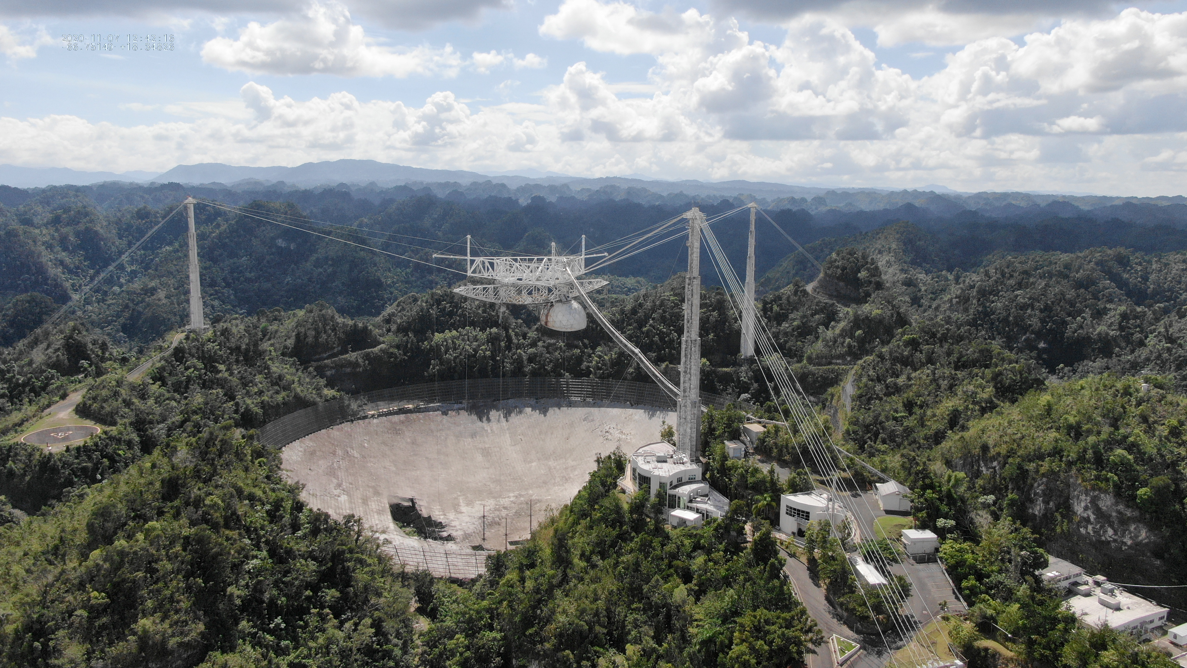

This video, which starts with a view of the top of Tower 4, was taken from the vantage point of an Arecibo Observatory drone, utilized for monitoring the condition of Tower 4 support cables. Four cables are seen in the center of this video. The top cable does not support the telescope platform, but instead supports the catwalk described in the narrative for the previous video.
The three lower cables are, from left to right, M4-1, M4-2, and M4-3. Note that a number of individual wire strands of the M4-1 and M4-2 cables are noticeably broken at the beginning of this video. The M4-3 cable does not appear to have any broken wires at the beginning of this video.
The first indication of the coming failure is the breaking of another M4-2 wire, accompanied by a puff of "smoke" and chips of paint flying away from the surface of the cable. Four seconds later the entire M4-2 cable appears to disintegrate. The failure of M4-2 is followed a fraction of a second later by the demise of M4-1, followed a fraction of a second later by the failure of M4-3.
The drone operator then swings the drone around to view the reflector dish and fallen platform, azimuth arm, Gregorian dome and the falling cables and catwalk. The top section of Tower 12, near the Visitor Center, can be seen tumbling down the hill to the left of the operations building. The Tower 12 backstay cables that connect the top of Tower 12 to the ground cause damage behind Tower 12, well away from the edge of the telescope dish.
