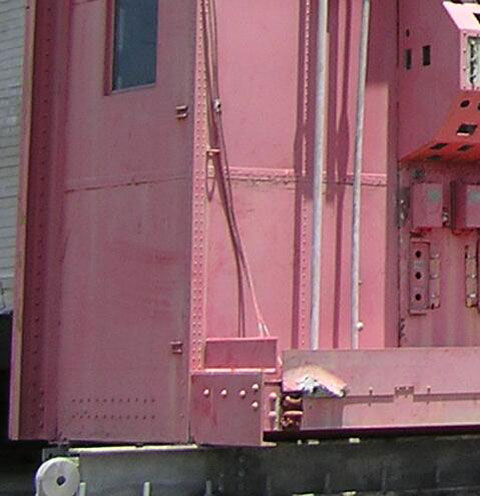

We have seen a number of historic launch towers on the Florida coast destroyed due to corrosion. Not directly, but the towers of Complex 34, 13, 14 the Apollo LUT all were taken down due to the amount of corrosion and the fact they became unsafe. This area is considered an adverse environment for structures such as these because of corrosion, so much so that NASA has a corrosion test area situated between Pad 39A and Complex 37 on the beach (I saw the sign for the test are while on the Then & Now Tour at KSC. This led our engineer group to use it for an evaluation of one of our assemblies).

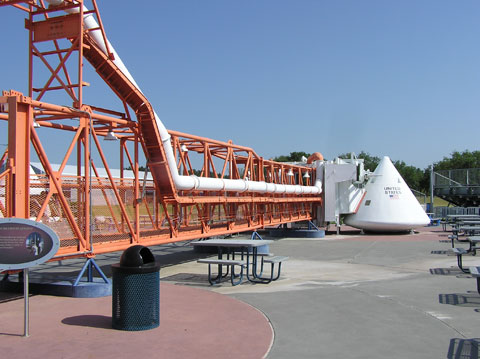

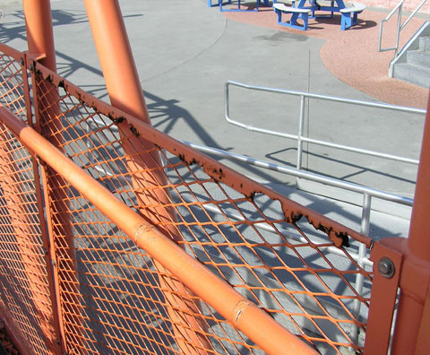

So what does this have to do with this group of spaceflight enthusiasts? There are a number of artifacts that are stored outside in this environment due to their size. The ones that come to mind immediately are those vehicles/assemblies in the Kennedy Space Center rocket park. The Apollo LUT swing arm and the Saturn 1B are the two items that are just not replaceable. The other spacecraft in the Rocket Park have counter parts in other museums but are also examples of our space history.
If it was up to me I would move the Apollo LUT swing arm that is currently in the Rocket Park at KSC, to the Saturn V building and get in out of the elements. That piece of history is currently corroding away just like the Saturn 1B beside it (see the photos below). A building could then be built around the Saturn 1B much like was done to the Saturn V at JSC for restoration. This building could be built to sufficient size to house other large artifacts and get them out of the weather. The Saturn 1B could be restored and saved before it comes apart at its corroded seems.

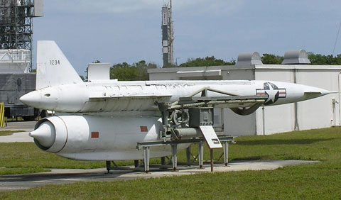

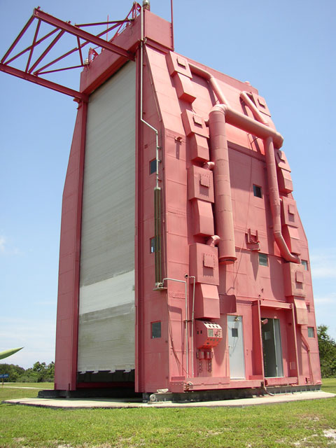

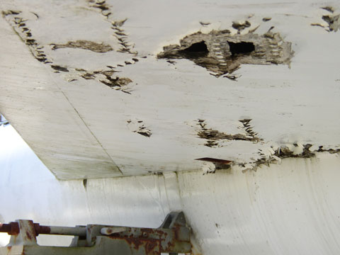

Another area of concern is at the Air Force Space & Missile Museum at Cape Canaveral. There are a number of historic vehicles that are in dire need of restoration and the preservation. These spacecraft are sitting in this wet salt environment and are literally rotting away. Below is a photo of a Hound Dog missile, there are plants growing in the edges of the wing/fuselage attach areas as well as mold all over it. The part that is of greatest concern is a six inch diameter area where the exfoliation corrosion has produced a hole in the wing. I expect to go there and see the wing on the ground sometime. The Complex 19 Clean Room from the Gemini launches is stored there but it also has large areas of corrosion and if left unattended will become too difficult to salvage.
