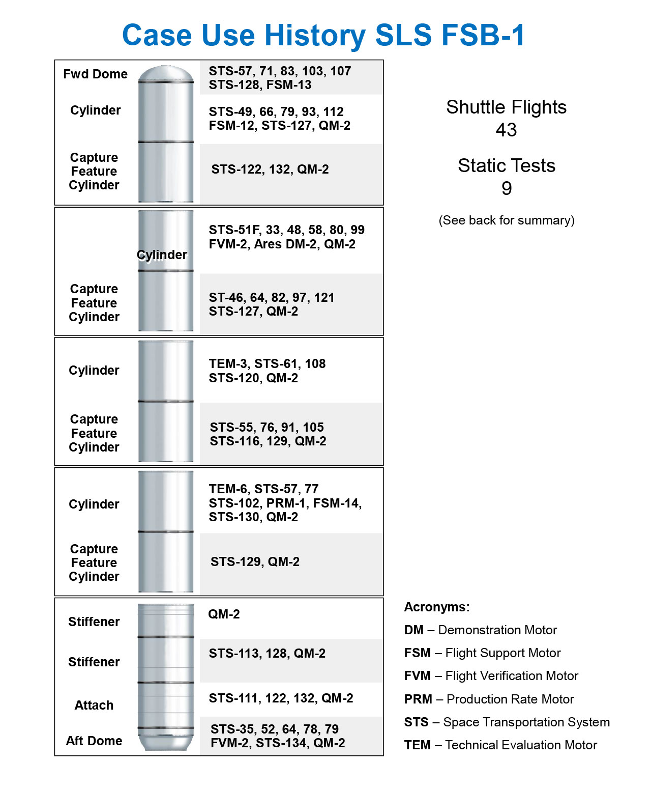

  • The FSB-1 motor is 154 feet in length and 12 feet in diameter
  • The nozzle is 12.7 feet in diameter.
  • The test will have more than 302 channels of data recorded.
  • The motor weighs 1.6 million pounds and will produce 3.6 million pounds max thrust.

  • Target propellant mean bulk temperature of 60 +10/-0 deg F
  • Demonstrate nozzle forward exit cone housing that was incorporated on Artemis II (post demonstration objective)

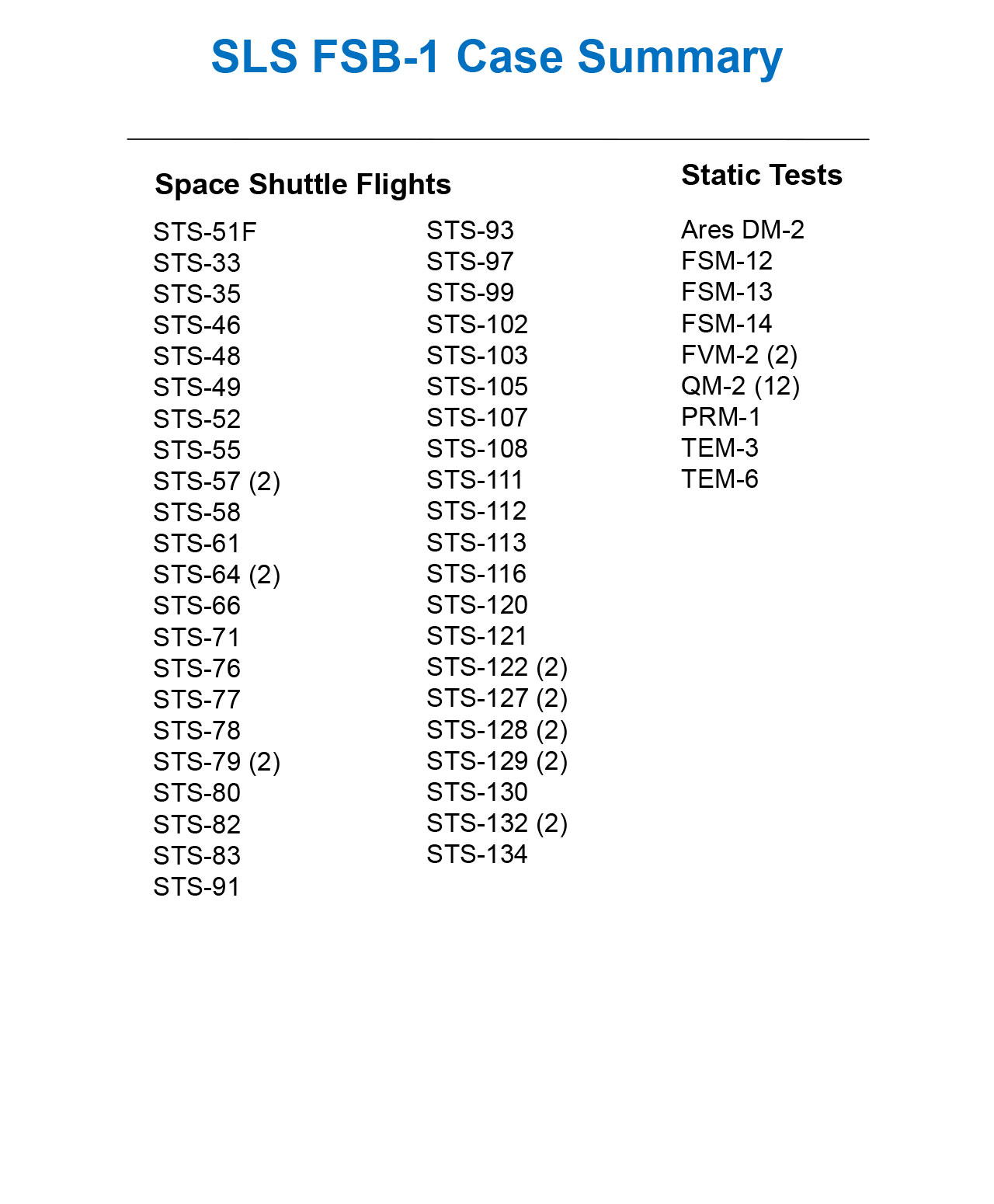

NASA and Northrop Grumman have previously completed three development motor tests and two qualification motor tests. Today's test, called Flight Support Booster-1 (FSB-1), builds on prior tests with the introduction of propellant ingredients from new suppliers for boosters on SLS rockets to support flights after Artemis III.

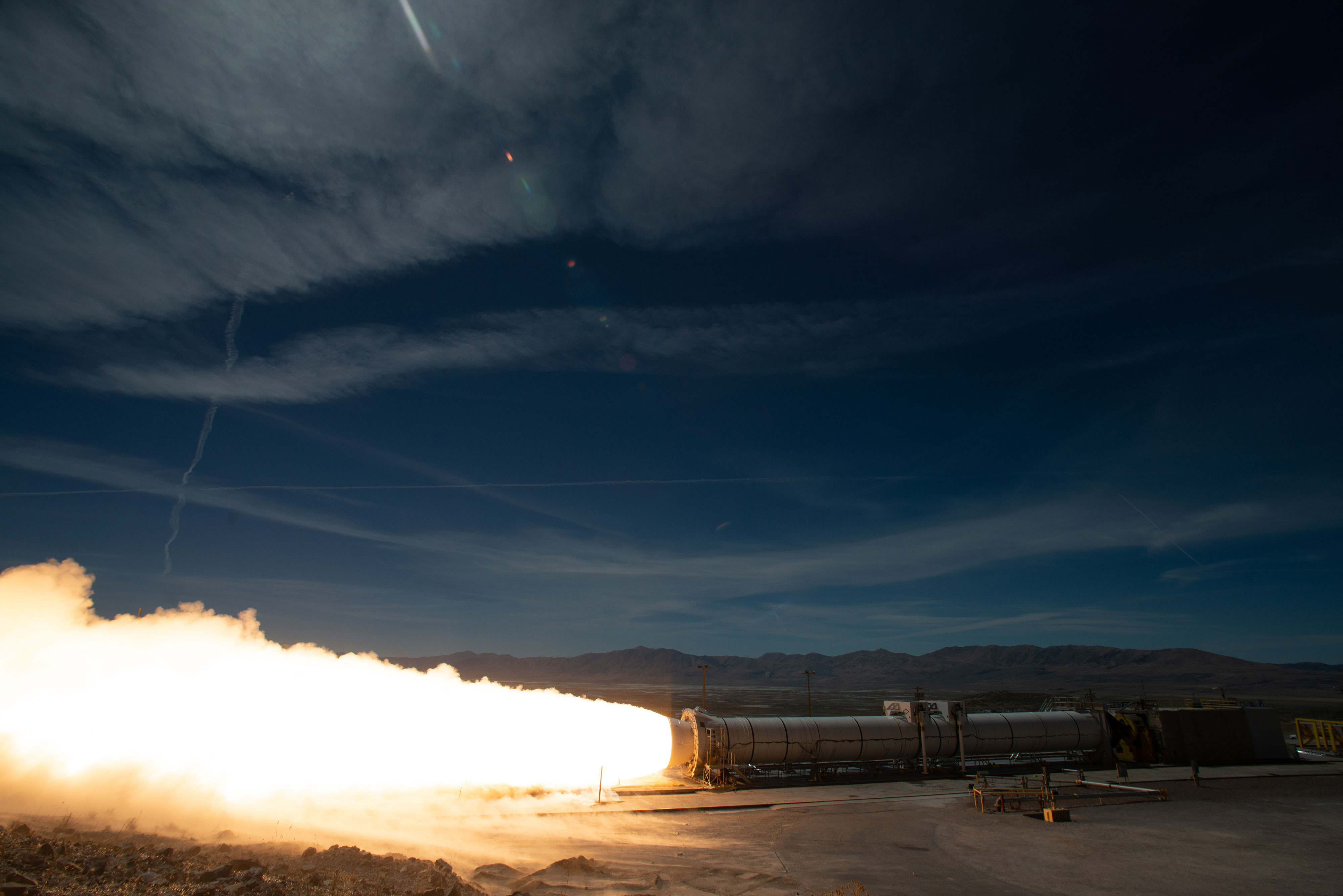

NASA and Northrop Grumman Corporation (NYSE: NOC) have successfully conducted a full-scale static fire test of NASA's Space Launch System (SLS) rocket motor, known as Flight Support Booster (FSB-1), in Promontory.
Above: NASA and Northrop Grumman successfully conducted a full-scale static fire test of NASA's Space Launch System (SLS) rocket motor, known as Flight Support Booster (FSB-1), in Promontory, Utah, on Sep. 2. During the test, the 154-foot-long, five-segment rocket motor fired for just over two minutes, producing 3.6 million pounds of thrust.
During the test, the 154-foot-long, five-segment rocket motor fired for just over two minutes, producing 3.6 million pounds of thrust. Two SLS boosters will provide more than 75 percent of the initial thrust for an SLS launch.

Prior to this test, NASA and Northrop Grumman conducted a series of ground tests beginning in 2010 to satisfy requirements for certification of the booster. FSB-1 evaluated ballistic parameters and performance of propellant materials from new sources, an upgrade to enable the booster to meet the high performance demands of SLS.
