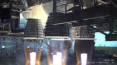

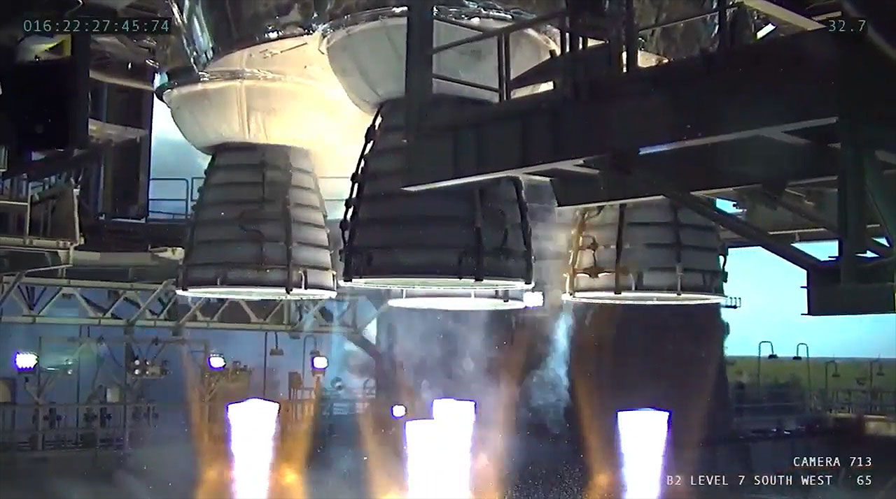

The planned 485-second hot fire lasted about 60 seconds before an early shutdown. Prior to the test, Boeing SLS program manager John Shannon said that at least 250 seconds were needed for the test to be a success.
Just before the shutdown, there was a call out of an "MCF on engine 4," though all four engines appeared to be still firing (at the time). From former space shuttle flight diretor Wayne Hale (via Twitter):
Well MCF was not a call this ascent flight director ever wanted to hear: Major Component Failure is detected by the SSME controller.

posted 01-17-2021 01:20 AM     Click Here to See the Profile for OV-105   Click Here to Email OV-105     Edit/Delete Message   Reply w/Quote
Don’t know if it is the lighting but the exhaust on the right engine in the photo doesn’t look as clean as the others, wonder if that is any indication.

Update from NASA Administrator Jim Bridenstine (via Twitter):
T-0 time at 5:27 p.m. EST, lasting 67.2 seconds. Engine ignition at 6 seconds prior to T-0, in sequence about 120 milliseconds apart.
Core stage and engines in good shape.

From a NASA update released today:
During gimballing, the hydraulic system associated with the core stage's power unit for Engine 2, also known as engine E2056, exceeded the pre-set test limits that had been established. As they were programmed to do, the flight computers automatically ended the test. The specific logic that stopped the test is unique to the ground test when the core stage is mounted in the B-2 test stand at Stennis. If this scenario occurred during a flight, the rocket would have continued to fly using the remaining CAPUs to power the thrust vector control systems for the engines.
During the test, the functionality of shutting down one CAPU and transferring the power to the remaining CAPUs was successfully demonstrated. This gimballing test event that resulted in shutting down the CAPU was an intentionally stressing case for the system that was intended to exercise the capabilities of the system. The data is being assessed as part of the process of finalizing the pre-set test limits prior to the next usage of the core stage...
Initial data indicate the sensor reading for a major component failure, or MCF, that occurred about 1.5 seconds after engine start was not related to the hot fire shutdown.

NASA will conduct a second Green Run hot fire test as soon as the fourth week of February.
The Green Run team scrutinized data from the first hot fire test and determined that a second hot fire lasting approximately at least 4 minutes would provide significant data to help verify the core stage is ready for flight.
