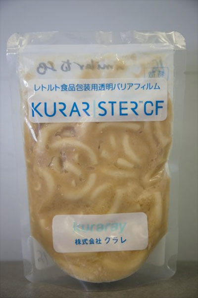

Adding a metal oxide coating to a layer of the plastic film significantly increases the amount of time it takes for oxygen and other gases to break through.
The metal oxide coating technology has been around for almost 10 years, but it develops cracks when subjected to sterilization processes. That eventually compromises the food shelf-life, said Sablani, a professor in WSU's Department of Biological Systems Engineering. WSU researchers have been working with packaging companies to develop new films that keep oxygen and vapor out longer.
The packaging films are made up of multiple layers of different plastics. These few-micron thin layers have different purposes, like being a good barrier, good for sealing, good mechanical strength, or good for printing, Sablani said.
"We are excited that an over-layer of organic coating on metal oxide helped protect against microscopic cracks," he said. "Multiple layers of metal oxide coating have also increased the barrier performance. Our research guided development of newer high barrier packaging."

Above: Mac and cheese in the new plastic packaging from WSU.
