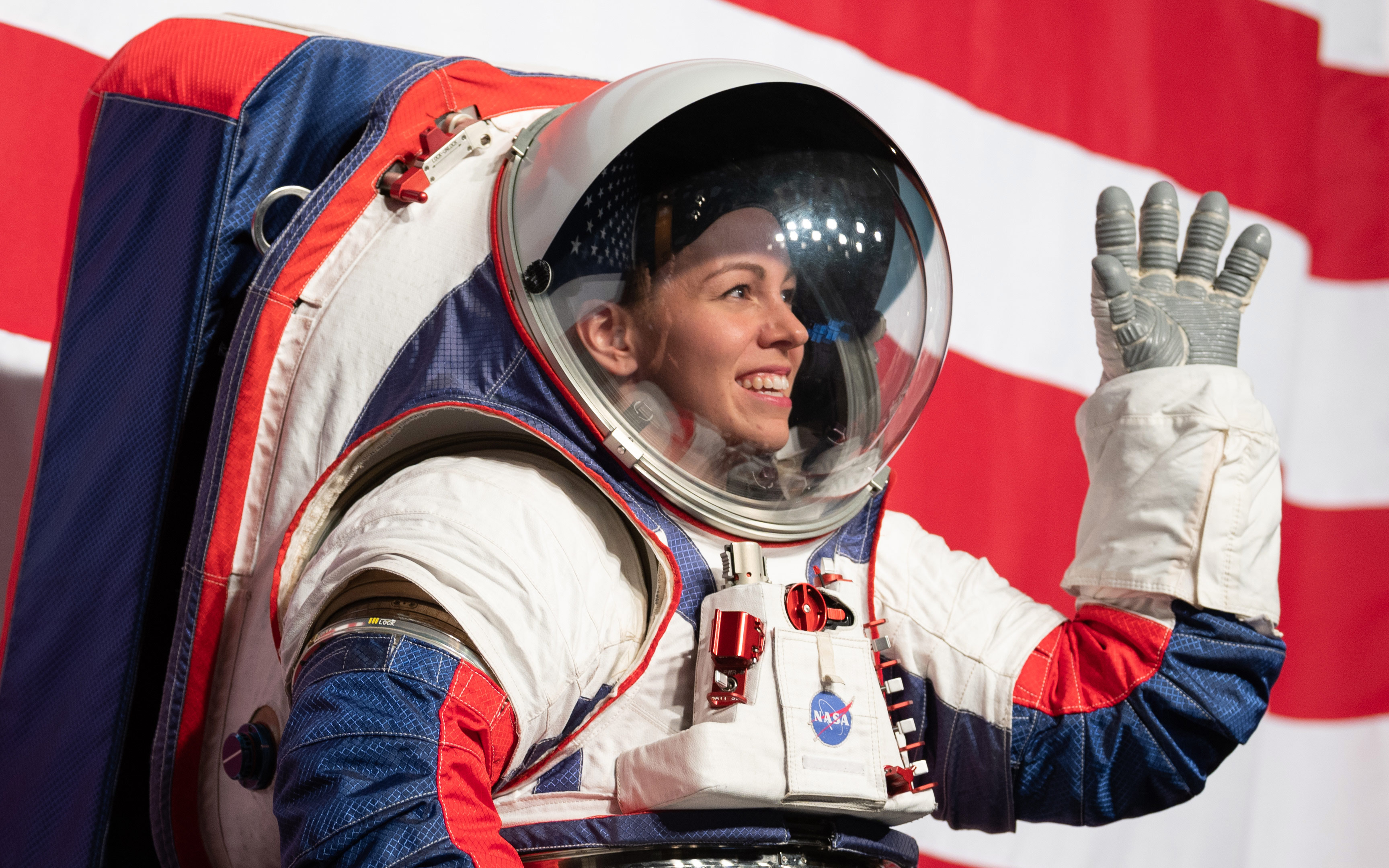

The new suit that will be worn on Artemis missions is called the Exploration Extravehicular Mobility Unit, or xEMU for short. Its history is a tale of engineering evolution, traced all the way back to the Mercury space suits that were, themselves, upgraded Navy high-altitude flight suits. Here’s a rundown of the 21st century upgrades for the suit that the next moonwalkers will wear on Artemis missions:

Artemis astronauts will be more nimble than ever before with mobility enhancements in the new suits. Bunny-hopping Apollo astronauts are fun to watch, but the exertion required to move around that way was more than NASA would have liked for their explorers who were 250,000 miles from home. The pressure garment is the human shaped portion of the spacesuit that enables astronaut mobility and protects their body from the external environment including, extreme temperatures, radiation, micrometeoroids, and reduced atmospheric pressure. The primary components of the pressure garment are the upper torso, helmet, lower torso and cooling garment.
The new lower torso includes advanced materials and joint bearings that allow bending and rotating at the hips, increased bending at the knees, and hiking-style boots with flexible soles. On the upper torso, In addition to the updated shoulder placement, other shoulder enhancements allow astronauts to move their arms more freely and easily lift objects over their heads or reach across their body in the pressurized suit. Apollo shoulder mobility was enabled by pleats in the fabric with cable pulleys that provided mechanical advantage to move the shoulders up and down but limited the ability to rotate the joint. The new shoulders minimize the effort required for full mobility and include bearings that allow full rotation of the arm from shoulder to wrist.
