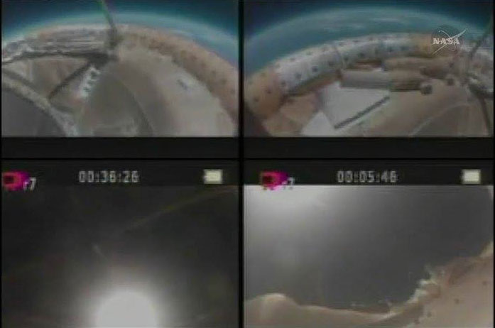

When the craft reached its target altitude and was traveling at about Mach 4, it successfully deployed the first of the new technologies, a doughnut-shaped tube called the Supersonic Inflatable Aerodynamic Decelerator (SIAD). The SIAD decelerated the vehicle to about Mach 2.5.
The LDSD test vehicle then attempted to deploy the Supersonic Disk Sail Parachute — the largest supersonic parachute ever flown — but it did not fully unfurl.

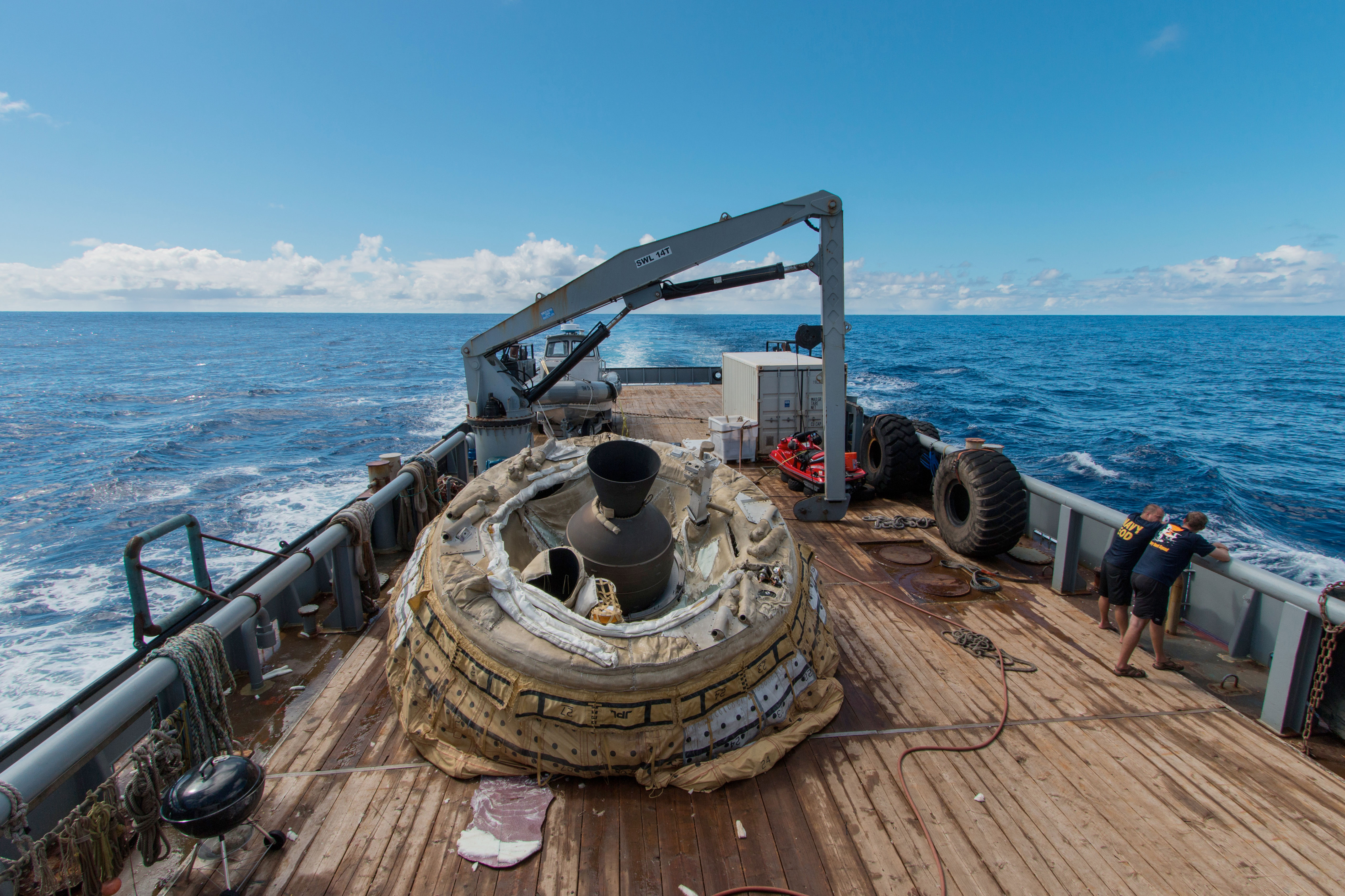

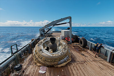

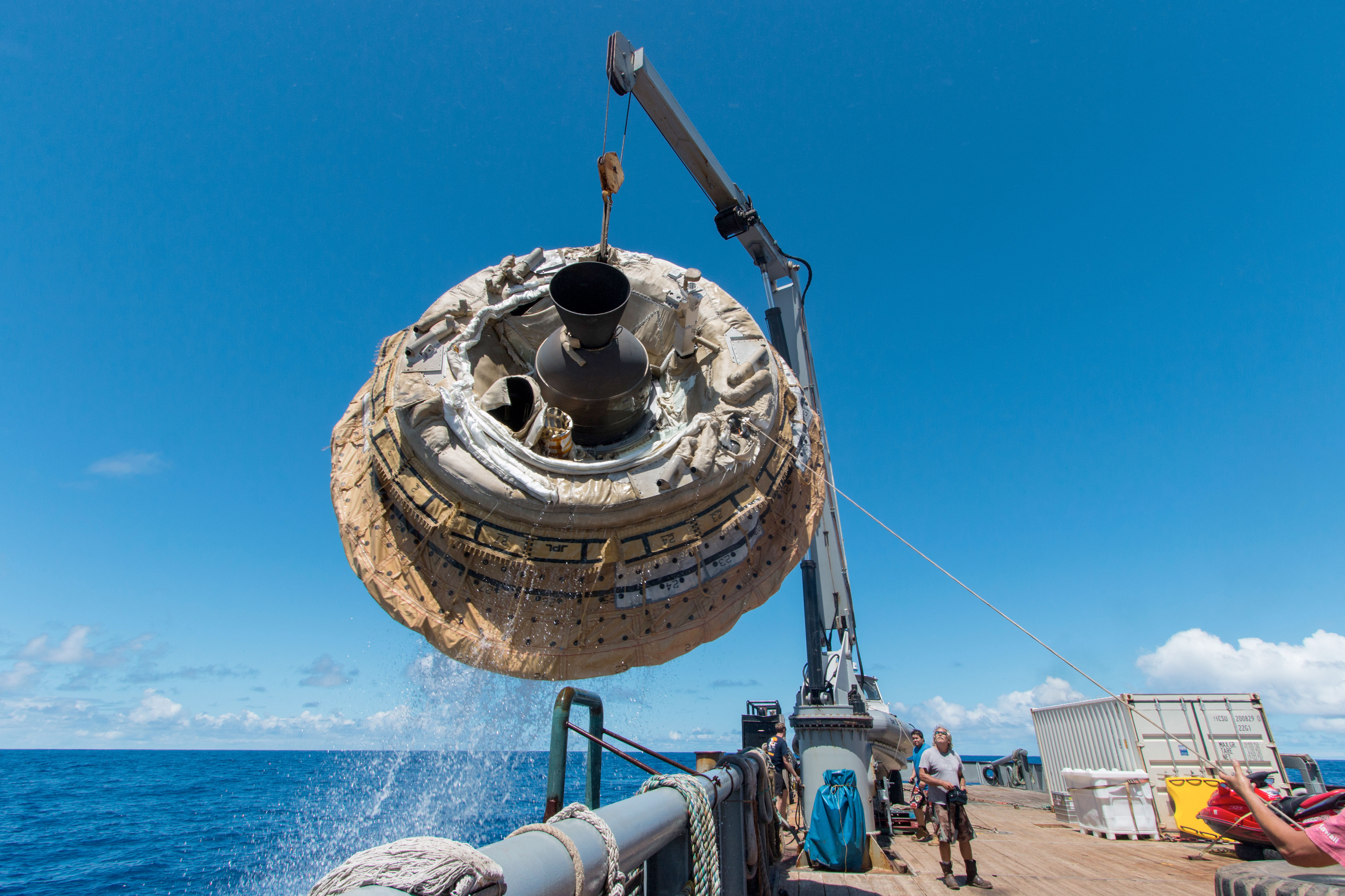

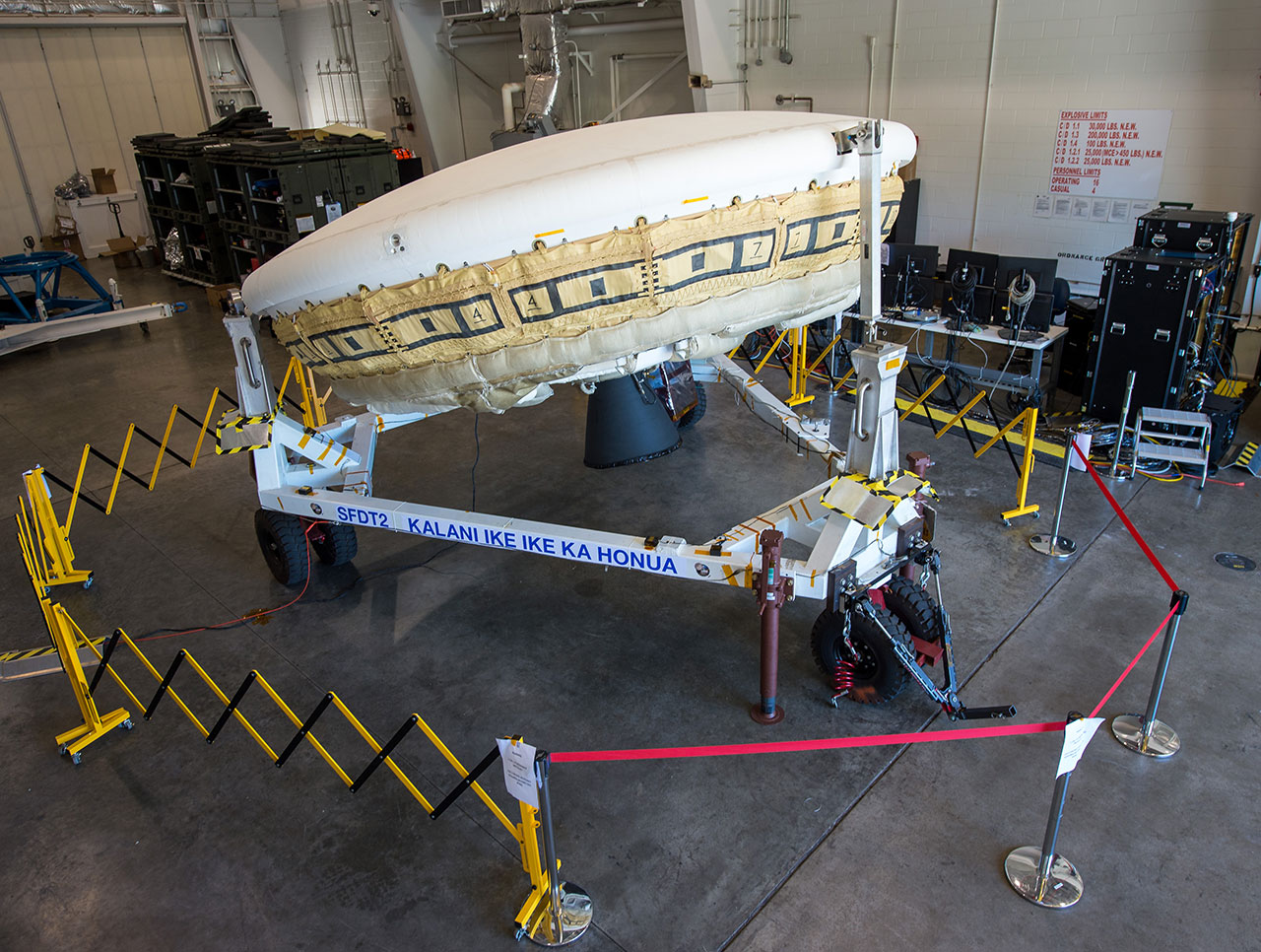

Above: Hours after the June 28, 2014, test of NASA's Low-Density Supersonic Decelerator over the U.S. Navy's Pacific Missile Range, the saucer-shaped test vehicle is lifted aboard the Kahana recovery vessel. Credit: NASA/JPL-Caltech
"We are thrilled about yesterday's test," said Mark Adler, project manager for LDSD at NASA's Jet Propulsion Laboratory in Pasadena, California. "The test vehicle worked beautifully, and we met all of our flight objectives. We have recovered all the vehicle hardware and data recorders and will be able to apply all of the lessons learned from this information to our future flights."

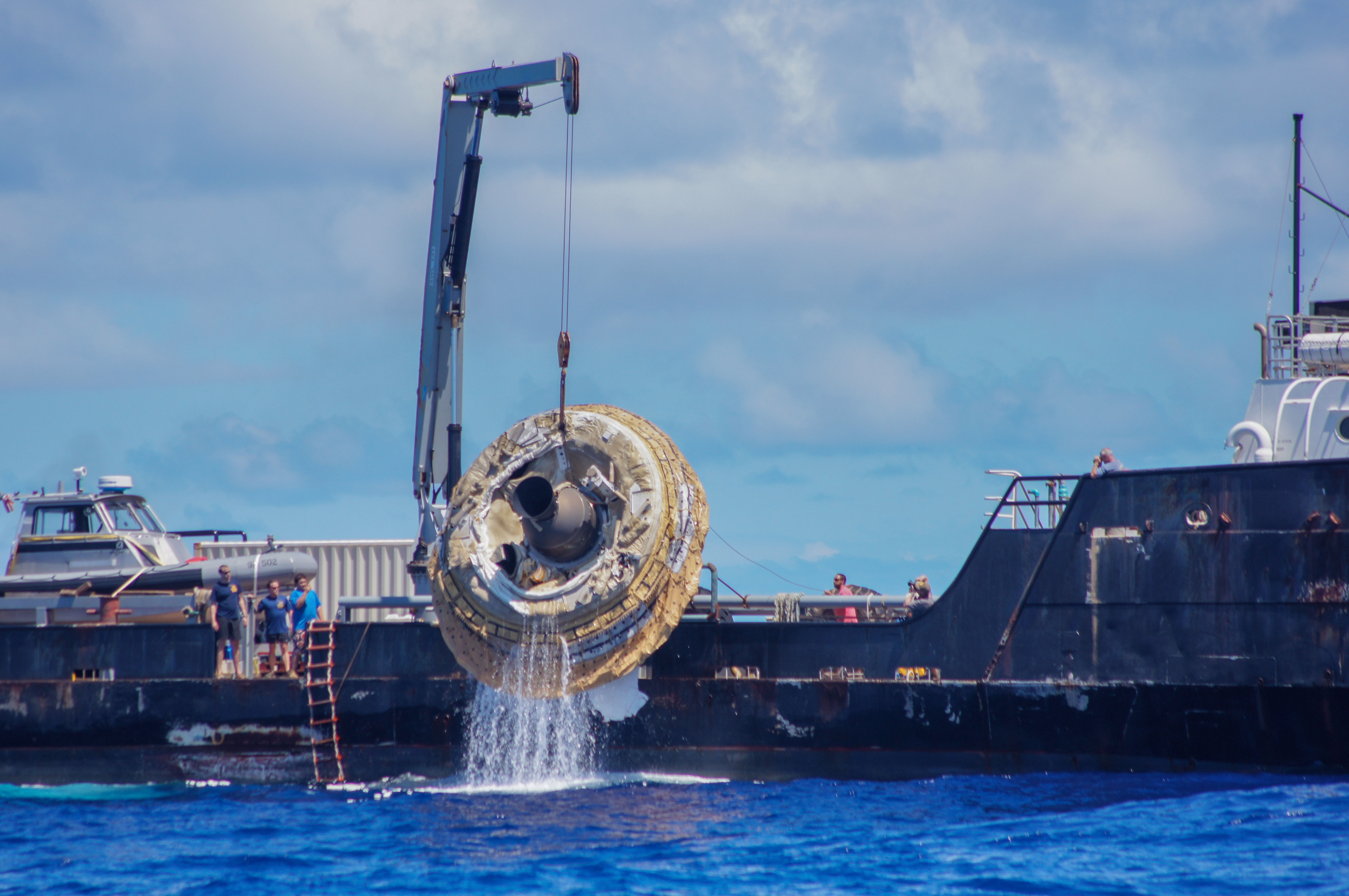

Engineers are poring over the data following the second experimental landing technology test of NASA's Low-Density Supersonic Decelerator (LDSD) project. The saucer-shaped LDSD craft splashed down at 11:49 a.m. HST (5:49 p.m. EDT) Monday in the Pacific Ocean off the west coast of the Hawaiian island of Kauai.
