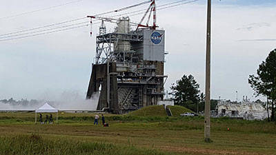

Posts: 50516
posted 07-15-2016 08:27 AM     Click Here to See the Profile for Robert Pearlman   Click Here to Email Robert Pearlman     Edit/Delete Message   Reply w/Quote
A 650-second test fire of an RS-25 engine at Stennis Space Center on Thursday (July 14) shut down early due to a problem with the test stand.
Today at 5:57 p.m. (CST) RS-25 developmental engine number 0528 initiated a test firing. There was a minor issue with the test stand that triggered an early shutdown of the test. The test systems in place responded properly by shutting down the test in an orderly fashion.
