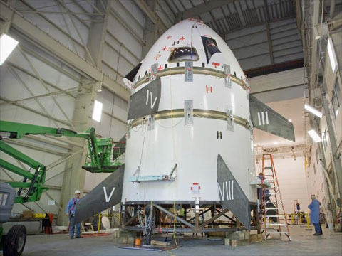

NASA photo release
NASA successfully demonstrated an alternate system for future astronauts. The launch of the Max Launch Abort System, or MLAS, took place on July 8, 2009, at 6:26 a.m. at NASA's Wallops Flight Facility, Wallops Island, Va.
The unpiloted launch tested an alternate concept for safely propelling a future spacecraft and its crew away from a problem on the launch pad or during ascent. The MLAS consists of four solid rocket abort motors inside a bullet-shaped composite fairing attached to a full-scale mockup of the crew module.
The 33-foot-high MLAS vehicle was launched to an altitude of approximately one mile to simulate an emergency on the launch pad. The flight demonstration began after the four solid rocket motors burned out. The crew module mockup separated from the launch vehicle at approximately seven seconds into the flight and parachuted into the Atlantic Ocean.

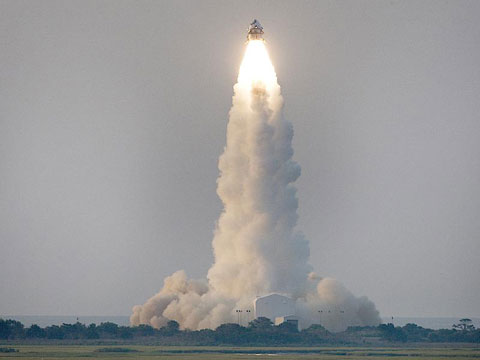

NASA release
NASA Tests Alternate Launch Abort System For Astronaut Escape
NASA has successfully demonstrated an alternate system for future astronauts to escape their launch vehicle. A simulated launch of the Max Launch Abort System, or MLAS, took place Wednesday morning at 6:26 a.m. at NASA's Wallops Flight Facility, Wallops Island, Va.
The test demonstrated a number of things: the unpowered flight of the MLAS along a stable trajectory; reorientation and stabilization of the MLAS; separation of the crew module simulator from the abort motors; and stabilization and parachute recovery of the crew module simulator. An important objective of the test was to provide the workforce of NASA's Engineering and Safety Center, or NESC, with experience in flight testing a spacecraft concept. NESC leads the project at NASA's Langley Research Center in Hampton, Va.
NASA has chosen another launch abort system, known as the LAS, for the Orion spacecraft. The system has a single solid launch abort motor in a tower mounted at the top of the launch vehicle stack of the Orion and Ares I rocket. The LAS will be capable of automatically separating the spacecraft from the rocket at a moment's notice to make possible a safe landing. Orion, part of a new spacecraft system NASA's Constellation Program is developing, is undergoing design reviews in preparation for flying astronauts to the International Space Station in 2015 and, later, to the moon.
Data from today's MLAS pad abort test could help NASA in several ways. MLAS is the first demonstration of a passively-stabilized launch abort system on a vehicle in this size and weight class. It is the first attempt to acquire full-scale aero-acoustic data -- the measurement of high loads on a vehicle moving through the atmosphere at high velocity -- from a faired capsule in flight. The test is also the first to demonstrate full scale fairing and crew module separation and collect associated aerodynamic and orientation data. In addition, data from the parachute element will help validate simulation tools and techniques for Orion's parachute system development.
