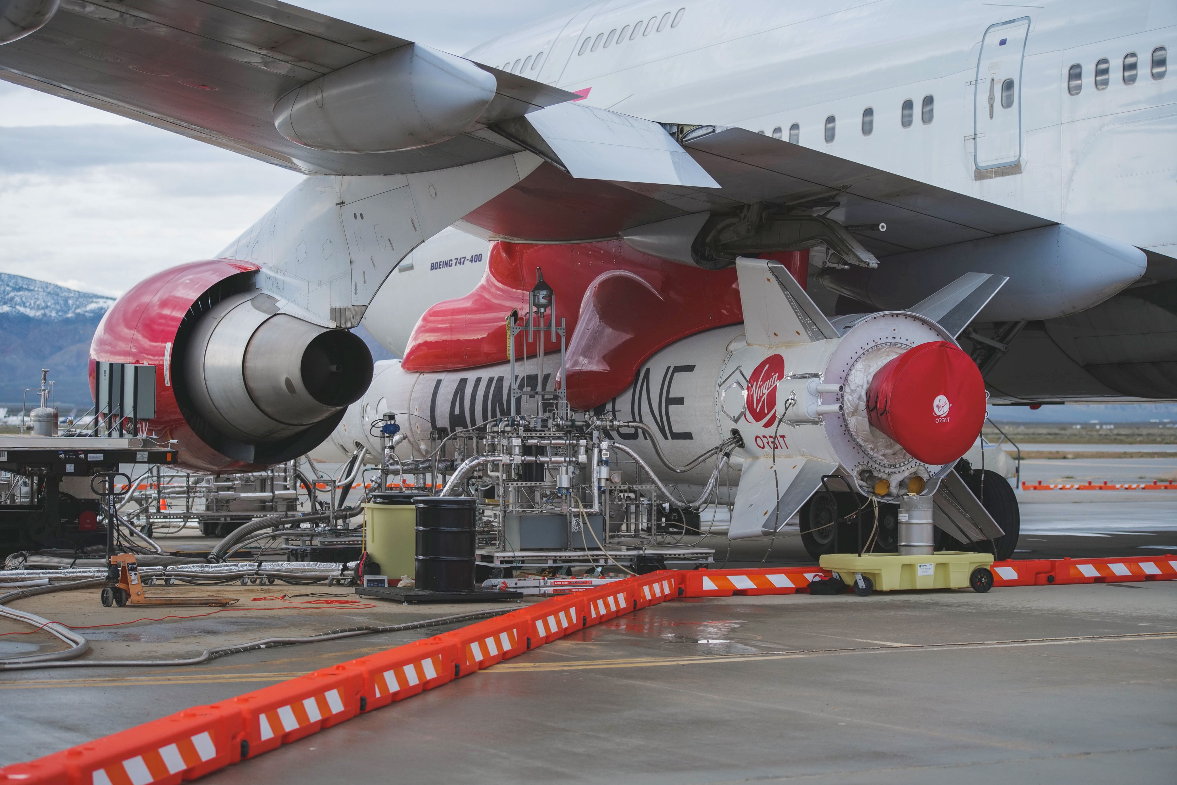

We completed fueling of our LauncherOne rocket yesterday for our Launch Demo. Everything has been proceeding smoothly: team, aircraft, and rocket are in excellent shape. However, we have one sensor that is acting up. Out of an abundance of caution, we are offloading fuel to address.
This means we are scrubbed for today. Currently, it appears we've got a straightforward path to address this minor sensor issue and recycle quickly. The crew are already hard at work putting that plan into action. We'll provide an update on the new launch target later today.

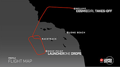

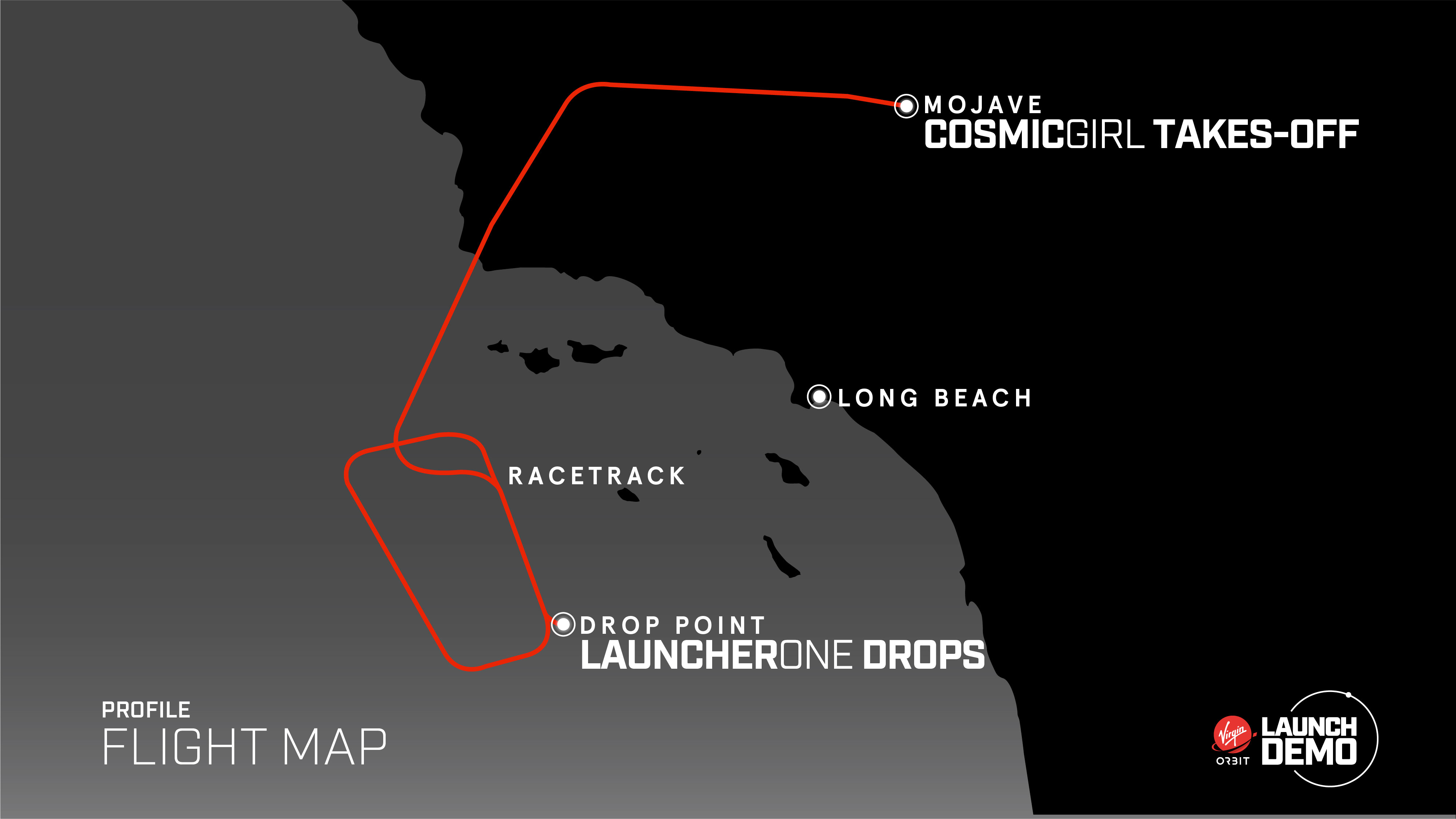

Confirming a smooth takeoff! Cosmic Girl is officially airborne for our first attempt at an orbital launch demo.
After taking off from Mojave, Cosmic Girl will fly due southwest to our drop point just south of the Channel Islands. Once we reach the drop point, we'll enter into a loop that we call the "racetrack" as we wait for final go/no-gos.
As we fly laps around the racetrack, the team will be checking conditions for release — making sure that the wind levels aren't too high and that we have a strong telemetry connection so we can receive data after the drop.

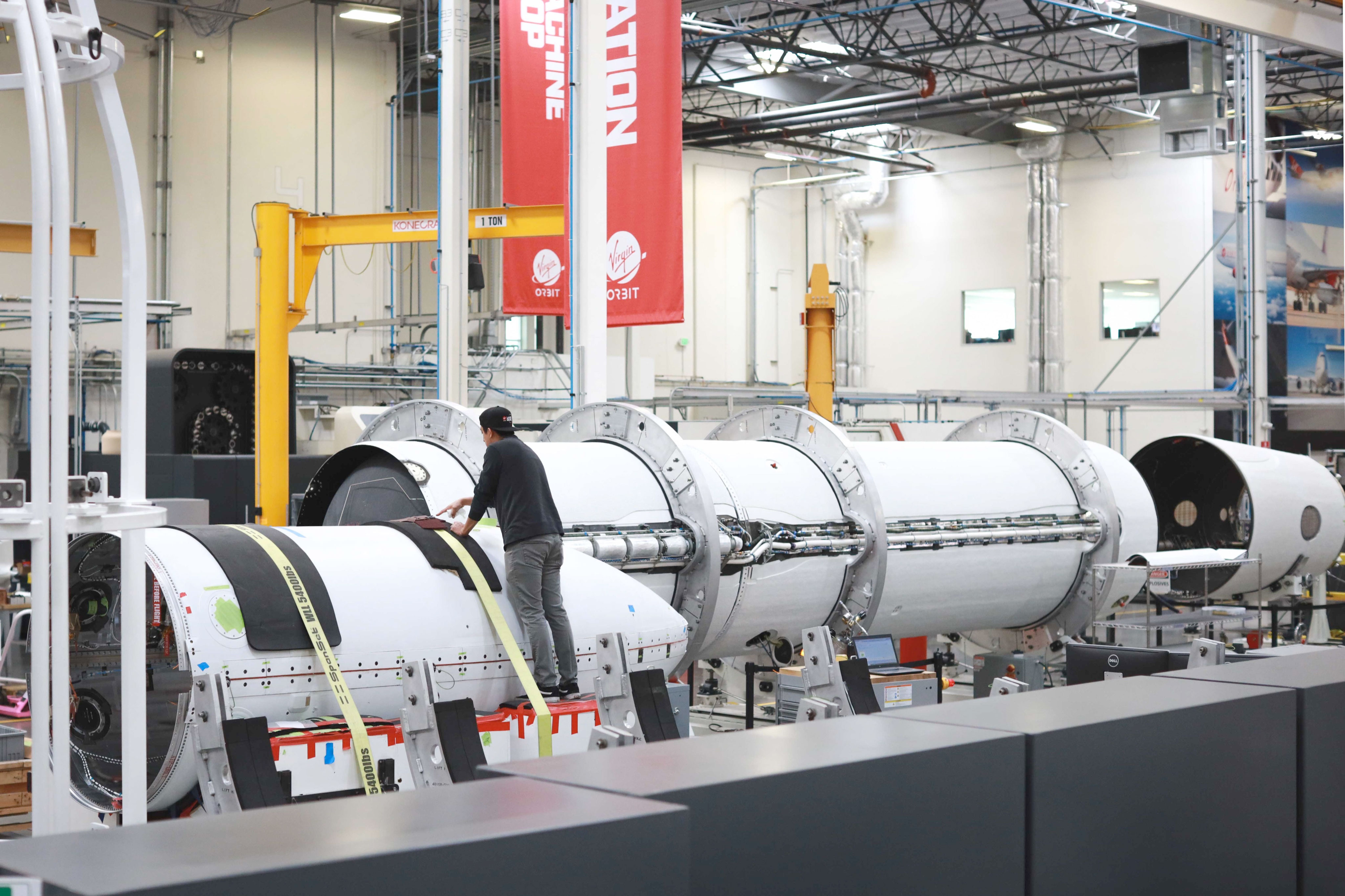

The team's already hard at work digging into the data, and we're eager to hop into our next big test ASAP. Thankfully, instead of waiting until after our first flight to tackle our second rocket, we've already completed a ton of work to get us back in the air and keep moving forward.
Here's our next rocket, built and ready for system-level testing in our final integration area as it waits for its turn to fly to space.

After a swift flight out to the drop point and a cold pass around our racetrack — the planned loop where we ensure the system autonomously detects when it enters and exits the allowable launch corridor, in addition to verifying telemetry locks — we entered into and executed a terminal count for the first time outside of dress rehearsals. A universal aerospace practice that has been made famous by countless documentaries and films, the terminal count is the final sequence of checks and polls that culminate in a rocket's ignition and flight. These countdowns always require an uncompromising level of precision, communication, and choreography — and our team pulled it off without a hiccup, hold, or scrub.
As the terminal count approached zero, our carrier aircraft went into our pitch-up maneuver, climbing steeply and achieving a flight path angle of about 30 degrees. Exactly on cue, we cleanly released the LauncherOne rocket from the pylon under the wing of our 747. As planned, the aircraft quickly banked away from the rocket. The rocket itself flew gracefully, with complete control, perfectly matching our predictions and further validating our aerodynamic models.
