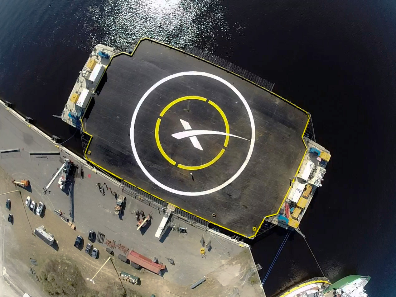

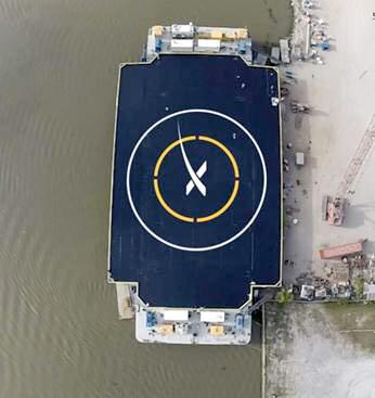

Elon Musk on Saturday (Nov. 22) shared the first photo of the company's new autonomous spaceport drone ship that it plans to use to land Falcon 9 first stages.
Thrusters repurposed from deep sea oil rigs hold position within 3 meters, even in a storm.
Base is 300 feet by 100 feet, with wings that extend width to 170 feet. Will allow refuel and rocket flyback in future.
SpaceX is planning to deploy its new landing barge for the launch of Dragon SpX-5, currently targeted for Dec. 16, 2014.

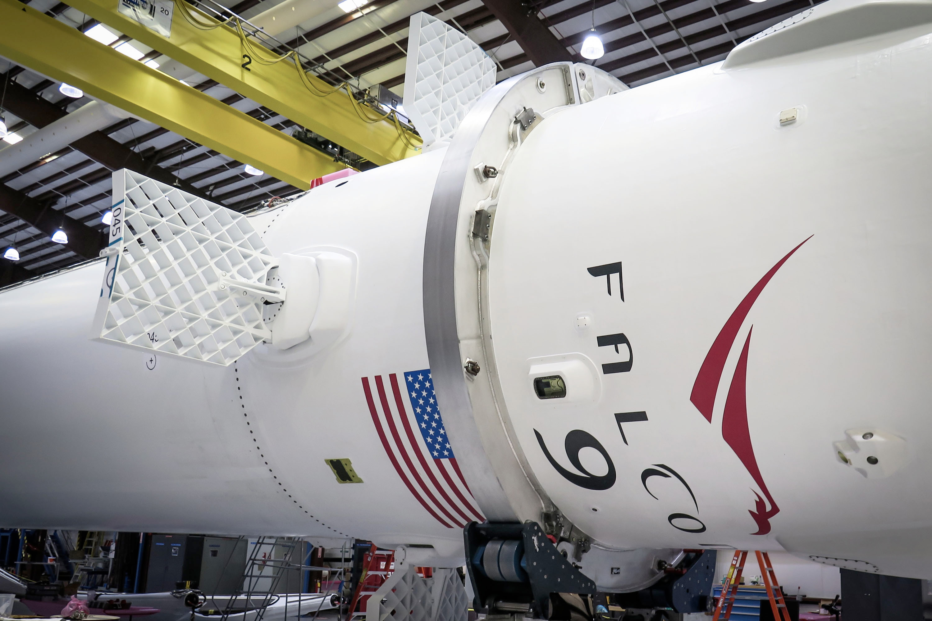

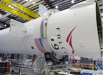

Musk also shared a photo of the hypersonic grid fins being added to the Falcon 9 first stage to assist with its recovery.
Testing operation of hypersonic grid fins (x-wing config) going on next flight. Grid fins are stowed on ascent and then deploy on reentry for "x-wing" style control. Each fin moves independently for pitch/yaw/roll.

X Marks the Spot: Falcon 9 Attempts Ocean Platform Landing
During our next flight, SpaceX will attempt the precision landing of a Falcon 9 first stage for the first time, on a custom-built ocean platform known as the autonomous spaceport drone ship. While SpaceX has already demonstrated two successful soft water landings, executing a precision landing on an unanchored ocean platform is significantly more challenging.
The odds of success are not great — perhaps 50% at best. However this test represents the first in a series of similar tests that will ultimately deliver a fully reusable Falcon 9 first stage.
Returning anything from space is a challenge, but returning a Falcon 9 first stage for a precision landing presents a number of additional hurdles. At 14 stories tall and traveling upwards of 1300 m/s (nearly 1 mi/s), stabilizing the Falcon 9 first stage for reentry is like trying to balance a rubber broomstick on your hand in the middle of a wind storm.
To help stabilize the stage and to reduce its speed, SpaceX relights the engines for a series of three burns. The first burn — the boostback burn — adjusts the impact point of the vehicle and is followed by the supersonic retro propulsion burn that, along with the drag of the atmosphere, slows the vehicle's speed from 1300 m/s to about 250 m/s. The final burn is the landing burn, during which the legs deploy and the vehicle's speed is further reduced to around 2 m/s.
To complicate matters further, the landing site is limited in size and not entirely stationary. The autonomous spaceport drone ship is 300 by 100 feet, with wings that extend its width to 170 feet. While that may sound huge at first, to a Falcon 9 first stage coming from space, it seems very small. The legspan of the Falcon 9 first stage is about 70 feet and while the ship is equipped with powerful thrusters to help it stay in place, it is not actually anchored, so finding the bullseye becomes particularly tricky. During previous attempts, we could only expect a landing accuracy of within 10km. For this attempt, we're targeting a landing accuracy of within 10 meters.
A key upgrade to enable precision targeting of the Falcon 9 all the way to touchdown is the addition of four hypersonic grid fins placed in an X-wing configuration around the vehicle, stowed on ascent and deployed on reentry to control the stage's lift vector. Each fin moves independently for roll, pitch and yaw, and combined with the engine gimbaling, will allow for precision landing – first on the autonomous spaceport drone ship, and eventually on land.
Similar steerable fins can also be seen in this test video.

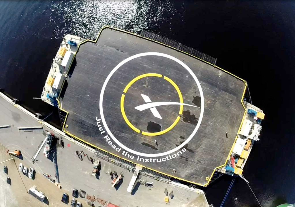

Elon Musk has revealed the names of SpaceX's east coast and now under construction west coast drone ships.
...have given it the name "Just Read the Instructions."

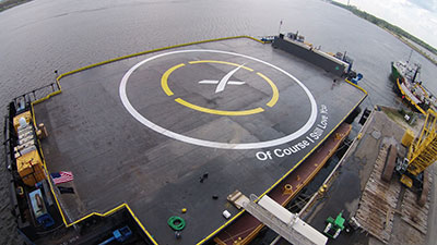

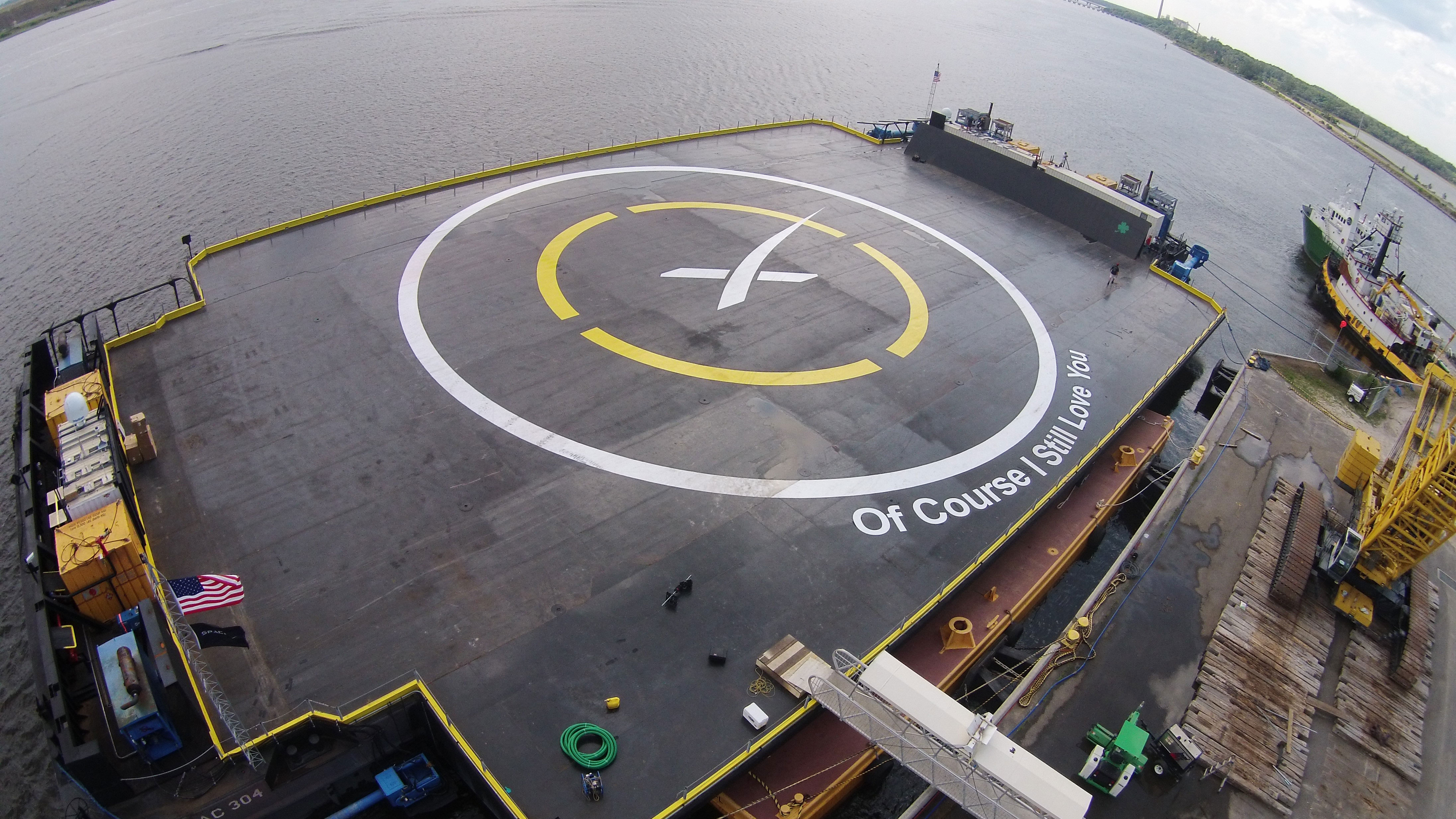

West Coast drone ship under construction will be named "Of Course I Still Love You."
For those not familiar, the names are from science fiction writer Iain M. Banks' Culture novels. "Just Read the Instructions" and "Of Course I Still Love You" are two of the sentient, planet-sized Culture starships that first appear in Banks' "The Player of Games."

The second ASDS has entered the fleet:
New "Of Course I Still Love You" drone ship ready for Sunday's rocket landing attempt.
