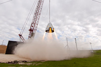

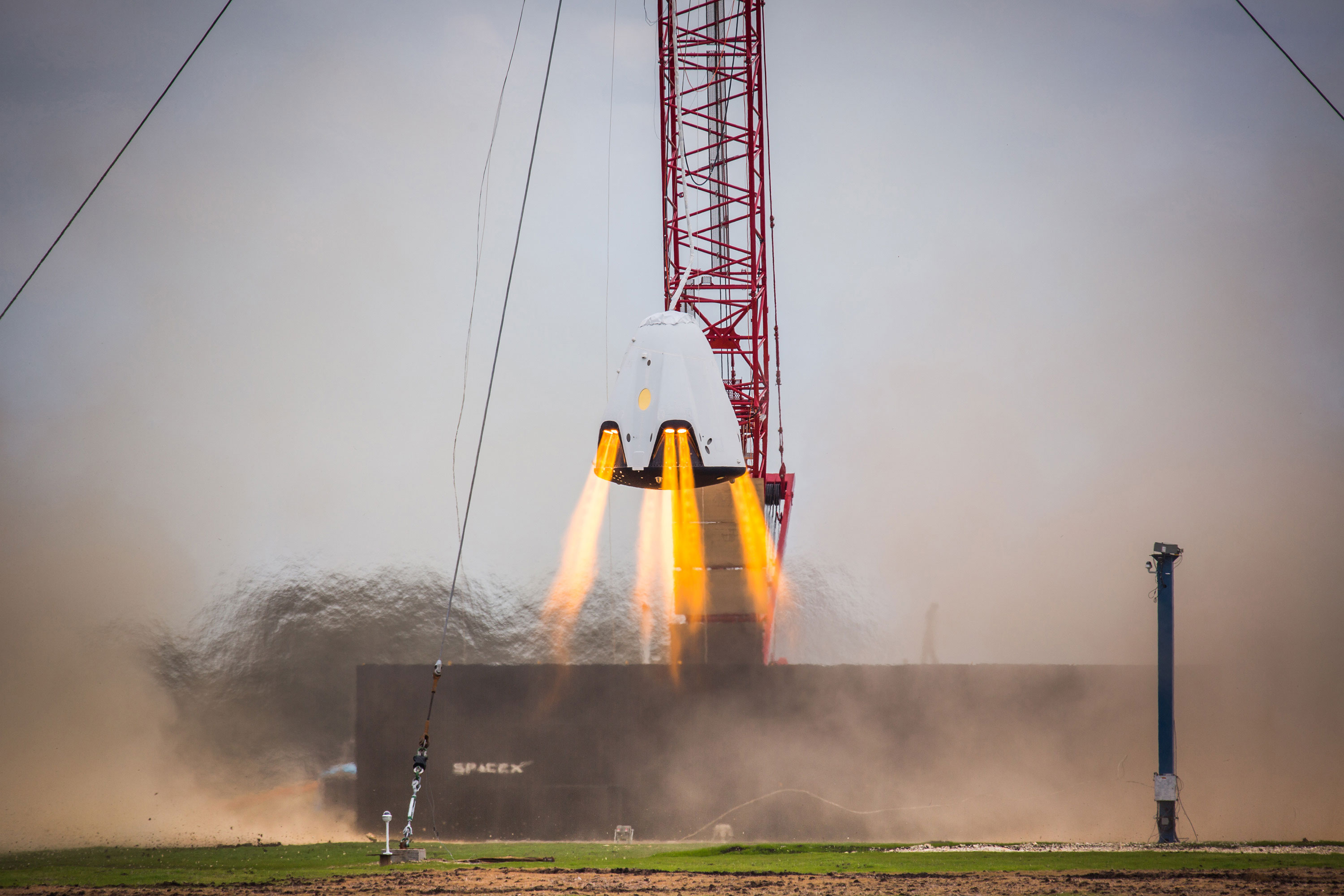

Posts: 42988
posted 01-21-2016 04:41 PM     Click Here to See the Profile for Robert Pearlman   Click Here to Email Robert Pearlman     Edit/Delete Message   Reply w/Quote
SpaceX photos
