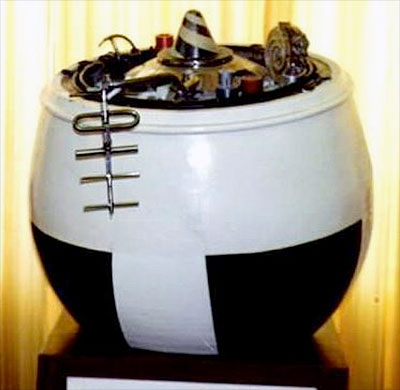

Kosmos 482, a Soviet-era Venera lander that failed to depart for Venus in 1972, is falling back to Earth.
The upper stage of the Soyuz booster launching that Venus probe cut off prematurely, leaving the payload marooned in Earth orbit. But there is new news for this old probe: "In about two weeks from now, on or near May 9-10, an unusual uncontrolled reentry will happen." That's the report from satellite watcher Marco Langbroek of the Netherlands. He has been taking telescopic looks at the errant, Earth-circling Cosmos 482 remains for numbers of years.
And one hot topic to ponder is whether that landing module intended for Venus, custom-made to withstand reentry through the thick Venus atmosphere, might survive reentry through Earth's atmosphere intact.
As Langbroek reports, the Venus probe had a parachute for the upper Venusian atmosphere dive, "but I wouldn't bet on that working now, and would assume that, if it survives re-entry, it would come down hard."
Above: Venera 8 descent module model. Cosmos 382 was the sister craft to Venera 8.

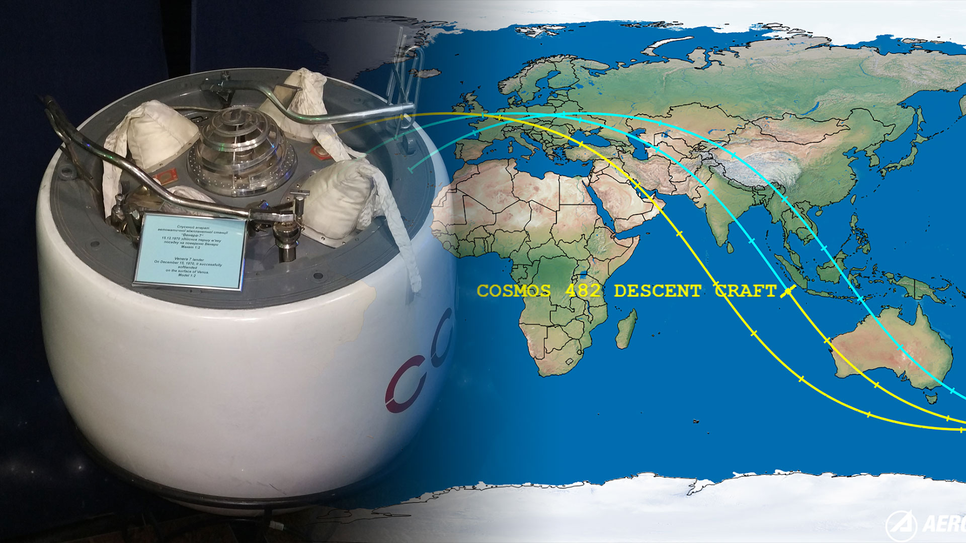

ESA's Space Debris Office currently predicts that the reentry of the descent craft will take place at 3:12 a.m. EDT (0712 GMT or 09:12 CEST) on Saturday, May 10, 2025.
The uncertainty in this prediction is now +/- 13.67 hours.
Posts: 54571
posted 05-08-2025 04:07 PM     Click Here to See the Profile for Robert Pearlman   Click Here to Email Robert Pearlman     Edit/Delete Message   Reply w/Quote
Aerospace Corporation is now tracking Kosmos 482's reentry.
As of this post, they have it coming down on Saturday (May 10) at 1:54 a.m. EDT (0554 GMT) ± 9 hours. At that time, it would fall into the mid-Atlantic Ocean.

Sorry to say, Scott, Arizona is no longer in the fall zone, but just off shore Houston remains a possibility in the latest track from Aerospace Corp.
The predicted reentry time is now Saturday (May 10) 2:11 a.m. EDT (0611 GMT) ± 4 hours.

ESA Space Debris Office release
Status 10 May 09:56 CEST
As the descent craft was not spotted by radar over Germany at the expected 07:32 UTC / 09:32 CEST [3:32 a.m. EDT] pass, it is most likely that the reentry has already occurred.
Status 10 May 08:35 CEST
The descent craft was seen by radar systems over Germany at approximately 04:30 UTC and 06:04 UTC [12:04 a.m. and 2:04 a.m. EDT], corresponding to 06:30 CEST and 08:04 CEST, respectively.
