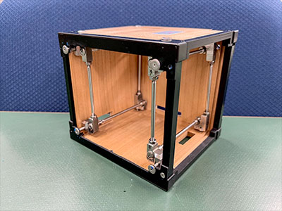

Above: Internal view of LignoSat's structure shows the relationship among wooden panels, aluminum frames, and stainless-steel shafts. (Kyoto University)

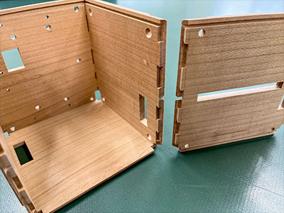

A previous experiment aboard the station exposed three species of wood to the space environment to help researchers determine the best option for LignoSat. The final design used 4-inch-long (10-centimeter) Honoki Magnolia wood panels assembled with a Japanese wood-joinery method.

Above: The traditional Japanese wooden joint method called "Blind Miter Dovetail Joint" is used for the LignoSat to connect two wooden panels without using glue or nails. (Kyoto University)
