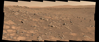

Above: A light-colored “paver stone,” like the ones seen in this mosaic image, will be the likely target for first sampling by the Perseverance rover. This image was taken July 8, 2021, in the “Cratered Floor Fractured Rough” geologic unit at Jezero Crater. (NASA/JPL-Caltech/ASU/MSSS)

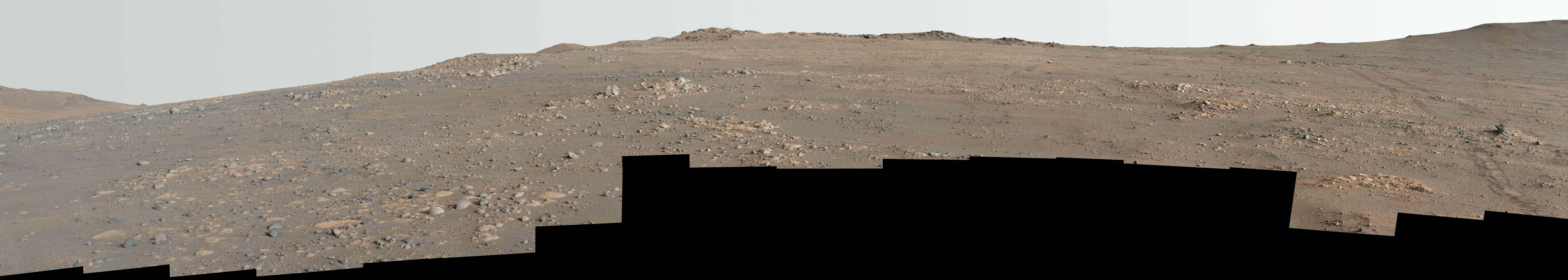

Above: Perseverance snapped this view of a hill called "Santa Cruz" on April 29, 2021. About 20 inches (50 centimeters) across on average, the boulders in the foreground are among the type of rocks the rover team has named "Ch'ał" (the Navajo term for "frog" and pronounced "chesh"). Perseverance will return to the area next week or so. (NASA/JPL-Caltech/ASU/MSSS)

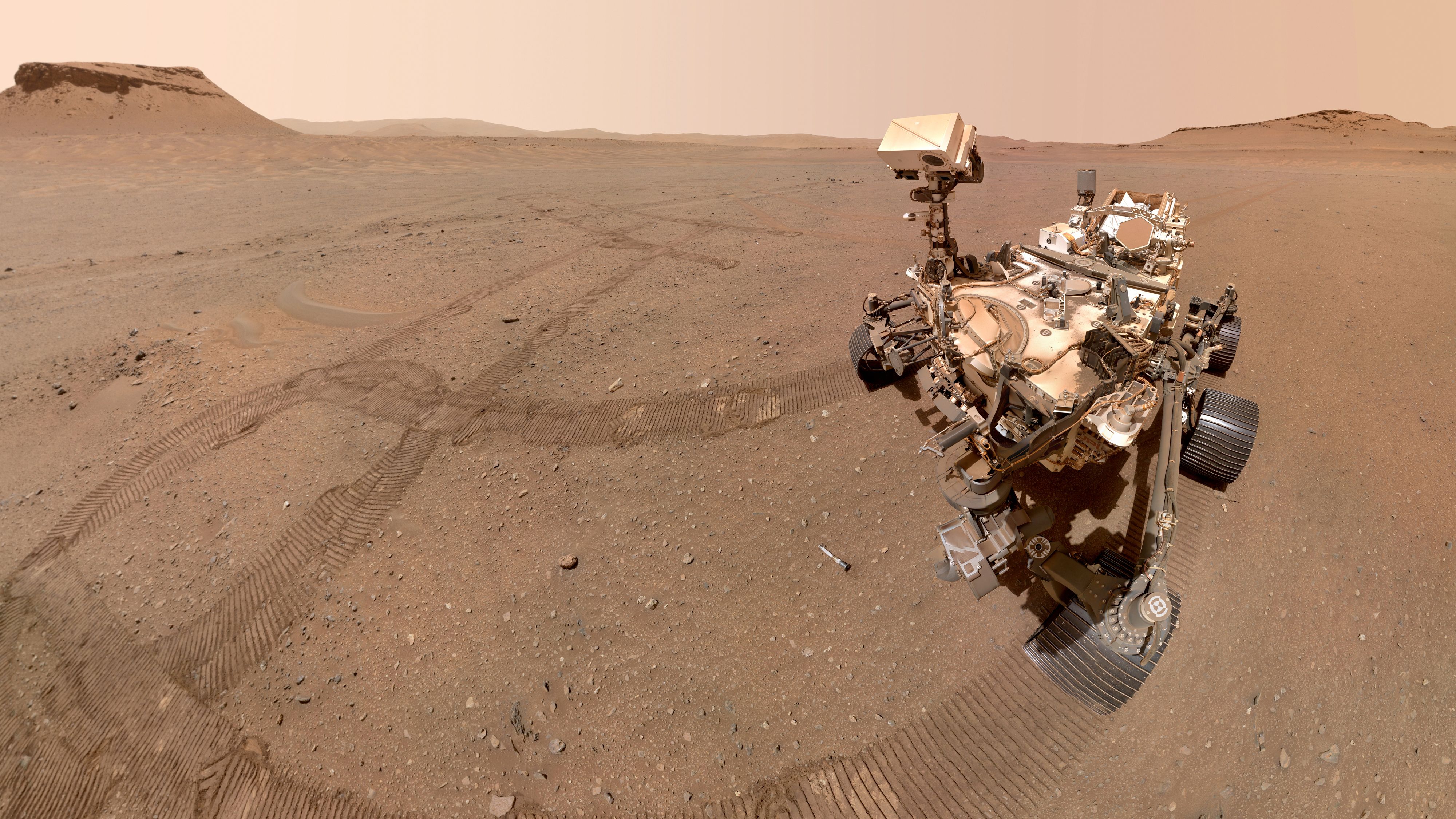

Above: NASA's Perseverance took this selfie of itself looking down at one of 10 sample tubes deposited at the sample depot it created in an area nicknamed "Three Forks." This image was taken by the WATSON camera on the rover's robotic arm on Jan. 20, 2023, the 684th Martian day, or sol, of the mission. (NASA/JPL-Caltech/MSSS)
Throughout its science campaigns, the rover has been taking a pair of samples from rocks the mission team deems scientifically significant. One sample from each pair taken so far now sits in the carefully arranged depot in the "Three Forks" region of Jezero Crater. The depot samples will serve as a backup set while the other half remain inside Perseverance, which would be the primary means to convey samples to a Sample Retrieval Lander as part of the campaign.
Mission scientists believe the igneous and sedimentary rock cores provide an excellent cross section of the geologic processes that took place in Jezero shortly after the crater's formation almost 4 billion years ago. The rover also deposited an atmospheric sample and what's called a "witness" tube, which is used to determine if samples being collected might be contaminated with materials that traveled with the rover from Earth.
The titanium tubes were deposited on the surface in an intricate zigzag pattern, with each sample about 15 to 50 feet (5 to 15 meters) apart from one another to ensure they could be safely recovered. Adding time to the depot-creation process, the team needed to precisely map the location of each 7-inch-long (18.6-centimeter-long) tube and glove (adapter) combination so that the samples could be found even if covered with dust. The depot is on flat ground near the base of the raised, fan-shaped ancient river delta that formed long ago when a river flowed into a lake there.

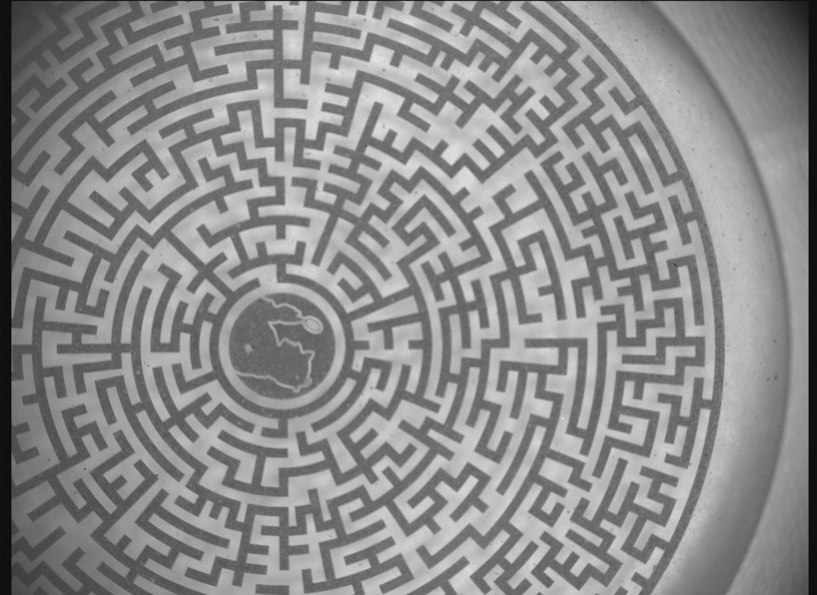

Above: Perseverance's team used the SHERLOC instrument's Autofocus and Context Imager to capture this image of its calibration target on May 11 to confirm an issue with a stuck lens cover had been resolved. A silhouette of the fictional detective Sherlock Holmes is at the center of the target. (NASA/JPL-Caltech)
"With the cover out of the way, a line of sight for the spectrometer and camera was established. We were halfway there," said Kyle Uckert, SHERLOC deputy principal investigator at JPL. "We still needed a way to focus the instrument on a target. Without focus, SHERLOC images would be blurry and the spectral signal would be weak."
Like any good ophthalmologist, the team set about figuring out SHERLOC's prescription. Since they couldn't adjust the focus of the instrument's optics, they relied on the rover's robotic arm to make minute adjustments in the distance between SHERLOC and its target in order to get the best image resolution. SHERLOC was commanded to take pictures of its calibration target so that the team could check the effectiveness of this approach.
"The rover's robotic arm is amazing. It can be commanded in small, quarter-millimeter steps to help us evaluate SHERLOC's new focus position, and it can place SHERLOC with high accuracy on a target," said Uckert. "After testing first on Earth and then on Mars, we figured out the best distance for the robotic arm to place SHERLOC is about 40 millimeters," or 1.58 inches. "At that distance, the data we collect should be as good as ever."
Above: This image of NASA's Perseverance rover gathering data on the "Walhalla Glades" abrasion was taken in the "Bright Angel" region of Jezero Crater by one of the rover's front hazard avoidance cameras on June 14. The WATSON camera on the SHERLOC instrument is closest to the Martian surface. (NASA/JPL-Caltech)
Confirmation of that fine positioning of the ACI on a Martian rock target came down on May 20. The verification on June 17 that the spectrometer is also functional checked the team's last box, confirming that SHERLOC is operational.

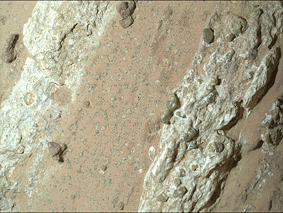

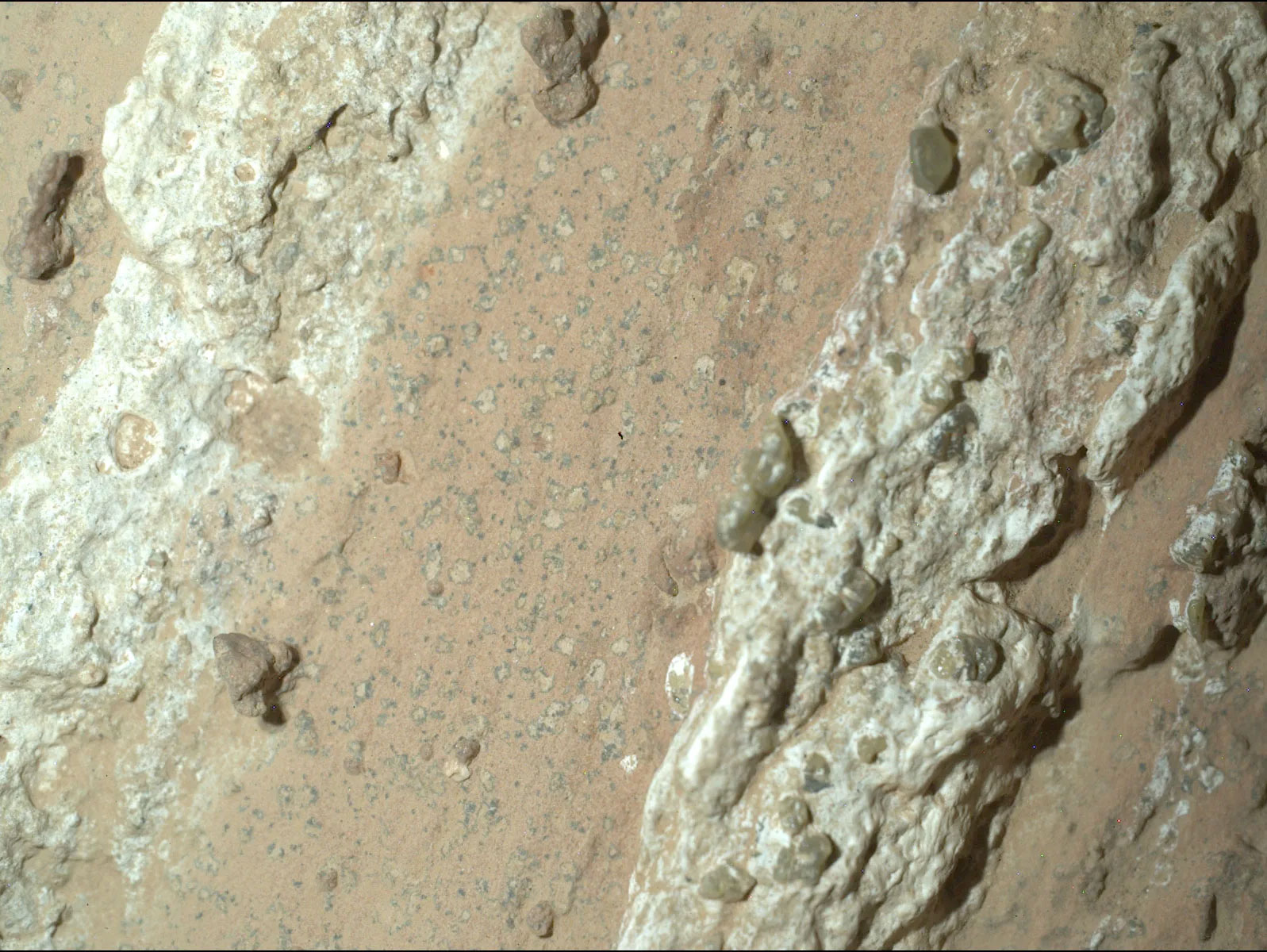

Above: NASA’s Perseverance rover discovered leopard spots on a reddish rock nicknamed “Cheyava Falls” in Mars’ Jezero Crater in July 2024. Scientists think the spots may indicate that, billions of years ago, the chemical reactions in this rock could have supported microbial life; other explanations are being considered. (NASA/JPL-Caltech/MSSS)
Perseverance came upon Cheyava Falls in July 2024 while exploring the "Bright Angel" formation, a set of rocky outcrops on the northern and southern edges of Neretva Vallis, an ancient river valley measuring a quarter-mile (400 meters) wide that was carved by water rushing into Jezero Crater long ago.
"This finding is the direct result of NASA's effort to strategically plan, develop, and execute a mission able to deliver exactly this type of science — the identification of a potential biosignature on Mars," said Nicky Fox, associate administrator, Science Mission Directorate at NASA Headquarters in Washington. "With the publication of this peer-reviewed result, NASA makes this data available to the wider science community for further study to confirm or refute its biological potential."
The rover's science instruments found that the formation's sedimentary rocks are composed of clay and silt, which, on Earth, are excellent preservers of past microbial life. They also are rich in organic carbon, sulfur, oxidized iron (rust), and phosphorous.
"The combination of chemical compounds we found in the Bright Angel formation could have been a rich source of energy for microbial metabolisms," said Perseverance scientist Joel Hurowitz of Stony Brook University, New York and lead author of the paper. "But just because we saw all these compelling chemical signatures in the data didn't mean we had a potential biosignature. We needed to analyze what that data could mean."
First to collect data on this rock were Perseverance's PIXL (Planetary Instrument for X-ray Lithochemistry) and SHERLOC (Scanning Habitable Environments with Raman & Luminescence for Organics & Chemicals) instruments. While investigating Cheyava Falls, an arrowhead-shaped rock measuring 3.2 feet by 2 feet (1 meter by 0.6 meters), they found what appeared to be colorful spots. The spots on the rock could have been left behind by microbial life if it had used the raw ingredients, the organic carbon, sulfur, and phosphorus, in the rock as an energy source.
In higher-resolution images, the instruments found a distinct pattern of minerals arranged into reaction fronts (points of contact where chemical and physical reactions occur) the team called leopard spots. The spots carried the signature of two iron-rich minerals: vivianite (hydrated iron phosphate) and greigite (iron sulfide). Vivianite is frequently found on Earth in sediments, peat bogs, and around decaying organic matter. Similarly, certain forms of microbial life on Earth can produce greigite.
The combination of these minerals, which appear to have formed by electron-transfer reactions between the sediment and organic matter, is a potential fingerprint for microbial life, which would use these reactions to produce energy for growth. The minerals also can be generated abiotically, or without the presence of life. Hence, there are ways to produce them without biological reactions, including sustained high temperatures, acidic conditions, and binding by organic compounds. However, the rocks at Bright Angel do not show evidence that they experienced high temperatures or acidic conditions, and it is unknown whether the organic compounds present would've been capable of catalyzing the reaction at low temperatures.

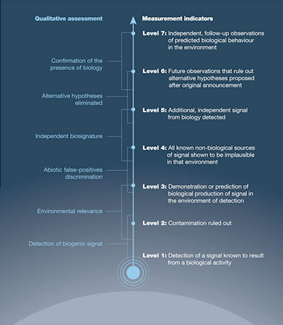

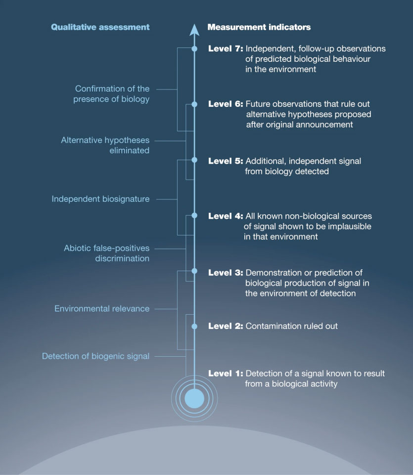

"Astrobiological claims, particularly those related to the potential discovery of past extraterrestrial life, require extraordinary evidence," said Katie Stack Morgan, Perseverance's project scientist at NASA's Jet Propulsion Laboratory in Southern California. "Getting such a significant finding as a potential biosignature on Mars into a peer-reviewed publication is a crucial step in the scientific process because it ensures the rigor, validity, and significance of our results. And while abiotic explanations for what we see at Bright Angel are less likely given the paper's findings, we cannot rule them out."
The scientific community uses tools and frameworks like the CoLD scale and Standards of Evidence to assess whether data related to the search for life actually answers the question, Are we alone? Such tools help improve understanding of how much confidence to place in data suggesting a possible signal of life found outside our own planet.
Above: Marked by seven benchmarks, the Confidence of Life Detection, or CoLD, scale outlines a progression in confidence that a set of observations stands as evidence of life. (NASA)

Assembled from 61 individual images, the selfie shows Perseverance training its mast on a rocky outcrop on which it had just made a circular abrasion patch, with the western rim of Jezero Crater stretching into the background. The selfie was captured on March 11, the 1,797th Martian day, or sol, of the mission, during the rover's deepest push west beyond the crater.
Perseverance is in its fifth science campaign, known as the Northern Rim Campaign, of its mission on the Red Planet. The Lac de Charmes region represents some of the most scientifically compelling terrain the rover has visited.
Above: NASA's Perseverance captured this enhanced-color panorama of an area nicknamed "Arbot" on April 5, the 1,882nd Martian day, or sol, of the mission. Made of 46 images, the panorama offers one of the richest geological vistas of the rover's mission, revealing a windswept landscape of diverse rock textures. (NASA/JPL-Caltech/ASU/MSSS)
"We took this image when the rover was in the 'Wild West' beyond the Jezero Crater rim — the farthest west we have been since we landed at Jezero a little over five years ago," said Katie Stack Morgan, Perseverance's project scientist at NASA's Jet Propulsion Laboratory in Southern California. "We had just abraded and analyzed the 'Arethusa' outcrop, and the rover was sitting in a spot that provided a great view of both the Jezero Rim and the local terrain outside of the crater."

Along with the selfie, Perseverance used Mastcam-Z, located on its mast, to capture a mosaic of the "Arbot" area in Lac de Charmes on April 5, or Sol 1882. Made of 46 images, the panorama offers one of the richest geological vistas of the mission, revealing a windswept landscape of diverse rock textures.
The image provides the team a clear road map for investigating the ridgeline and the area's ancient rock variety, including what appear to be megabreccia — large fragments (some the size of skyscrapers) hurled by a massive meteorite impact that occurred on the plain called Isidis Planitia about 3.9 billion years ago.
"What I see in this image is excellent exposure of likely the oldest rocks we are going to investigate during this mission," said Ken Farley, Perseverance's deputy project scientist at Caltech in Pasadena. "There is a sharp ridgeline visible in the mosaic whose jagged, angular texture contrasts starkly with the rounded boulders in the foreground. We also see a feature that may be a volcanic dike, a vertical intrusion of magma that hardened in place and was left standing as the softer surrounding material eroded away over billions of years."
The rock color in the mosaic offers less information to the science team than the distinctive textures, which help them differentiate the rock types. Unlike Jezero Crater's river delta, which is composed of sedimentary rock, some rocks here appear to be extrusive igneous rocks (molten rock that reached the surface as lava flows) and impactites (rocks created or modified by a meteorite impact) believed to have formed before the crater about 4 billion years ago, offering a window into the planet's deep early crust.

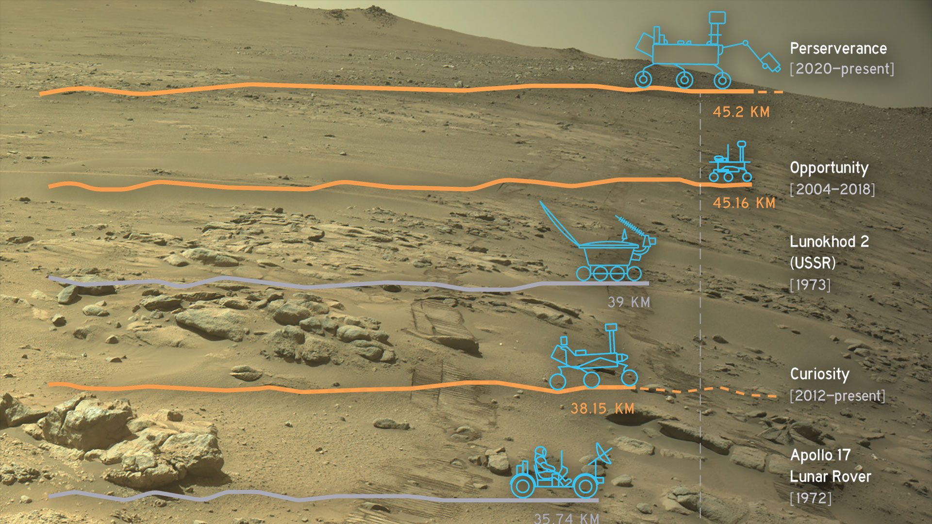

New ballgame, near-marathon distance
"The rover's study of these really ancient rocks is a whole new ballgame," said Stack Morgan. "These rocks — especially if they're from deep in the crust — could give us insights applicable to the entire planet, like whether there was a magma ocean on Mars and what initial conditions eventually made it a habitable planet."
After studying Arethusa, Perseverance drove northwest to the Arbot area, where it has been analyzing other rocky outcrops. When the team is satisfied with the work accomplished there, the rover will drive south to "Gardevarri," a site with a notably clear exposure of olivine-bearing rocks. Formed in cooling magma, these types of rocks contain information that can help scientists better understand Mars' volcanic history and provide context for large-scale geological processes. From there, the rover is expected to head southeast toward a region the team is calling "Singing Canyon" for more insights into the planet's early crust.
After more than five years of surface operations, Perseverance has abraded 62 rocks, collected 27 rock cores in its sample tubes (25 sealed, 2 unsealed), and traveled almost 26 miles (42 kilometers) — in other words, just shy of a marathon (26.2 miles, or 42.195 kilometers).
"Having the benefit of four previous rover missions, the Perseverance team has always known our mission was a marathon and not a sprint," said acting Perseverance project manager Steve Lee at JPL. "We've almost reached marathon distance. Our selfie may show that the rover is a bit dusty, but its beauty is more than skin deep. Perseverance is in great shape as we continue our explorations and extend into ultramarathon drive distances."
