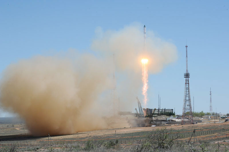

Carrying more than 6,000 pounds of food, fuel, and supplies for the International Space Station, the Progress M-27M spacecraft lifted off at 2:09 a.m. CDT (0709 GMT; 1:09 p.m. local time) from the Baikonur Cosmodrome in Kazakhstan.
The launch proceeded as planned, however, Russian flight controllers could not initially confirm the health of the freighter's systems and deployment of its Kurs rendezvous and other navigational antennas. As a result, the controllers opted for to a backup rendezvous plan with a targeted arrival on Thursday (April 30).
Above: Progress M-27M launches for the space station. (Energia)
