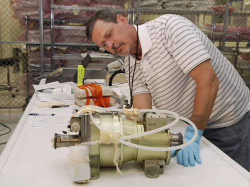

posted 05-29-2008 11:33 PM
A technician inspects a replacement part for the Zvezda service module toilet on the International Space Station following its arrival at Kennedy Space Center. At Launch Pad 39A at Kennedy Space Center, a technician loads replacement parts for the Zvezda service module toilet on the International Space Station aboard space shuttle Discovery. |

At 10:27 a.m. CDT today, Expedition 17 flight engineer Oleg Kononenko replaced the gas liquid separator pump in the urine collection portion of the station's Zvezda toilet. Initial tests appear to be successful, but more testing is underway. |
posted 06-04-2008 11:57 AM
After a series of three tests, the replacement pump appears to be working. Mission Control Moscow has given the station crew a "go" to resume normal operations of the toilet system. |
