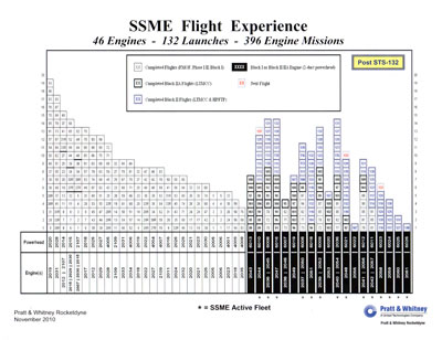

Here is the Pratt & Whitney usage chart for comparison/reference (click on the image to enlarge):

Do you think you can publish the link where this chart can be downloaded? Just for updated versions for the shuttle missions to come?
Posts: 57029
posted 09-14-2006 07:23 AM     Click Here to See the Profile for Robert Pearlman   Click Here to Email Robert Pearlman     Edit/Delete Message   Reply w/Quote
As mentioned above, I was unable to find this document online. The above chart was scanned from a hand-out provided at the Kennedy Space Center press site.

Does anyone have a final update for the SSME data for all flights through STS-135?
Posts: 57029
posted 03-11-2011 01:22 PM     Click Here to See the Profile for Robert Pearlman   Click Here to Email Robert Pearlman     Edit/Delete Message   Reply w/Quote
Here is the Pratt & Whitney usage chart for STS-133 (post STS-132).
STS-134 will uses main engines 2059, 2061 and 2057. STS-135 will use main engines 2045, 2060 and 2047.
