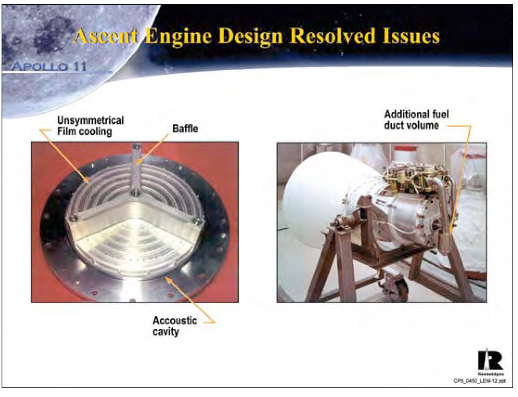

If you don't have it already, "Remembering The Giants: Apollo Rocket Propulsion Developments" - NASA SP-2009-4545 has some info in that regard that was delivered by Rocketdyne's Tim Harmon in a series of lectures back in 2006 concerning Apollo propulsion development, but the reproduction quality is not great. Here are a couple of the slides that were reproduced in the book.
