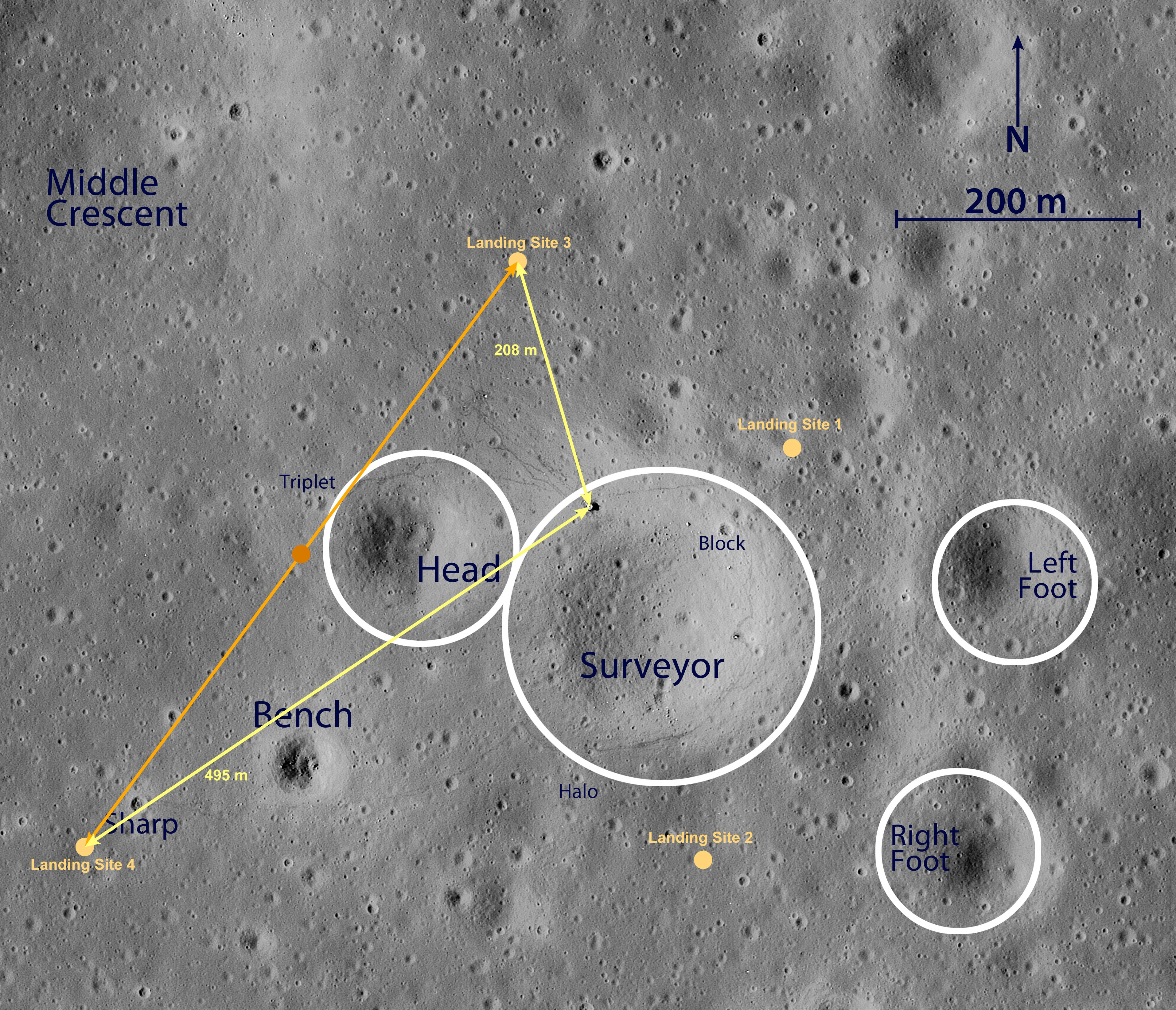

On Apollo 12, I believe the exact landing target near Surveyor Crater was nicknamed "Pete's Parking Lot." However as things turned out I believe they did not land there. The (LROC?) photo below has been annotated to show four landing sites in the vicinity of Surveyor Crater. Conrad mentions that they "flew past" their intended landing point and they landed a bit further west (he initially surmises they are between site 3 and site 4). Was site 1 the intended "Pete's Parking Lot"?  |

Check out pg 56, of the 19 Nov. 1969 issue of Aviation Week & Space Technology. They include a Lunar Orbiter photo-mosaic map of the Apollo 12 landing site. A lunar module cutout is positioned 1118 ft to the northeast of Surveyor 3. This site is somewhat east of the "Snowman's" left foot to the point it would not appear on the LRO picture above.If this was indeed, Conrad's target landing site, it would explain why he said that he flew past their intended landing site. |

I could be wrong on this, but what I remember reading somewhere is the person responsible for programming the landing sequence asked Conrad where he wanted to land. Over the course of several days those landing points were changed until one day the programmer asked Conrad again and Conrad basically said, "Put me in the middle of Surveyor Crater and I'll figure it out when I get there." If you look at all of Pete's redesignations during landing, that's basically what happened. It's not that Conrad wanted to land in the middle of the crater, he just wanted to make sure he was close enough to walk to it. |
