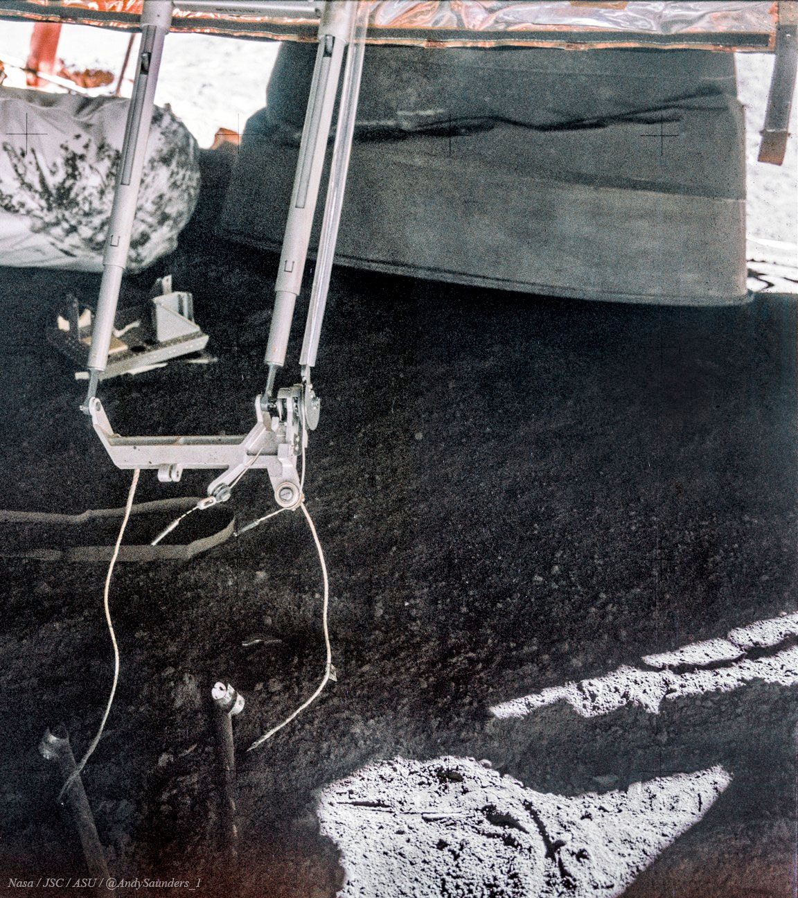

Didn't know this until today — the landing skirt on the Apollo 15 lunar module Falcon buckled on landing?
From Andy Sanders ("Apollo Remastered") on Twitter:
Here I've produced for you, from 16mm film frames (HD source Stephen Slater), an enhanced view from Jim Irwin's window as they approach the landing spot (red dot). The landing buckled the engine skirt.

The possibility of the nozzle extension impacting the lunar surface was specifically designed for and tested by the engine supplier TRW. They built a "crushing test fixture" and subjected a columbium (niobium) nozzle extension to a simulated 10 ft/sec landing impact by compressing the nozzle extension 28 inches in less than half a second.

The lunar module descent engine nozzle contacting the lunar surface was a design factor of both the spacecraft and the flight plan.
A reason that the landing probes and the contact light were incorporated into the spacecraft design was to provide a proximity alert for when the vehicle was considered close enough to the lunar surface that the descent engine could be shut down, and the vehicle could settle to the surface as a safe velocity.
The reason that the flight plan was designed, and practiced in simulation, for the engine to be shut down before surface contact was to avoid a situation whereby a rock or lunar soil could potentially plug the descent engine nozzle and cause a catastrophic failure.
