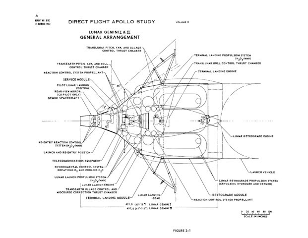

I think the answer is no Mike.Doing a little digging around, in a 1964 document by John Hammersmith, it seems the best that could be done to get a Gemini on a circumlunar mission using Titans only, was to use two Titan III's — one for launch and one as a tanker in EOR. Other vehicles to be used in various numbers and configurations that were mentioned, involved the Titan II GLV, Agena, Centaur, Saturn I and by itself — a three stage Saturn IB. Then going way of topic, there was a McDonnell 1962 report that in part, considered various configurations of the Gemini vehicle launched with the Saturn C5 (as it was known then) to get about 90,000 lbs to a direct moon landing and back.  |

As info, there is a copy of a McDonnell study, for a Gemini circumlunar mission, included at the end of Apogee Books Gemini 12 Mission Report. It involved launching a Gemini on a Titan II and launching a fully fueled Centaur upper stage, with docking ring and electronic connections, with a Titan III. The Gemini would dock with the Centaur and use it to do a figure eight around the moon. There are a number of abort scenarios included in the study. Well worth reading. |

I have a copy of "The Pilgrim Project" by Hank Searls. In the novel, a Saturn IB with a Centaur upper stage is used to send a Mercury spacecraft to the Moon. A Polaris missile stage is used to slow the capsule down as it descends to the surface. In the 1968 film version, titled "Countdown," a Gemini spacecraft is sent to the Moon instead of the Mercury capsule.Outside the book, I am unaware of any proposals to send the Mercury spacecraft to the Moon. Gemini was a different story. Many studies for lunar versions of Gemini can be found in the subtopics section of Gemini's Encyclopedia Astronautica page. |
