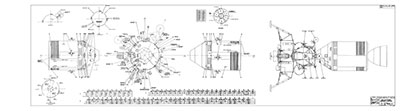

Andy Anderson Member Posts: 87 From: Perth, Australia Registered: Dec 2009
posted 08-13-2019 09:31 PM
From the Command/Service Module Systems Handbook, here is a scan of CSM-LM External Component Locations, Figure 11.2. I believe item #77 - Air Vent, might be the component you are referring to. |
