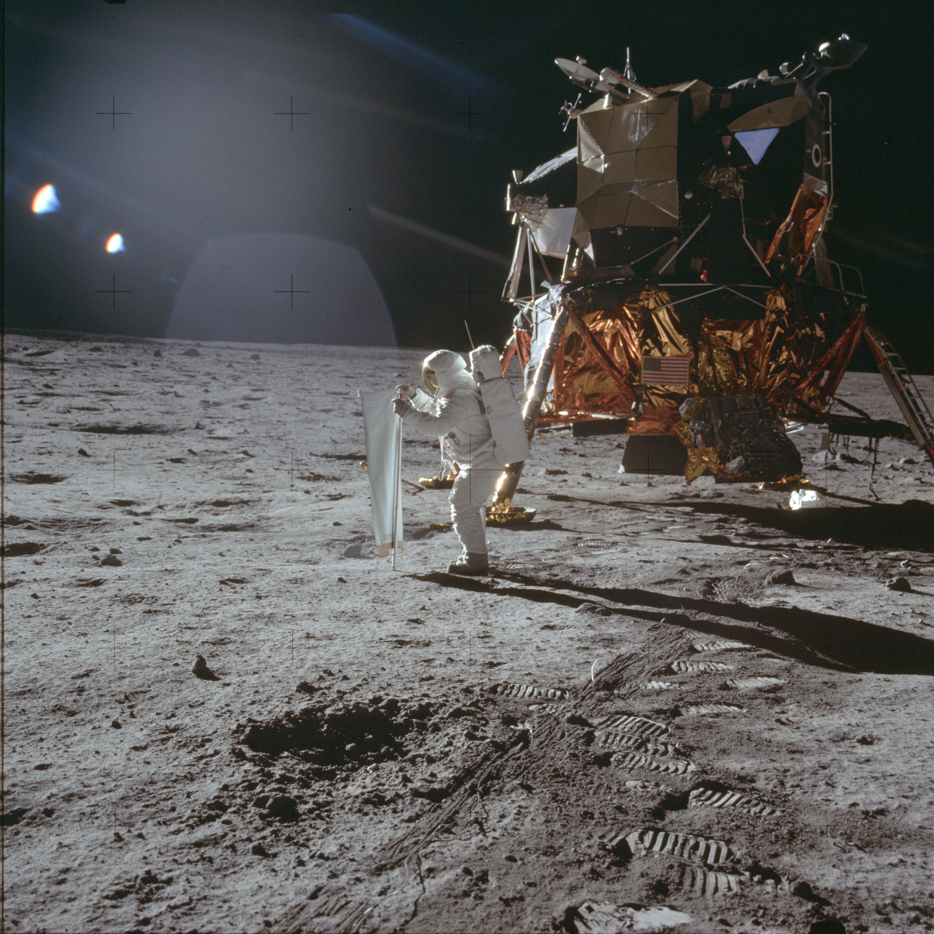

A 16mm camera mounted in the lunar module pilot's window filmed Neil Armstrong and Buzz Aldrin on the lunar surface.Why isn't that camera seen in photo AS11-40-5872?  |
oly Member Posts: 971 From: Perth, Western Australia Registered: Apr 2015
posted 12-22-2018 01:13 AM
A combination of the laws of light with regards to reflection and refraction. The lighting conditions whereby the inside of the LM is darker that the outside environment, the LM window coating material, and the dynamic range available from a scanned JPG file, prevent such details being visible, with the LM window acting as a mirror.This photo details how the lunar surface is being reflected by the LM windows, while this photo taken from a slightly different angle shows limited detail through the window, of objects close to the window, being illuminated by light reflected from the lunar surface. While it is sometimes possible to recover some detail within images using modern photo processing software, JPG files do not record enough dynamic range. There are some Apollo images that were slightly over exposed, that do allow details to be recovered. For anyone interested and wanting to try, this image, works well. |

The same effect can also be seen in the LM windows on later lunar landings. The blue windows always looked somewhat unusual to me.Or, maybe the "blue" windows are just reflecting the "Sea" of Tranquility.  Photo AS11-36-5389 taken during the translunar coast is a good view of the 16mm camera mounted in the LM window. |

In the case of the above Apollo 11 image, the LM Pilot window shade was not installed. The 16mm camera recorded Armstrong's climb down the ladder, the flag planting, and Aldrin trying different mobility methods along with other activities through this window. |
