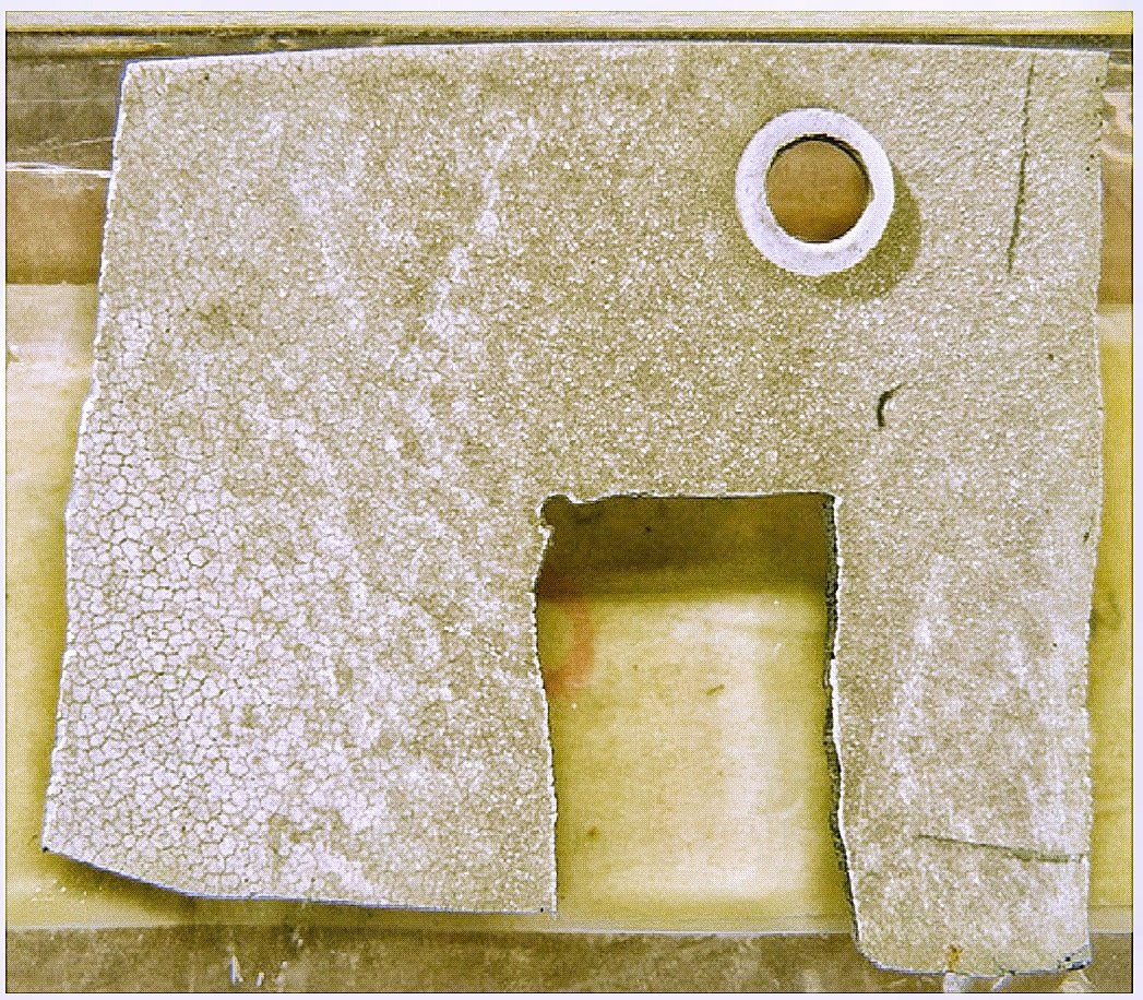

Interesting Twitter thread here by planetary scientist Phil Metzger about Al Bean and the regolith discolouration at Surveyor 3.

Alan Bean's mission gave us an absolutely unique chance to really measure this blowing dust. After landing, Pete and Alan walked over to the S3 spacecraft and cut off pieces that had been subjected to the intense sandblasting of their LM landing just 160 m away. As Alan rounded the large "Surveyor Crater" and approached the S3 spacecraft he said to mission control via radio, "I thought you said this spacecraft is supposed to be white." (Not exact quote - I'm going from memory here.) Mission Control asked "Why? What color is it?"
Alan said "It's brown!" This set off a lot of discussion back here on Earth. What did the lunar environment do to that spacecraft to change it from white to brown??? The leading theory was that radiation changed the chemistry of the paint. That theory held for 40 years.
Around me 2008 I traveled to Houston and officially checked out all the white painted pieces that had been cut off the S3 spacecraft and returned to Earth by Apollo 12. I had to keep them in a special safe with lots of security since they are truly priceless national treasures. We analyzed those pieces using many modern methods that were not available 40 years earlier, right after the Apollo program, when earlier researchers had tried to study them. We used Scanning Electron Microscopes, laser scanners, X-ray photoionization spectroscopy, and electron dispersive spectroscopy. We discovered the paint's surface was penetrated by sand-sized (100 micron) lunar soil particles travelling about 400 m/s. Each one made a pinhole in the paint, and we could see the soil particle lying in the bottom of each tiny hole.
This was cut off off Surveyor 3 by Alan Bean and Pete Conrad. It is aluminum with white paint. You can see a bolt hole where a washer covered and protected the paint so it is still white.
Now there are some SUPER interesting things we discovered in this, and it drove is to call Alan Bean by phone 40 years after his mission to discuss what it all means. For one, consider that semi-circular shadow next to the bolt hole. That is the shadow of the head of the bolt that used to be in that hole. The funny thing is that the bolt is now gone but its shadow is still there. Is it a ghost shadow? No. It is a sandblasted shadow formed by the intense spray of dust when Alan and Pete landed 160 m away.
Everwhere that got sandblasted got turned lighter in color. Everywhere that was protected by shadowing stayed darker. That's the brown color Alan reported seeing on the Moon. Earlier researchers triangulated these shadows and proved that they point back to the Apollo LM.
What my team did in 2010 is prove that the brown color was not really the result of radiation as prior researchers believed. Instead, we proved the shadows are actually MADE out of lunar dust. All the brown color is lunar dust that was already on S3 before the Apollo 12 arrived. The sandblasting spray of lunar dust from the Apollo landing actually removed more dust from S3 than it put onto S3. That discovery was shocking. We analyzed the chemistry of that dust and we discovered it had different minerals on the east versus west sides of the Surveyor.
