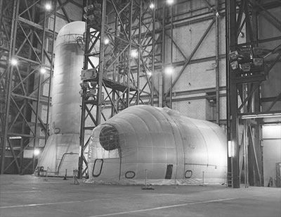

Photo KSC-71C-5533 is dated 15 November 1971 and shows two vehicles in storage inside the Vehicle Assembly Building. The S-IVB is identified as vehicle 208, which is probably correct. The S-IVB arrived at Kennedy Space Center on 4 November 1971. It was the S-IVB for Skylab 4. Any idea which CSM is in storage? The first Skylab CSM didn't arrive at the Manned Spacecraft Operations Building at KSC until mid-1972. Could it be CSM-111 perhaps? I believe that was the CSM for the cancelled Apollo 15 "H" mission. |

I don't see an CSM in the picture or reference on the page.The horizontal article is an SIVB. |

I thought they were referring to the vehicle on the left as S-IVB 208. |

I agree with Jim; There is no Apollo CSM pictured here. Both appear to be S-IVB stages with an added interstage adapter (seen on the left of this image). |

quote: Originally posted by LM-12: I thought they were referring to the vehicle on the left as S-IVB 208.
I would say there are two S-IVB's in the picture. |

Perhaps the other S-IVB is also for Skylab.Thanks for the replies. |

quote: Originally posted by Ken Havekotte: Both appear to be S-IVB stages with an added interstage adapter (seen on the left of this image).
Looking at the apparent shadows cast on the base of the shroud I'm not convinced there is an interstage adapter under the S-IVB. It looks more like a truss structure and a ladder.

quote: Originally posted by sev8n: Looking at the apparent shadows cast on the base of the shroud I'm not convinced there is an interstage adapter under the S-IVB.
It has to be because the S-IB did not use a tapered interstage. |
