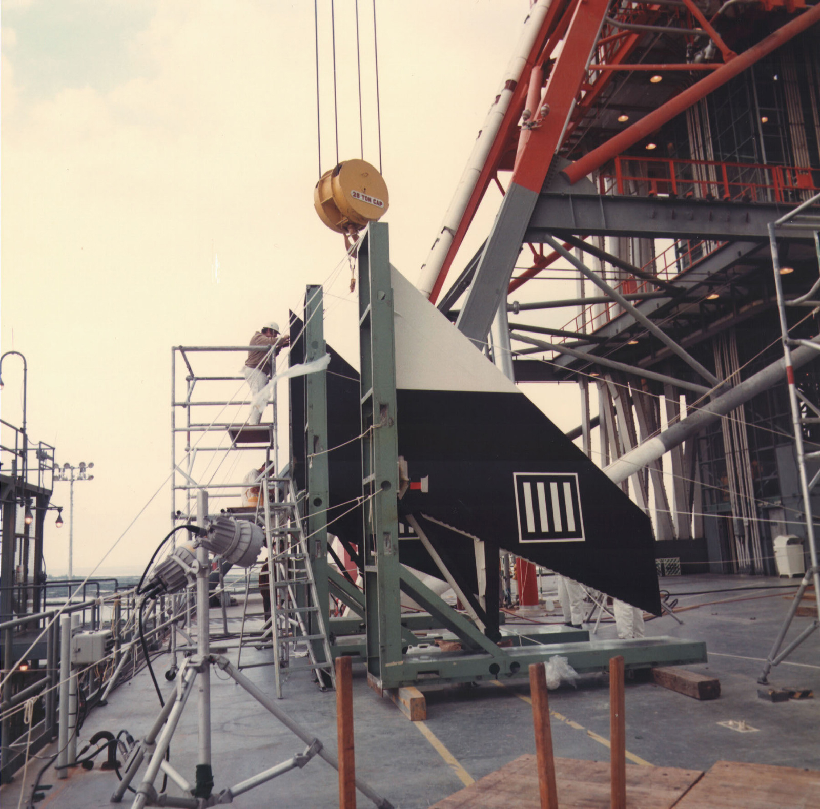

It looks like the LUT crane was used when the cracked fins were replaced on the Skylab 4 Saturn IB at pad 39B in November 1973.Perhaps the LUT crane on ML-1 was also used to build the milkstool. |

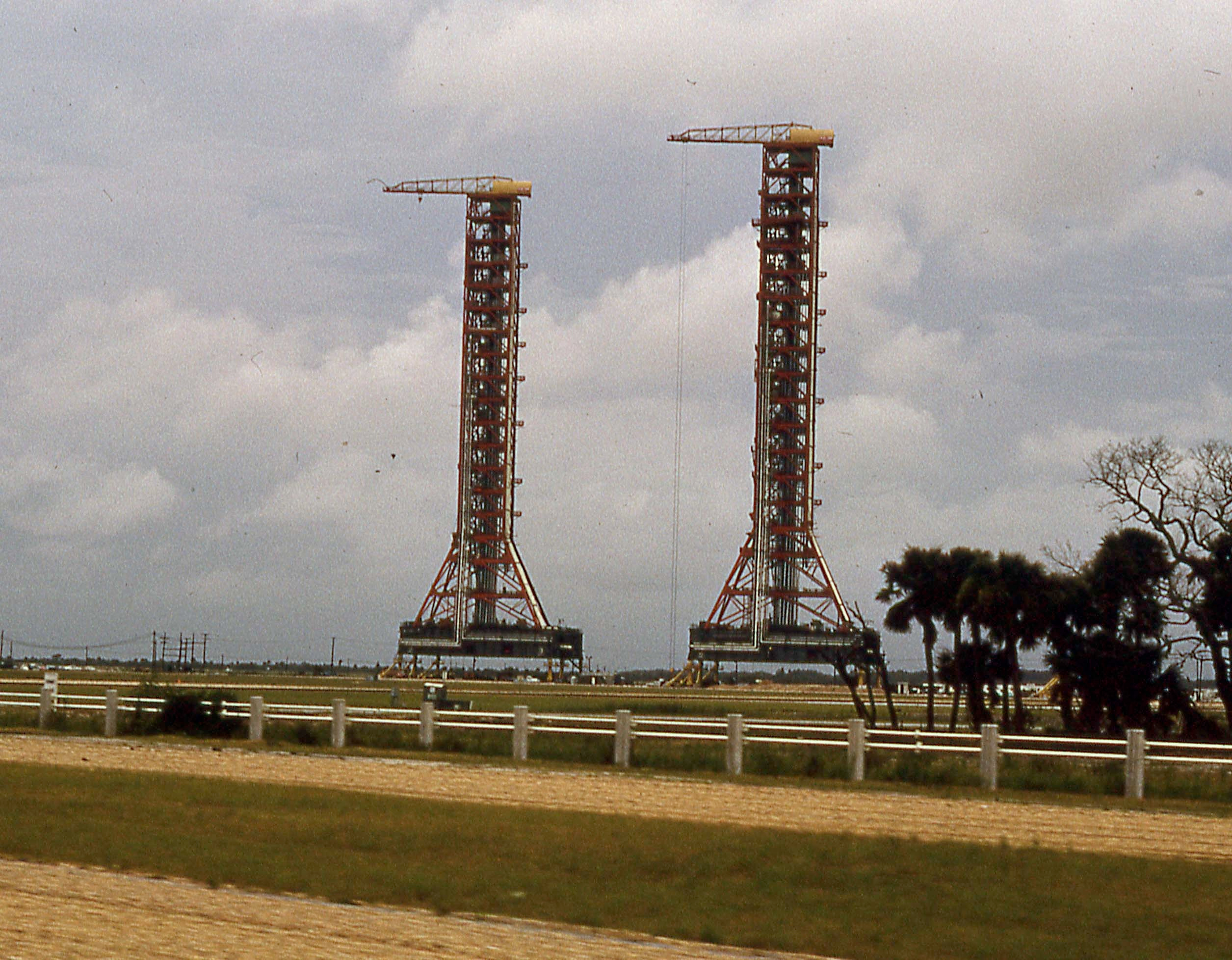

I finally stumbled upon an image showing the Apollo LUT hammerhead crane in use. Looks like it is lifting (or lowering) equipment from the ground to the platform(?). |

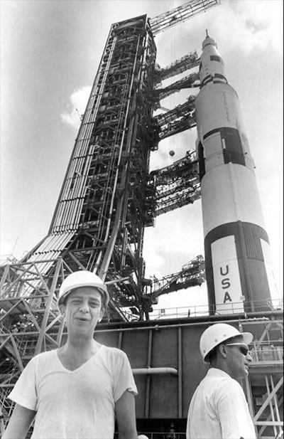

This 1966 photo of SA-500F at Pad 39A seems to show the LUT crane cables lowered to about the level of the S-IC intertank section. |

A photo seen here shows funnyman Don Knotts standing in front of the SA-500F vehicle at the pad. In the background, you can see that the LUT crane hook has been lowered about halfway down the tower.Knotts was filming a movie at KSC at the time.  |
Captain Apollo Member Posts: 329 From: UK Registered: Jun 2004
posted 08-02-2022 05:41 AM
That's Alan Shepard surely?(I know it isn't, but there was a considerable resemblance.) You can find the entire film here.

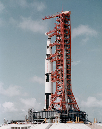

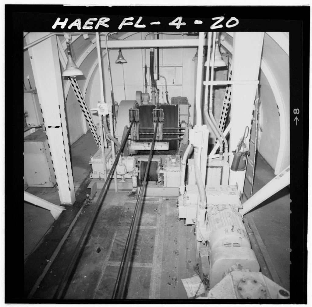

Here is a photo of the interior of the hammerhead crane machine room of ML-1 at the 380-foot level. |

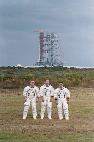

In the background of this Apollo 8 crew photo, the LUT crane at the pad is pointing north. It looks like the crane cables have been lowered to (or almost to) the ground. Any high-res versions of the photo out there?  |

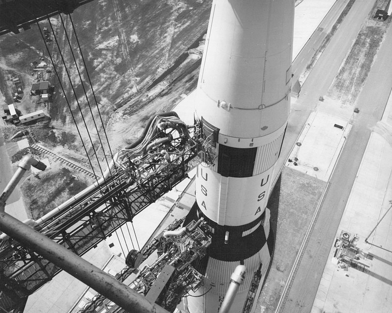

Another view of the LUT crane in use at Pad 39A. That is the SA-500F in 1966. |

And at Pad 39B: it certainly looks like the LUT crane was being used when the cracked fins were replaced on the Skylab 4 launch vehicle. |
