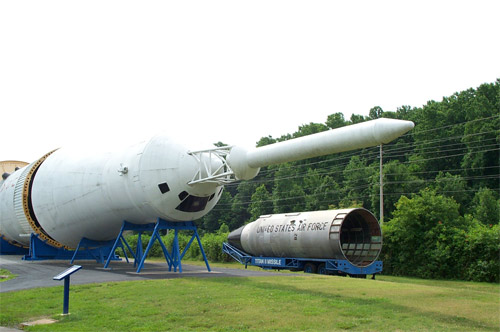

Does the LES from the infamous test have any distinguishing features? Any placards with serial numbers, or a different design to some part of it? A large dent in one side? (sarcasm) According to AFGAS, MSFC/USSRC have 1 real CM, 2 BP's and 3 LES to go along with them. CM-010 was on SA-500-D when she was outside, but apparently BP-23 was brought over from MSFC to possibly be included. If we can find some info about this historically intriguing LES, I'll be happy to scour the item on SA-500-D when I visit USSRC in early Feb. One interesting note on AFGAS is that BP-27, which currently resides on top of the Saturn I at USSRC, is listed as being used for "dynamic tests". According to the Saturn Vehicle History page, though, this Saturn is made up of dynamic test stages. So it's likely that BP-27 has always been with that test article. |

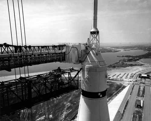

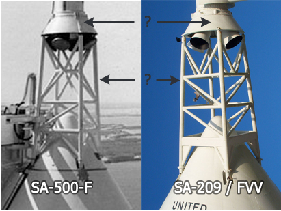

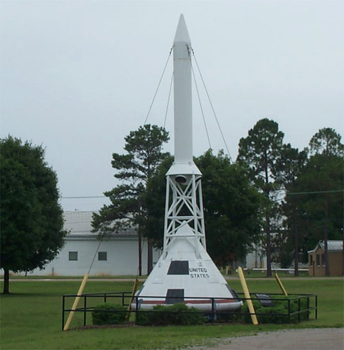

So, some digging around at The Apollo Archive and AFGAS produced an interesting development in this little mystery.I'm hosting reduced versions of the pictures, click on them to see the originals. Here's a picture of SA-500-F on the pad in 1966: (NASA via ApolloArchive.com) Look at the vertical and horizontal 'ridges' on the conical base just above the LES motor's nozzles. That was a hallmark of any production LES. Even though this was a weight dummy, the casing appears to be the same design as the production models. The LES that was on SA-500-D outside the USSRC was smooth: (AFGAS) BP-23, which was recently moved from MSFC for possible inclusion on SA-500-D, does have a real LES. Of course, this was no sand-filled dummy since it was used for abort tests at White Sands, NM in Dec 1964 and June 1965. No idea when it was moved to MSFC, and if it was part of the dynamic tests in 1966-67. Here's a picture courtesy of AFGAS: Then there's BP-27 atop the Saturn I. Unless someone can point me to the proper NASA documents, I think it's a safe assumption that BP-27 and its LES have been with MSFC. Since the only indication I could find of its use is "Dynamic tests", it's possible that it took a ride on the SA-500-D stack. Who knows? (non-rhetorical) So, I think it's safe to assume that Marshall didn't test SA-500-D with the infamous LES. According to AFGAS, the Facilities Verification Vehicle that sat atop SA-500-F is on the SA-209 Saturn IB display at KSC. But taking a look at the LES attached to this vehicle... (AFGAS) Hmm. Were the vertical details straps running from the end of the LES tower to attachment points on the conical structure? Furthermore, why does this LES have a radically different tower from SA-500-F or any other LES I could find? Fascinating. |
