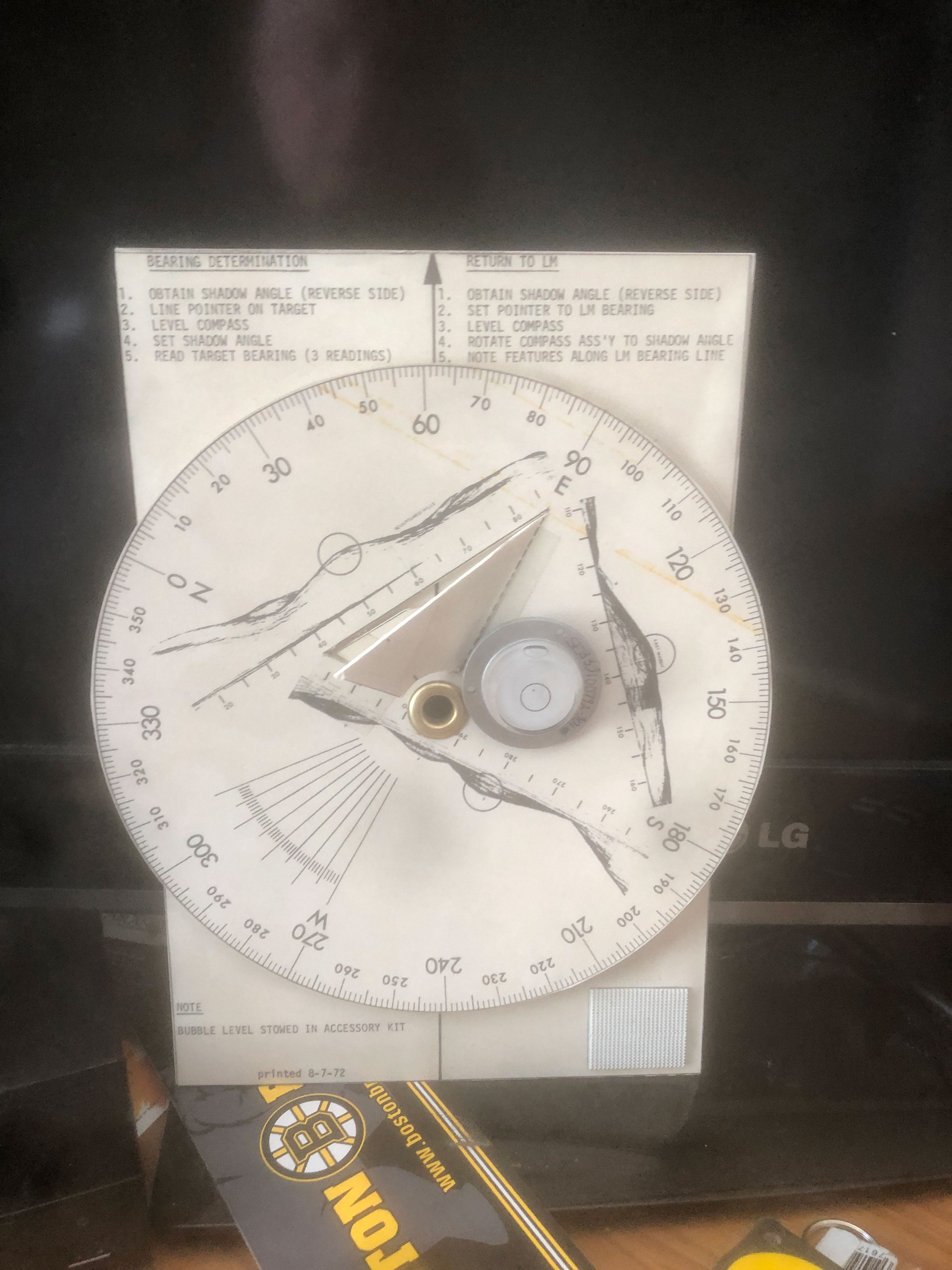

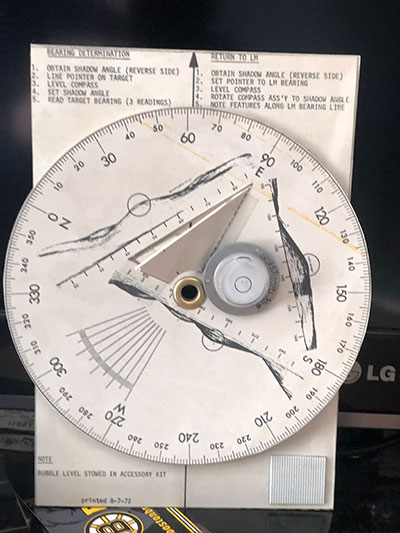

posted 01-11-2022 01:07 PM
On Apollo 17, did they not use a sun compass?
